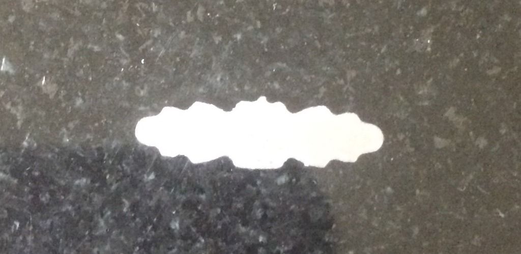

Ok this has been kicking my butt.
I cannot seem to get a nice finish in laying with USA knife makers templates.
I've tried about every bit they offer.. From 1/8" to 1/16" ( what they say to use) 3/32" shaft.
I dremel out everything I'm suppose to and yet the inlay still does not fit.
The only way I can get it to fit is by actually moving the template a hair right or left.
I shouldn't have to do that.
I'm thinking the template is fine but the inlay is off.
I've just about given up on there templates and inlays....
I'm doing it from the correct side...
Even did it the wrong way and still doesn't make a difference.
There has got to be another supplier...
That would have them...
Or is everyone using USA Knifemaker for these?
does the inlay piece fit into the template well ? if you have to move the template it makes me think the template is too small for the inlay.
Yes but pretty tight...
They just got the template in a few weeks ago but I'm sure the sent me ion stock on the inlay material... I'm sure it's off.
That's why I'm looking for a new supplier.
I'm sure it's not me... It's not that hard provided I have two pieces matching.
Or, cut the pocket with the template, then cut a bit off of the inlay material to fit. You could put it on a squared up work rest, or even with a couple degrees taper, and just bump it a bit with a fine grit belt.
Jason has it- just taper it to go into the cavity. Way better to have it a bit tight than too
loose.
Ken.
Well I probably picked the worst one to start on...
But if you look closely at the picture you can see all the irregularities in the piece.
Check with Mark VanderWest of Leading Edge Fab for more consistent templates and shields.

Taximanny, the template you showed is indeed very rough, and also a very difficult shape if you are beginning inlaying shields :eek:
