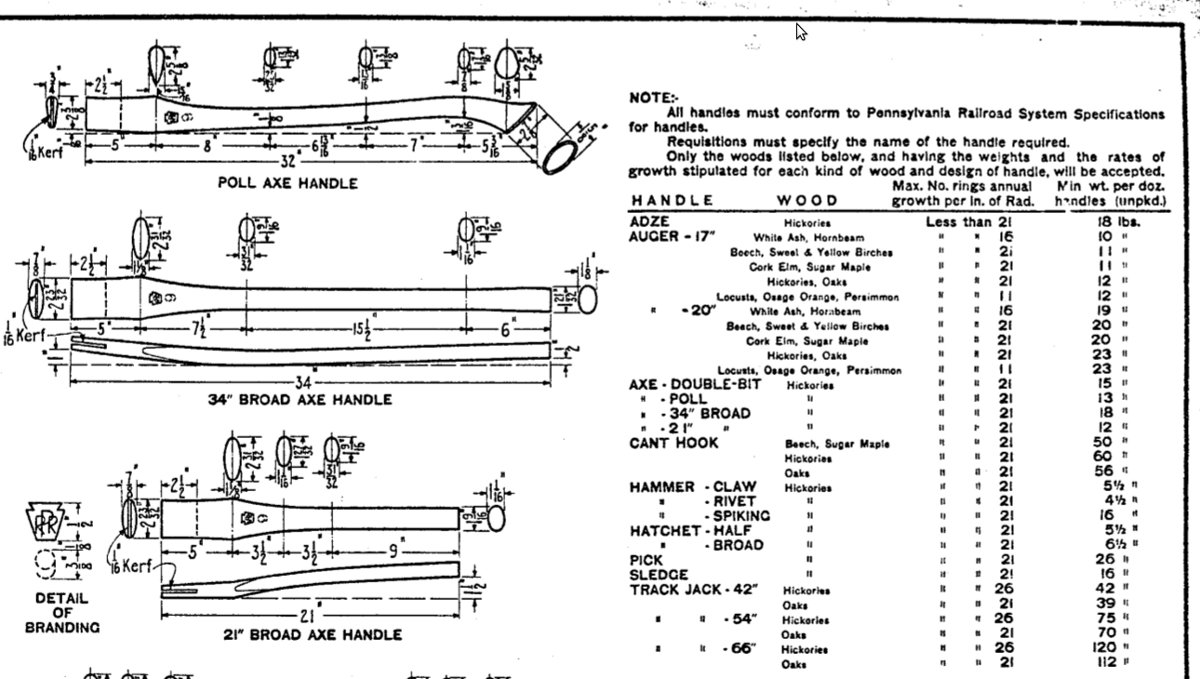

D. Cook also asserts that professionals didn't use curved handles. Hogwash! Industry drove the axe market and industry demanded the most efficient tool - the curved handle. As an example here are the axe handle specs for the Pennsylvania Railroad.

Useful and informative posts for a change. Penn Railroad purchase order clerks would be no wiser about anything useful other than what they'd been told to get/look for. And workers don't want to hear they've been entirely outfitted with 'least expensive/lowest bidder' goods. Slightly more expensive curvy axe handles vs straight definitely qualifies in this regard. What were National/State Fair axe competitors using for handles at the time?
I worked for gov't of Ontario (Dept of Lands & Forests) 45 years ago and they (we; workers) quickly discovered that lowest-bidder canoe paddles (crudely-made pine instead of crafted cherry/ash) were not at all durable or cost-saving over the long run.
