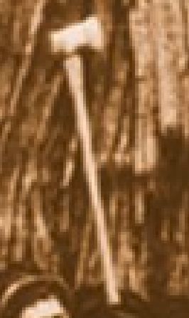

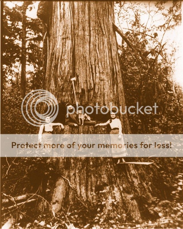

Just went through 98 old logging photos I've saved from the internet looking for axe handles. Found this one that appears to be a straight handle single bit:
I don't know how many of the pictures had axes in them, but of those that did, 90+% were double bits. Was this a coincidence or was the double the axe of choice back in the day? If a double was preferred, any thoughts on why a straight handle double would be prefered over a curved handle single?
That looks like it could be a double bit, with one bit sunk into the tree. It's not very clear, but the neck of the haft looks to be equally flared on both sides like that of a double.
I would agree with this assessment.
You guys are sharp, I didn't connect the dots concerning the neck of the haft. It's funny, but when I look at that picture it still looks like a poll on the left side. On the other hand the bit on the right dosen't look like it's sunk into the tree. To me it looks like the axe is just hanging in mid air. It makes sense that the left bit is in the tree and the photo is just not clear enough to tell. Or, or . . . it's a single bit and the old boy is demonstrating the famous floating axe trick to impress the ladies.
Hold on I just opened another window and googled "lumberjack floating axe". It seems that in the early 1900's a man named Sol Bunion traveled the lumber camps making a nice living making wagers with the loggers using this trick. And get this, he was accompanied by a small talking dog!
