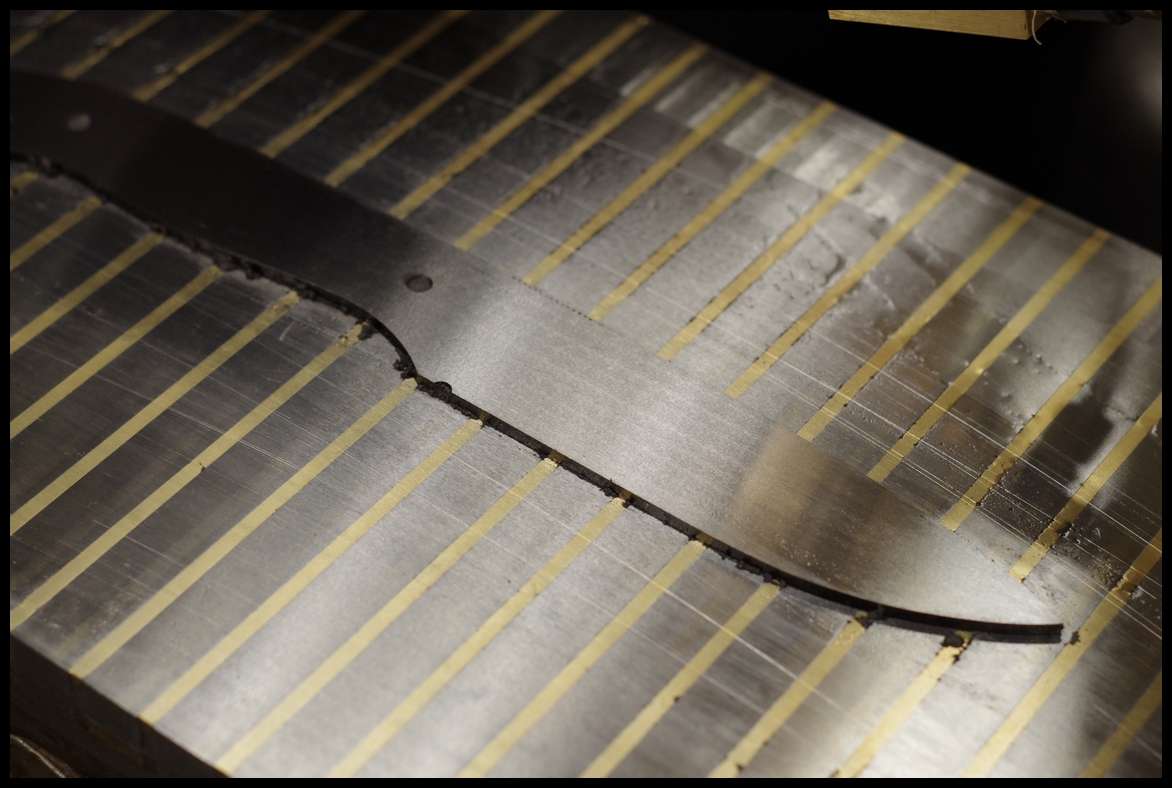

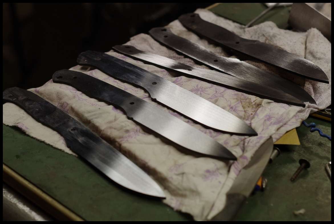

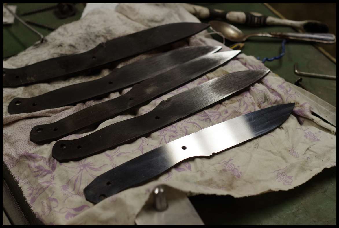

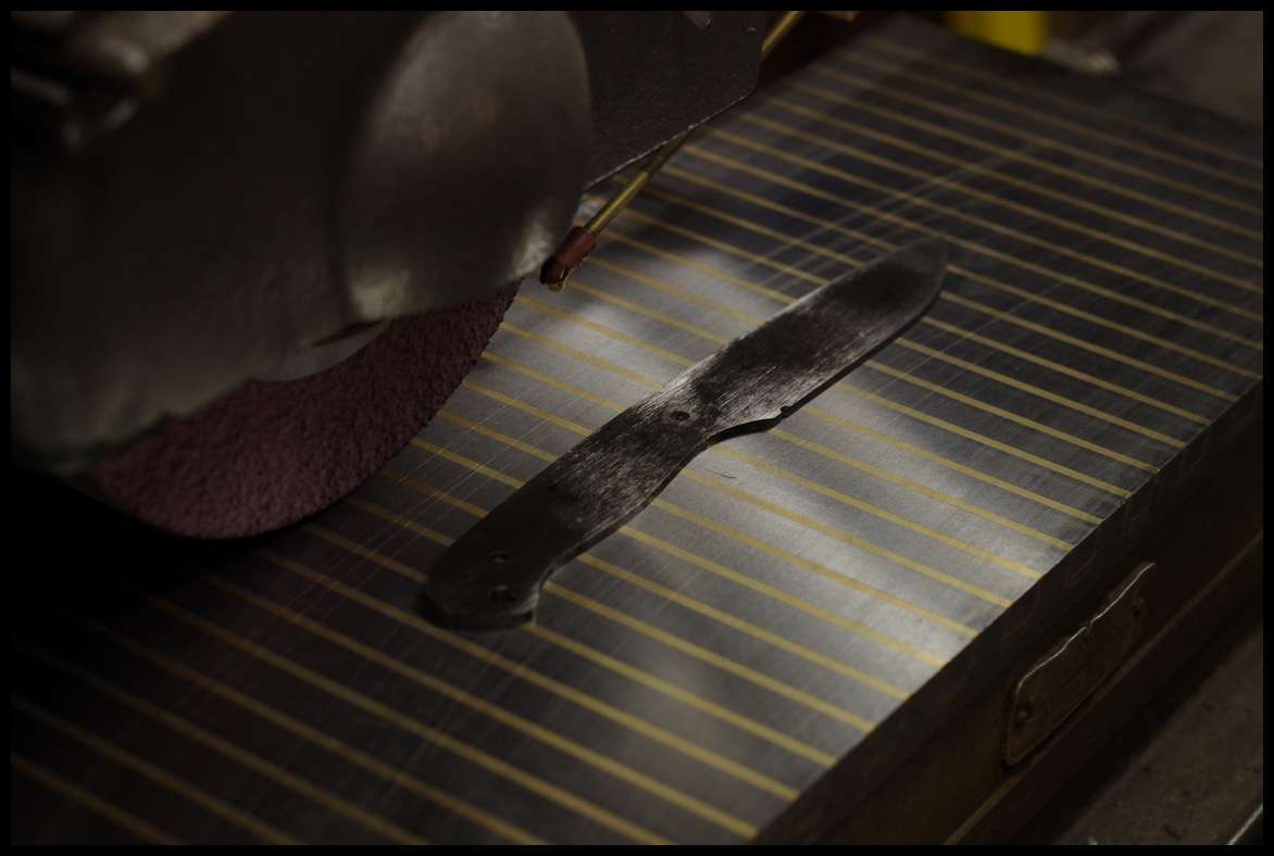

Finally got better wheels (made for order)
From mix of AOx ( mostly AOx with Cr ) 60I .
Work a lot better:
DOC: 1pass - 0,02mm , 2pass - 0,01 - sparkout
Working good when I use a lot of coolant in Fogless mister, but a lot less than in flood cooling.
Time to make coolant tank from 11kg propane-butane tank.
And get second nozzle from opposite side of wheel.
I Dream about manual feed 500x200mm surface grinder ;_; (stones for manual, CBN wheel for hydraulic)
