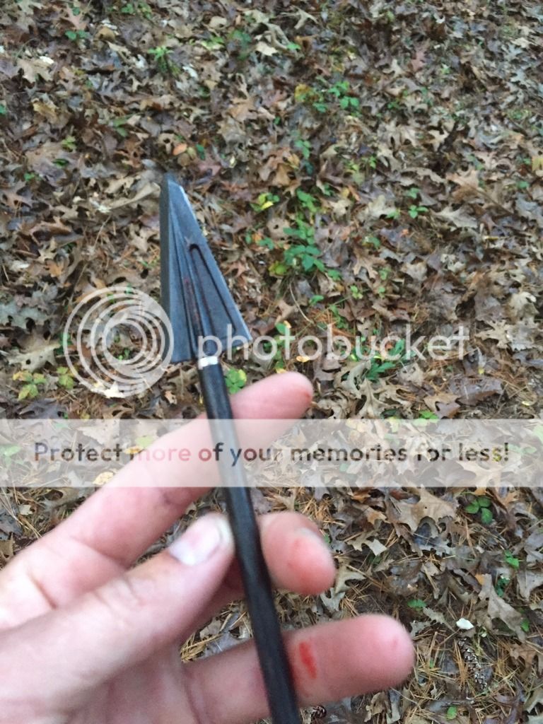

Will take picture right right now and then upload later.
Here they are. Taking the pics and typing took longer than building this and it looks like that too. :-P Still, it works.
One rubber piece covers the tip and the other one goes over a limb. The string is double but knotted together in small intervals in the middle section only to prevent entanglement. The ends are left open, forming the loops.
I believe the rubber was some pipe seal I had lying around but anything flat and rubbery should work. Old plunger for example or leather.
The string I recall was something from Harbor Freight with a high pound rating. But anything less might work too, especially since its double and the force at the limb and where you are standing on is distributed over some area.
