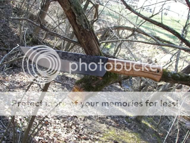

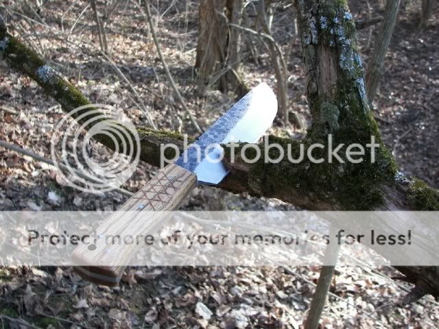

I spent the evening testing out one of my new knives by putting it through some basic fire making. Thanks for looking!

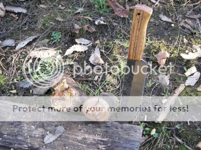

Clearing a pesky branch out of the path. It was about 1 1/2" around. Now it's firewood.

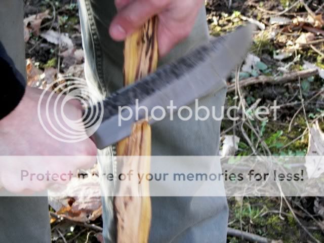

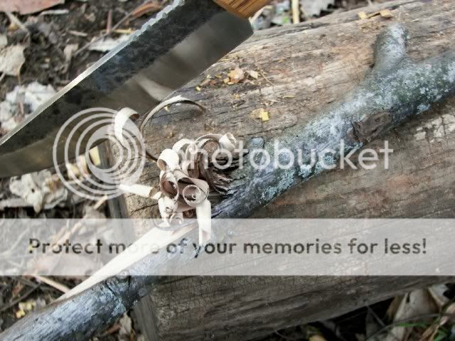

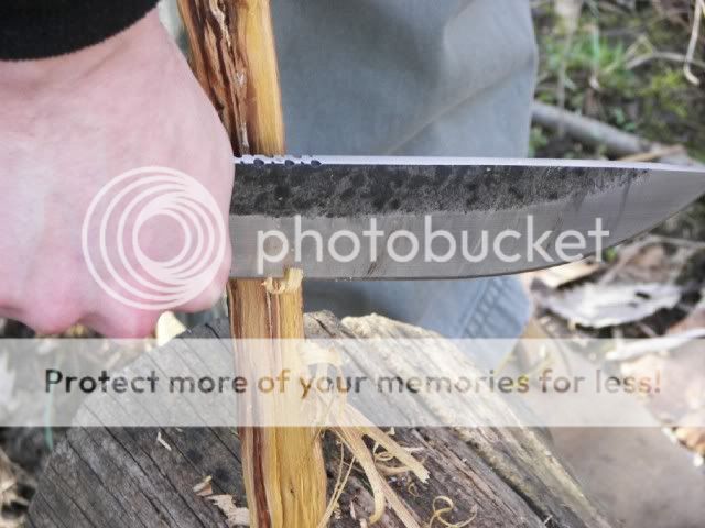

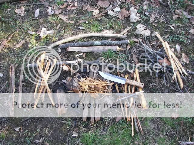

The key to a good fire, proper prep.

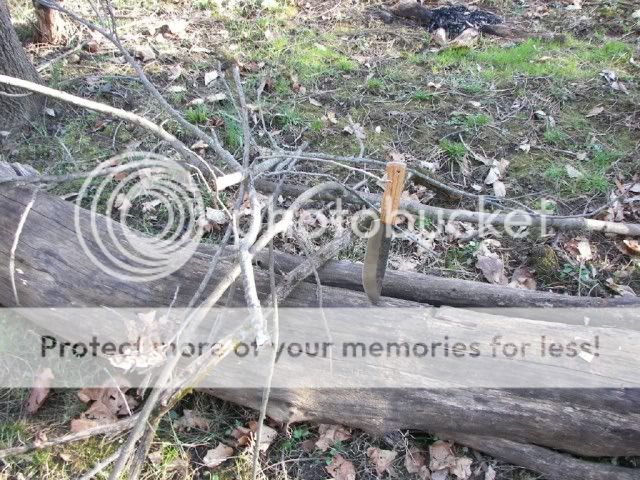

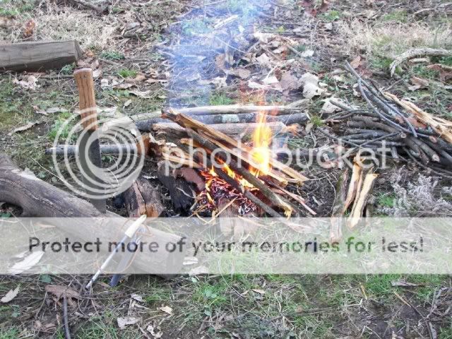

Success!:D
Thanks for posting this. :)
What's the blade thickness, by the way? Do you distal taper your knives at all?

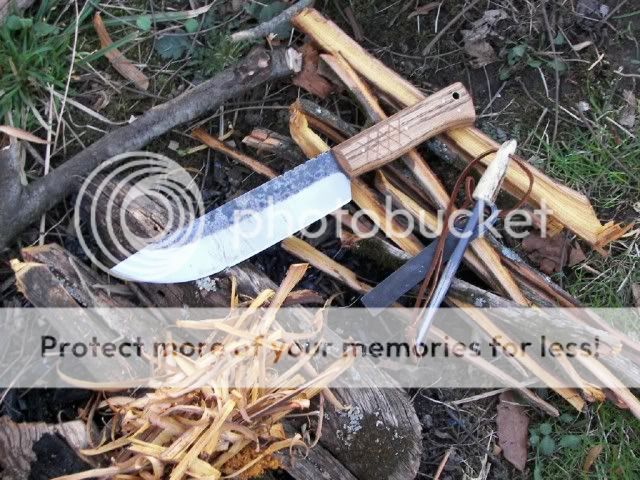

Great looking knife! And a beast of a firesteel you got there!
Yep, it's a big one. 6" x 3/8"

No, I don't taper my larger blades at all so they keep a little more mass at the end for chopping. I do taper my smaller knives a little though. This one is 3/16" thick.

Good looking blade. :thumbup:
That firesteel is the same size as the one I have, but it looks so much bigger for some reason.
That is a sweet big blade. Sort of off topic, bug how do you do that cross hatching? It looks great, and functional.
It's actually quite simple.
I start by taking a ruler and a pencil to lat out the cuts. Then I use the edge of a triangle file to cut along the lines, finish by sanding over the cuts with some 400 grit sand paper and it's done.
