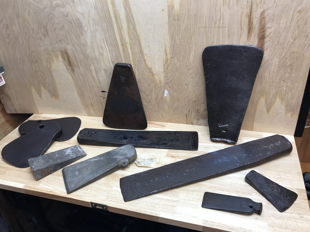

I’ve seen discussion on splitting wedges but no dedicated thread on felling and bucking wedges. Does anyone get into vintage wedges? These are some of my favorites!
The little 1lb bolt pattern wedge is a Hubbard and the other small one is an Occident from Seattle Hardware.
The two grey ones in front are magnesium not aluminum. They were only produced during a relatively short period between 1935-55. They are super light for their size. They seem even lighter than aluminum.the larger of these two is almost 10” long and barely over a pound.
The two likely blacksmith made wedges would probably be attached to each other with a rope so they could be packed easier and slung over something like your shoulder. They are about 6lb each
The big wide ones, are these for bucking and not felling or are they just giant and wide?
The massive Titan 10lb wedge is 13” x 7”, and the 7lb Skookum is 10” x 7”.
And the enormous felling wedges are a 8lb Acme that is in amazing condition with original paint and a barely hammered on poll is 17.5” long, and the mammoth sized felling wedge is unmarked but it is 21” long and about 13.5 pounds.
(Funny that last picture makes the 8lb Acme look longer than the 21” one, but it is not, it is 4” shorter and diminutive in stature compared to the 13.5lb wedge.)
I’d like to learn more about these. The timeline that they went from steel, to magnesium, to aluminum, and finally plastic. I’d also like to discover what brand used the circle with an “I” in it?

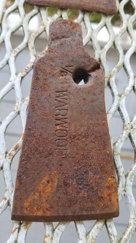

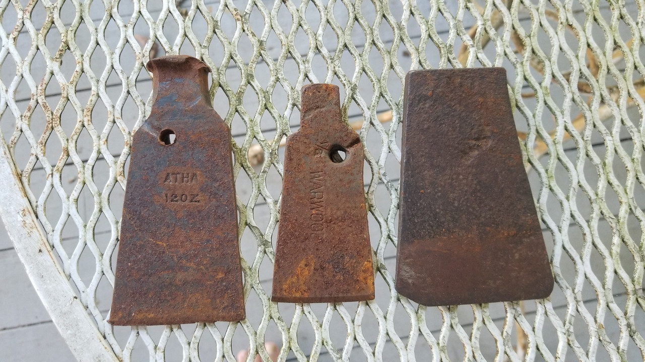

I have found these three in the past two years.

A lot of those with the holes in the side, are hanging wedges. Used in pairs tied together, with the grain, across a kerf while bucking, to keep things from rolling too soon.
The cord between can be hooked on a limb, or an axe chop on the solid side, to keep ahold them once knocked out to turn things loose.
