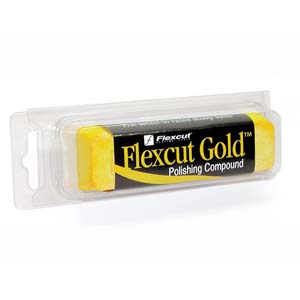

This is what mine looked like when new.
The yellow is not appropriate more from a handling standpoint. Picked it up at Home Depot a year or two ago.
My favorite commercial compounds are Dico for their black emery, Flexcut for their yellow (white), and Formax for their green CrO. I could break down some of the CrO as well, is a very fine particle in a very tight distribution size. Have read some folks on a straight razor forum discussing how it is a much larger particle size, but I have no idea where that's coming from. Have taken a look at my block before and its mighty consistent - particle sizes are smaller than the Ryobi white and a touch more consistent - hard to imagine it getting much better. The pic says 20oz, the normal size is a bit smaller....
