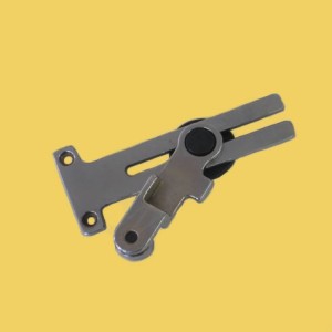

Thank you Dave. Funny story about that... so usually I'd use my trusty stitch groover to mark my stitch line before I sew it on the Cobra. I find it's an easy way to get the stitching exactly as you want. Easy with veg tan but gets pretty tricky with exotics because of the surface hardness, relief, texture, etc. So, I decided to try my guide roller on this for the first time. Worked out great! Will definitely be utilizing it in similar situations in the future!
That stitch guide is great. I use it on each and every sheath. Welcome to the world of advanced technology!!!

The only problem that tends to pop up with that style stitch guide is on thin leathers (like stitching linings). Cobra has a newer version available if your machine is fairly recent it will already have holes drilled for it up in the neck. This version you can leave mounted all the time because it has springs to keep it up in the neck when not in use, and will drop all the way to the plate so nothing can get under it when locked in the down position. I've been considering modifying my older Class 4 to work with it because of how much I like that feature.
