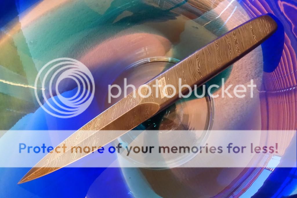

The knife is complete and should be on it's way to Paul Long for a nice sheath within a day or so. I asked Tim(who provided excellent communication and photos as the process unfolded) if he would like me to post up a WIP on BFC, and he replied to the positive, so here it is, a completely unplanned WIP....Tim wanted me to advise you all that these are crappy phone shots and not something that he had planned for.
Steel stacked and ready for welding, I believe it is 01 and L6
Welded to handle, first heat
Some flux on there
Still forging ahead!
Billet forged out
Three blades forged to shape
Blades being cycled in liquid nitrogen
Tim is currently quite(justifiably so) famous for his straight razors, which command a premium price. This is a family shot.
Attempting to cold forge the bronze did not provide good results, it work hardened, Tim had to anneal, bang, anneal, bang.....
The three blades approaching finish ground, and the bronze bar on bottom forged out flat.
Quick etch to show pattern, Tim gave me a choice of blades, when I think back to Tim's work over the years, the choice was easy, the tight twist blade in the middle.

The completed knife.
