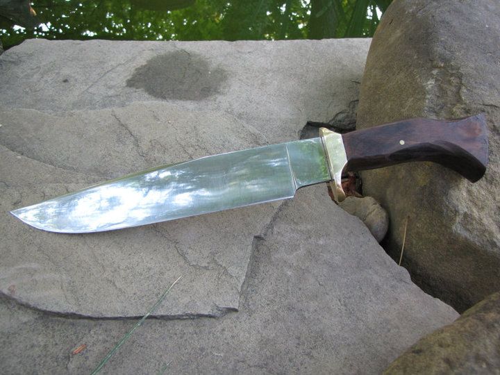

Lignum Vitae - Ironwood - or my favorite - Greenheart - Nice tight grain, non oily, extremely rot resistant and exceptionally durable. Used for, among other things, building shipways. An excellent knife handle choice. Finishes closely to the color of teak.
Shown here on a very nice JK Rule #9
