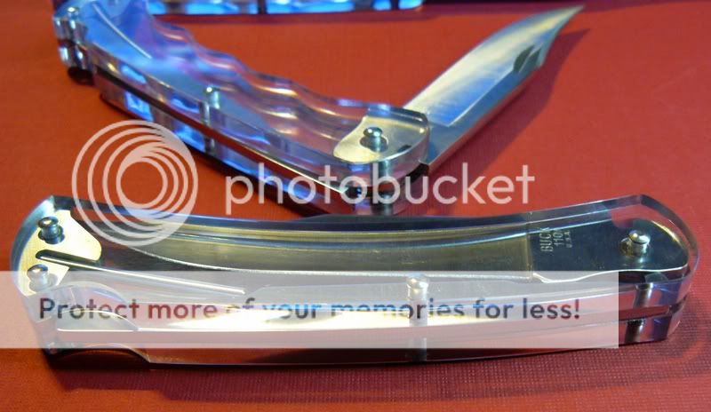

Transparent or clear folding knife handles: Yea or nea?
They look great. But if polycarbonate, they'll scratch up very easily. What would make them impractical isn't that they'll scratch easily, but that polycarbonate is too brittle a material to make for a durable folding knife handle. Cracks will form around the pinned areas. At that point, there's really nothing to be done, since these are structural. As far as transparent plastics go PC is pretty durable stuff. But it pales in comparison to brass, wood, or steel.
Of course y'all know that Poly-Carbonate is just a fancy word for plastic? The material in question is almost certainly Lexan, if it is 'bullet proof'. Indeed, you can take a sledge hammer to a sheet of Lexan and not break it, but it is not very hard and scratches easily, which is why when employed for security purposes, it is usually sandwitched between regular glass to protect it.
I can't predict the future looks of this material because I have no experience with it. Has anyone handled/used bulletproof glass to the point that they can explain how it reacts to wear and tear? I sure don't know. Time may tell but you see these as useful, as I do, as show pieces at least. Keep em safe, keep them clean and put them on display.

Let me say that I think those things look absolutely awesome. They will get clouded though. Oils and sweat from your hands will contribute mostly to that. On the trucks, it's mostly from sunlight and other elements. But it stays see-through. It won't go anywhere near opaque. Might yellow a bit, or just look kind of cloudy like an old lens on a car's headlights gets. If you pocket carry 'em, you could get surface scratches from keys or whatever. We don't go to any great lengths to keep the glass pristine (beyond avoiding bullet marks whenever possible :p), but I'm pretty sure you could polish out any such surface scratches the same way you would clean up old headlight lenses.
I'd say pick one to carry and put the others away until you determine how well (or poorly as the case may be) the pieces hold up. To my way of thinking, they'd be of no use to me just sitting in a display case. If I can't use my tools, I have no interest in just looking at them. I'd use 'em even if I knew for sure that doing so would mar them up, but that's just me. Really cool pieces no matter what you decide to do with them. Very creative. Thanks for showin' them to us.

I'll tell ya what, the more pictures you post oregon, the more I hope you post more. I'm like hyp-no-tiiiized by those things! Now, I love looking at all the pictures around here of highly customized folders with the mastodon scales, high-dollar woods, anodized liners, engravings, scrimshaw and whatnot, but there's something about the simplicity of your creations that has made me come back and just stare at those pictures a bunch of times since I first saw 'em. There's something goin' on with the refractive qualities of the material where even when they're sittin' on a reddish cloth(?) in these two pics (and others too), there's like a prism effect with fairly bright blues and greens showing inside the material:
I realize there's probably some blue/green light source nearby, but like I said, the refractive qualities are really quite stunning.
