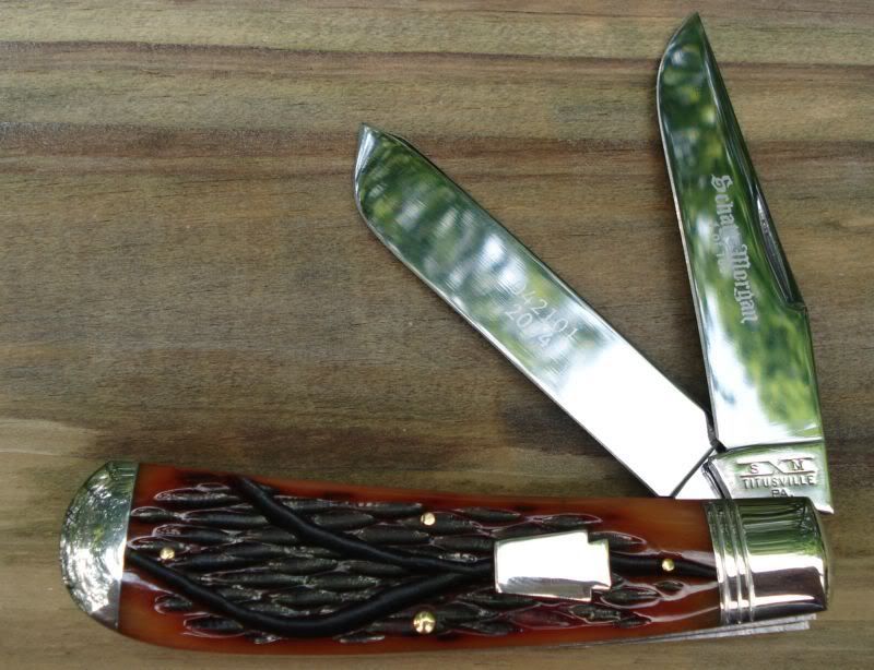

I can't comment on GEC because I don't own any, but I do own a S&M Swayback Trapper and IMO it's probably one of the best made production knives I own.
I only have a few negative comments.... I'm not a big fan of blade graphics and S&M almost always has them. Also the blades were not extremely sharp, but the grind was consistent and after a few swipes on a ceramic rod sharpened right up.
Most S&M knives are SS while GEC uses a combination of both SS & carbon steel.
Here's a pic of my S&M
+1 on JDP's comments. I have the same knife, and feel the same way about it. Great knife, despite the graphics, and what some would feel is an "inferior" steel (I don't, but then I don't expect to use my pocket knife to 'baton' through a tree branch).
