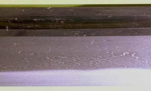

I really like this pict of the 14th century Katana.:)
Also they explained how many foldes it would take to get a Million layers..20 foldes. :eek:
Most newer Folded steel Katana blades are folded 5~10 times because the steel is so much better today. Chen Blades are folded 9 times on average from what I have read.
