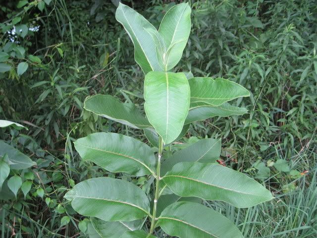

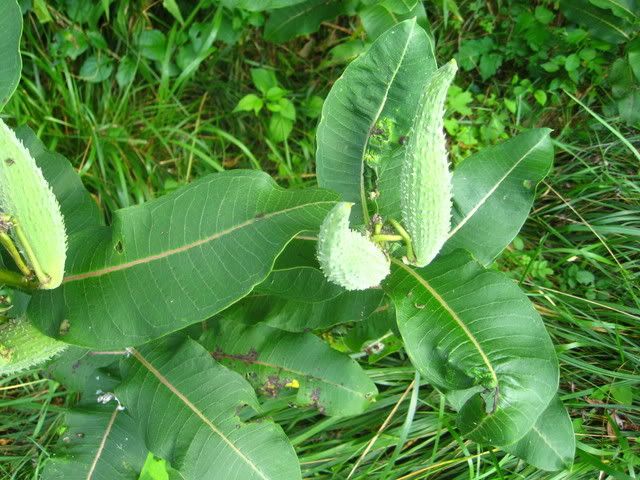

Common Milkweed Has a white milky sap when you break any part of the plant.
The young shoots, young leaves, flower buds and immature fruits are all edible, however it is important to make sure that they are thoroughly and completely cooked before eating them; otherwise they are still toxic. So I read. I also read not to use pods over an inch.
Sorry and plaese correct me if I am wrong!

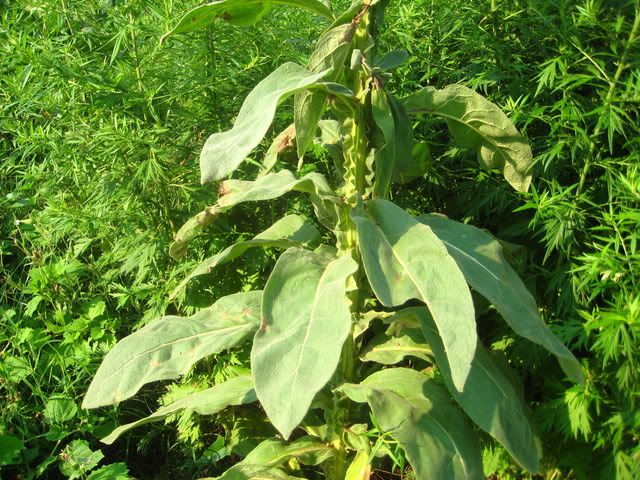

Common Mullen
(Verbascum thapsus) or toilette paper plant
The stalk can be used for a handdrill for firestarting and I believe it was also used as a cough suppressant and to relieve congestion.

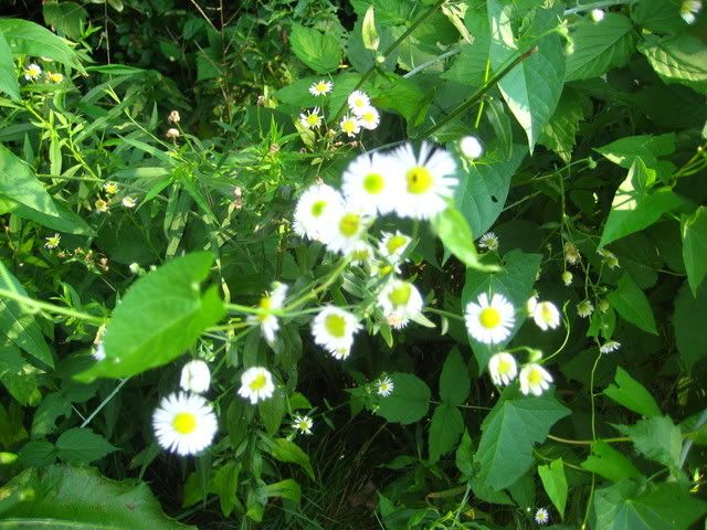

Ox-Eye Daisy
Leucanthemum vulgare
Native Americans used it as a light tea to reduce fever. If it is too strong it will induce vomoting
Hey Tony,
You've been busy! :D
This picture isn't too clear, but it looks like one of the Fleabanes (Erigeron spp.) not a Daisy (Chrysanthemum leucanthemum- I think your binomial is more correct, because I think it was changed, but what do you want from an old geezer :() Look at the rays on your picture - they are very narrow. Now compare them with this. Here's a link to one of the Fleabanes (Erigeron philadelphicus).
Also the leaves are different so you might want to compare them. Now I may be wrong, because you picture is a bit fuzzy, but you be the judge.
Doc
Sorry and plaese correct me if I am wrong! :o
Looks like Common Milkweed (Asclepias syriaca) to me. I've never eaten it so I have no first hand comments about the edibility. However, the green plant, later in the summer (even now) can be used as an expedient lashing material by stripping the outer skin and using it as is. It can also be 3-braided to make longer and stronger cordage. A buddy and I once used the 3-braided green Milkweed skin as a successful bow string for bow drill fire.
After the plant has died, you can process the fibres from the dead stalk to make strong cordage and fine thread (for sewing, etc.)
The pappus (fuzzy down) in the seed pods is an excellent tinder later in the year. It can be lit from the spark of a fuel-deficient lighter (Bic, etc.)
The milky sap can be used to remove warts. I have successfully used it as such.
A very useful plant. Good on you, Tony, for bringing it back to our attention. One day I'm going to try eating it.
Doc
Common Mullen
Another useful plant. The following is from some of my notes:
Mullein was brought to North America from Europe and was well established by the 1800's. (EJ239) Ancient cultures around the world considered Mullein a magical protector against witchcraft and evil spirits. (KV385) It's also a plant with many medicinal uses with, of course, an accompanying warning that the seeds are toxic and may cause poisoning. (KV387)
As far as utility applications go, this is a very useful plant. First stripped of its leaves, then dipped in suet, pitch, or resin and lighted, Mullein stalks served as the candles and torches of ancient kings and commoners alike. Until cotton came into common use, the down of the leaves served for tinder and lampwicks. (JW219)
An excellent pithy core, found in the stalk, was used as a charred tinder material. (KK36) The dried stalk was used as a hand drill for friction fire making. (TB7-147) The leaves could be used as a glove for picking Stinging Nettles (RM186), or as a potholder around the fire. (ASG9/00) Native Americans lined moccasins with the warm, wooly leaf (JM31), and probably a whole lot of campers, low on supplies, have turned to this, Nature's toilet paper.
Large amounts of the fresh, crushed leaves and seeds (which contain greater volumes of rotenone) were used as a fish stunner. (ASG9/00) This use as a fish stunner can be traced back more than 2000 years. (JW220)
The common name, Mullein, comes from the Latin mollis, meaning soft. (BN-39)
Another interesting common name for this plant is Quaker's Rouge. Quaker women, apparently, are forbidden to use cosmetics so sometimes, young Quaker women would rub the wooly leaves on their cheeks to cause them to redden. Mullein leaves are a rubefacient (an agent that reddens the skin by producing active or passive increases of blood to the skin). You might want to keep this in mind when using as a toilet paper substitute. :rolleyes:
And please forgive me for pasting my notes rather than retyping - it's hot and I'm lazy.:(
Any Tony, forgive me if I am truly being a PITA with my unsolicited comments. I just thought since you brought them up, it was a good time to add to them. :confused:
Doc

Looks like Common Milkweed (Asclepias syriaca) to me. A buddy and I once used the 3-braided green Milkweed skin as a successful bow string for bow drill fire.
Doc

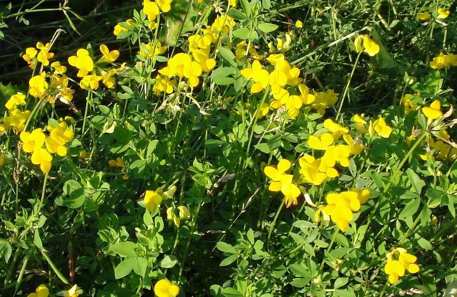

This is Birds-foot Trefoil (Lotus corniculatus). It's called Birdsfoot because the mature seed pods resemble a bird's foot. It is a highly nutritious and delicious (to cattle) forage plant that was introduced by chance from Europe, or at least according to Invasive Plants, Kaufman/Kaufman, Stackpole, 2007, ISBN# 978-0-8117-3365-6, page 332. I don't know of any technological, food, or medicinal use of the plant. I include it only because of its striking yellow colour and it ubiquitousness.
