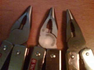

The latest versions of the full size Swisstools have the same style pliers as the Spirit only bigger
The old style Swisstool is in the middle , Spirit on the right .Notice how the hinge on the older one is the other way round .
I have a Spirit as well as three Swisstools two of which have the newer pliers and the spirit has smaller pliers and a little flex in the handles so i would say imho that the larger swisstool (newer version ) is stronger .Ive yet to here of any one who has broken the pliers on one and would be very interested to here about it .
