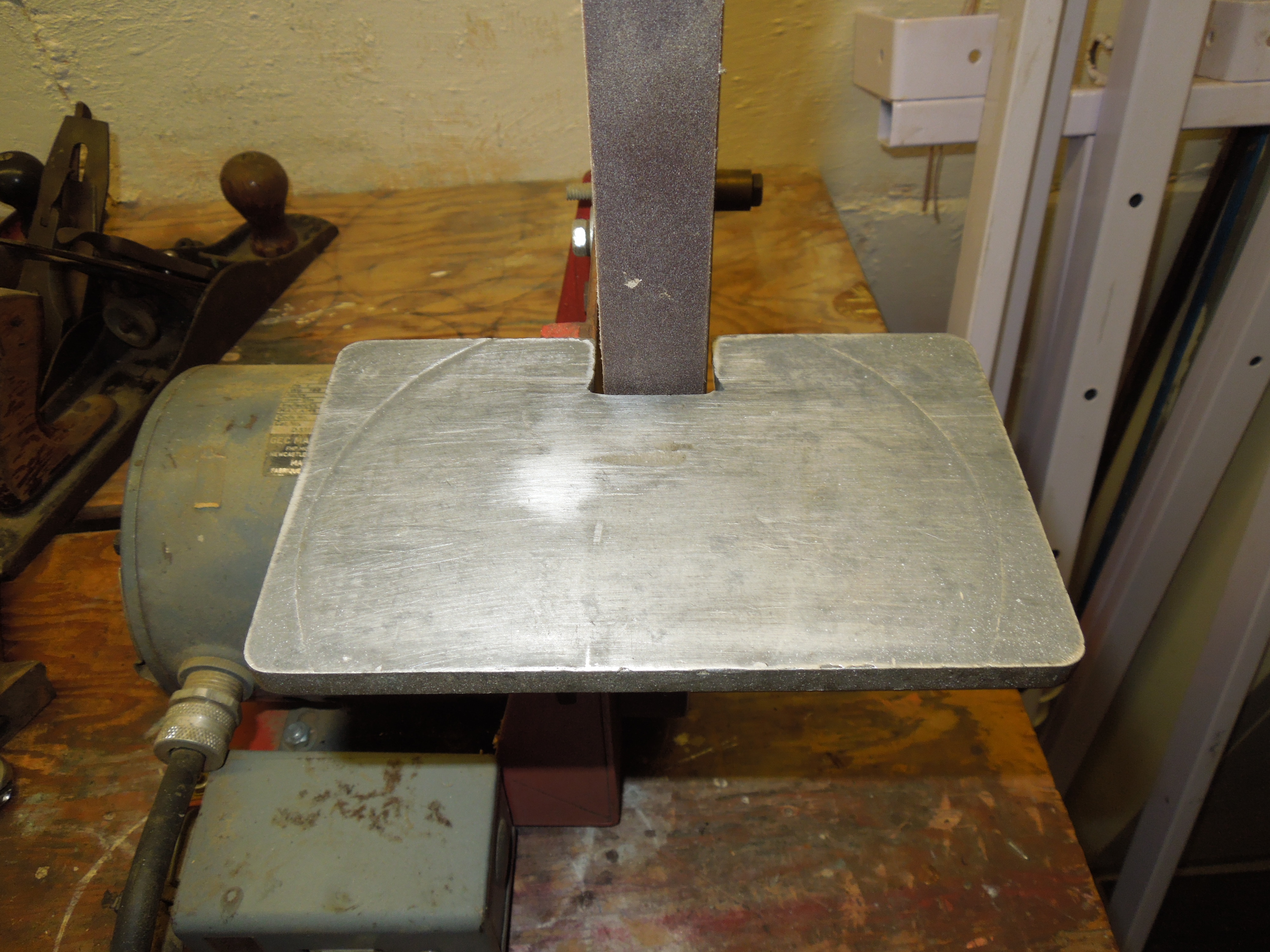

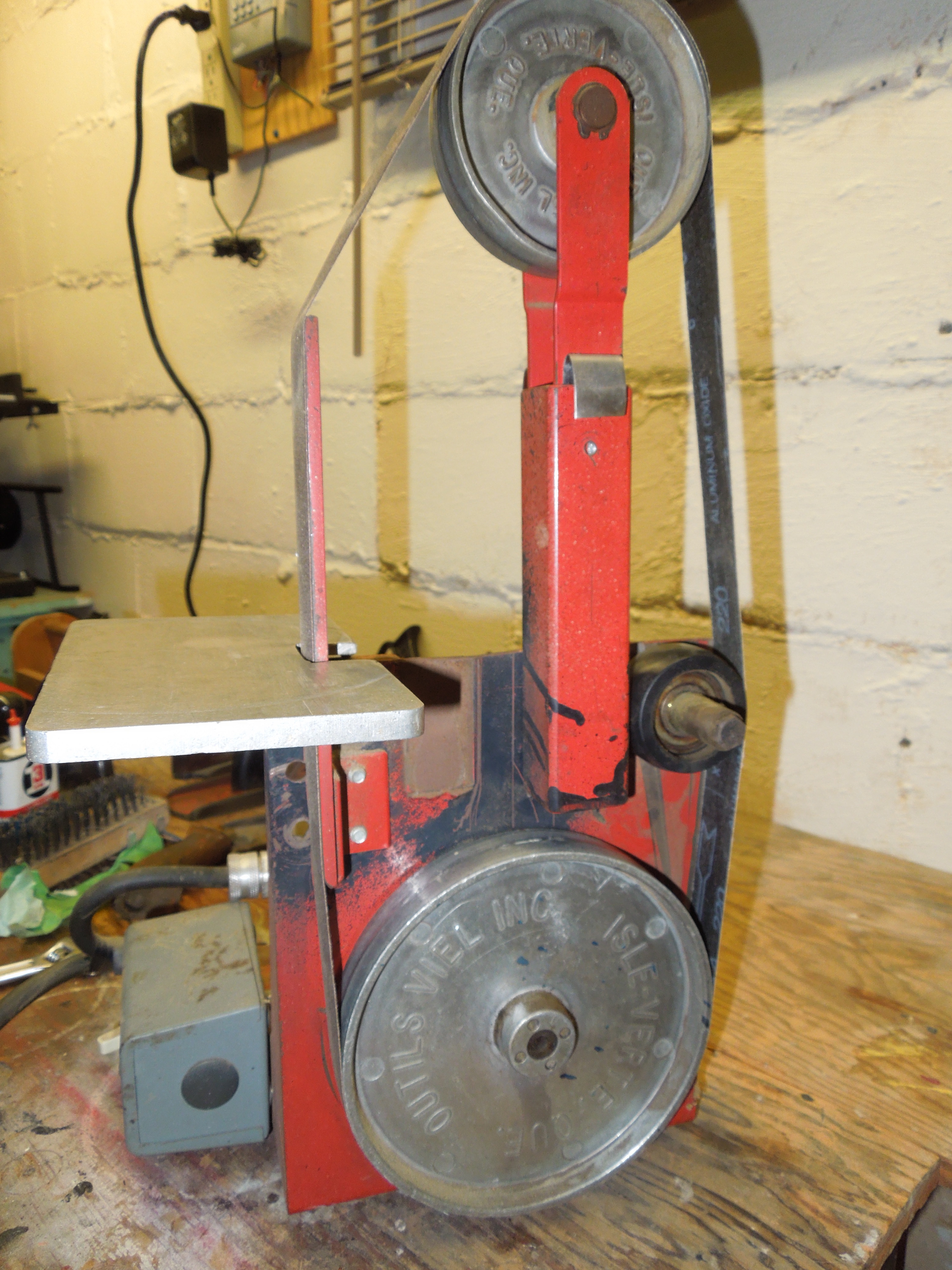

Hi everyone. My sharpening plans got put on hold for almost a year, but last weekend I got lucky and found a used Viel belt sander with a 1/4hp motor at a garage sale. It looks like an older one and the table doesn't have the groove to accept sliding jigs. It also has an extra wheel at the back. I'm guessing this was a modification done by the previous owner, unless they used to make them like that. It seems to work all right and the belt tracking seems okay, but the two tracking screws on the vertical column are missing and there are a couple metal shims wedged into the column instead.
Should I consider making any changes or upgrades to this machine? I'd like to restore the bevels on some chisels and plane irons and was thinking about getting the Viel chisel holder, but that would also require a new table with the sliding groove. Would a new table offer any other benefits?
