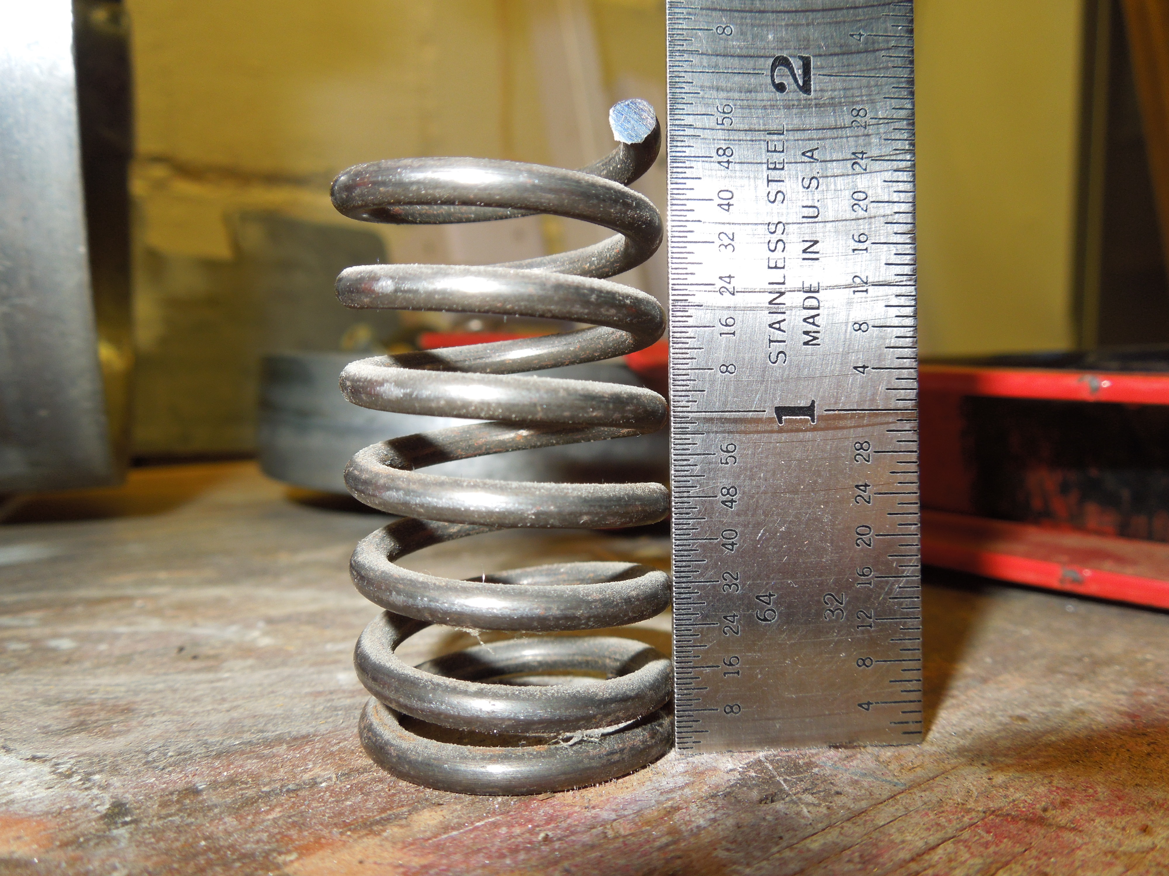

Wow, this thing has really been butchered. The spring has been cut down too. I've relocated the arm and clamped it in place for now, but I had to add a wooden dowel shim almost 2" tall to get the proper tension on the belt. I emailed Viel about a new table and sent them a pic of the table that's on it now. They said this machine is more than 30 years old. I'm glad I didn't pay much for it.
viel will sell the spring and the screws for tracking as well. I bought a spare wheel for mine to ream out for the 5/8 shaft. I had some duralon, a form of nylon over an inch thick. I cut a piece and fitted it to the tube so the spring rests on it now and it did improve tracking a lot. I would have the tube welded as it was in the first place. don't worry about age just refurb and use it.
