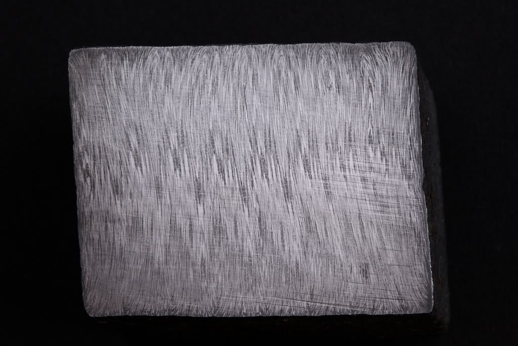

Chris, just for you here is a picture of the 2038 layers of "W's" billet and a knife I forged from that piece.
Revisiting the 2038 layers of "W's" billet, this piece is 1" X 1 1/2" X 1 1/2".
Integral knife forged from the 2038 layer "W" billet
And a close up.

And now for the money shot.
And a close up.
