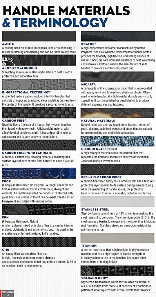

What is the difference between regular CF and "peel ply""?
Spyderco has three types of CF handle materials:
  1. CARBON FIBER
  2. CARBON FIBER/G-10 LAMINATE
  3. PEEL-PLY CARBON FIBER
Peel-ply and CF/G-10 laminate last longer than "natural" CF.
Which is better as far as grip, durability, etc.?

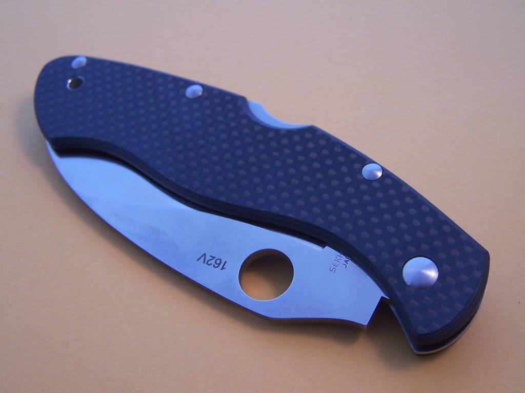

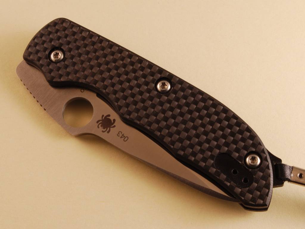

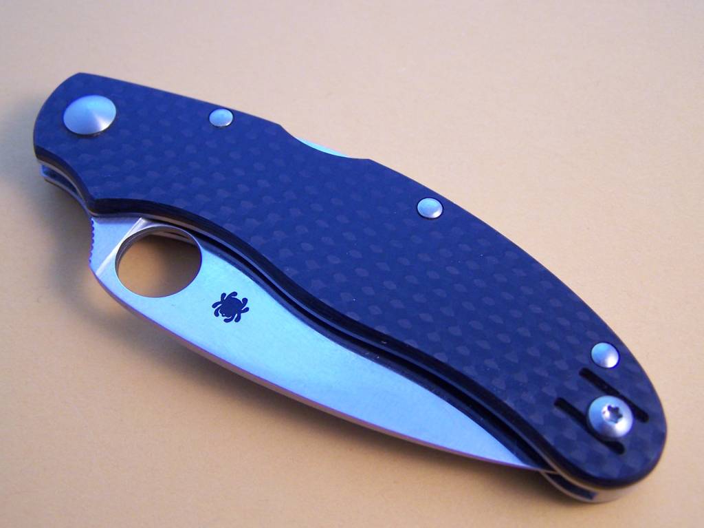

Two things, surface texture and appearance. Peel-ply CF has a surface texture like that of peel-ply G-10, although the CF's texture is more durable than that of G-10. It also has a more subdued look compared to matte, gloss, or twill CF, but offers more traction. As for which is most durable among the various CF surface treatments, it's a hard call since all are quite durable.
PEEL-PLY:
MATTE:
GLOSS:
TWILL:
I'm glad I spotted this thread. I've been wondering about the difference between the various types of cf handles too. Also , those pics are beautiful.
