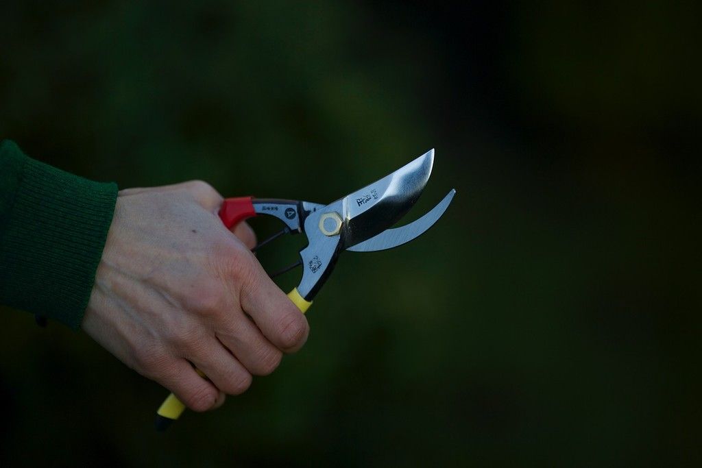

Speaking of white and blue paper steels..
I'm a large scale gardener and I just found my new pruners. They just happen to be in Aogami Blue paper #2. Holy balls am I excited.
