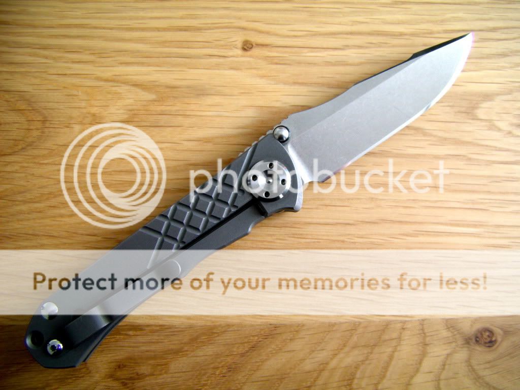

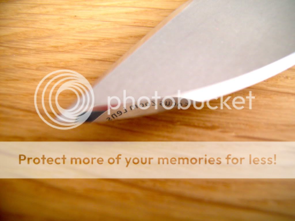

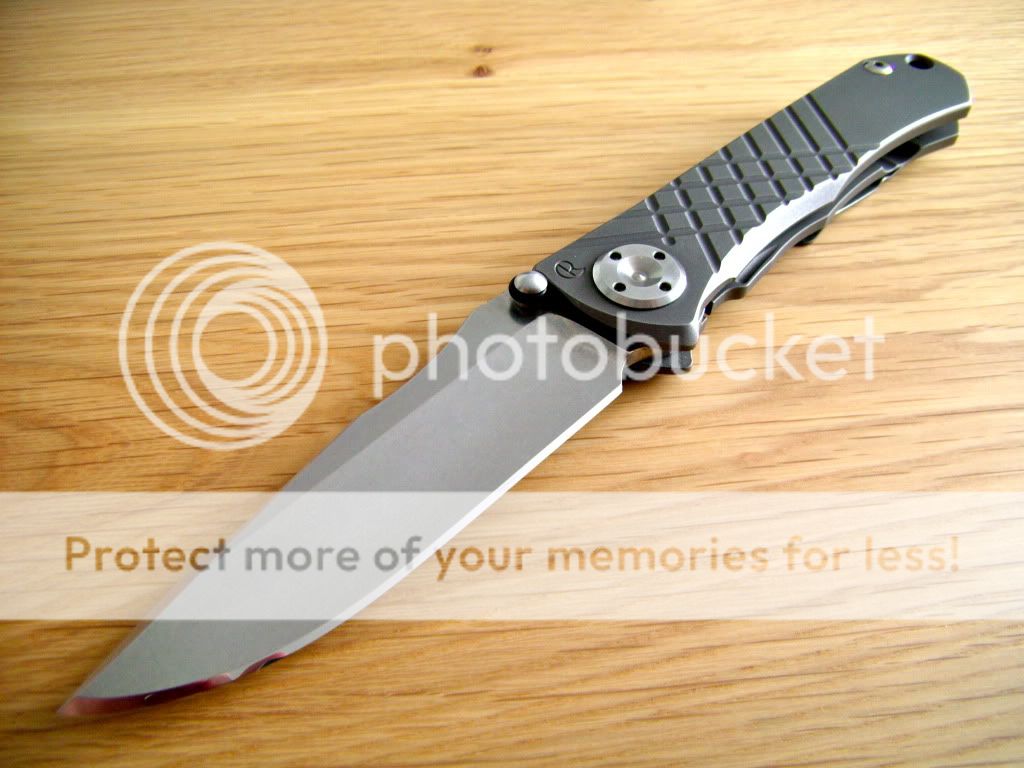

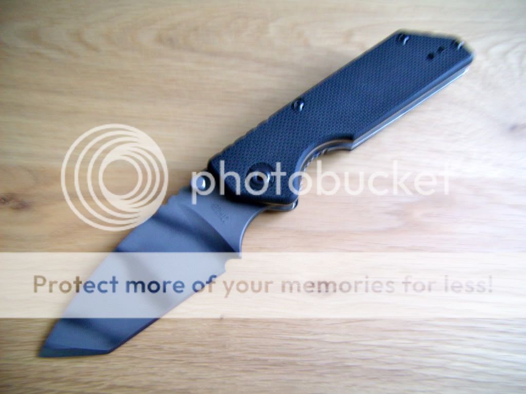

This is my one of my users, an old school Strider GB that i sharpened to 30 degrees inclusive on the WE up to the 600 grit diamond stones, after which some stropping on leather loaded with cheap green compound.
It's also quite sharp, as in slicing single sheet toiletpaper sharp.
[youtube]7nLIprHUjrQ[/youtube]

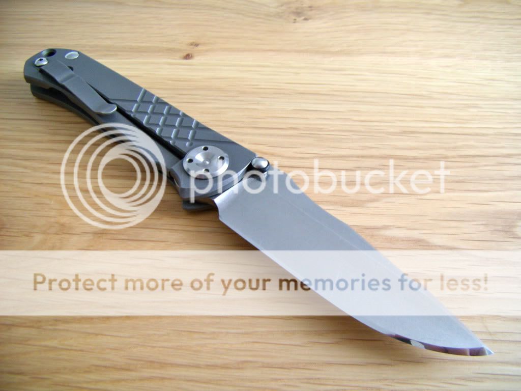

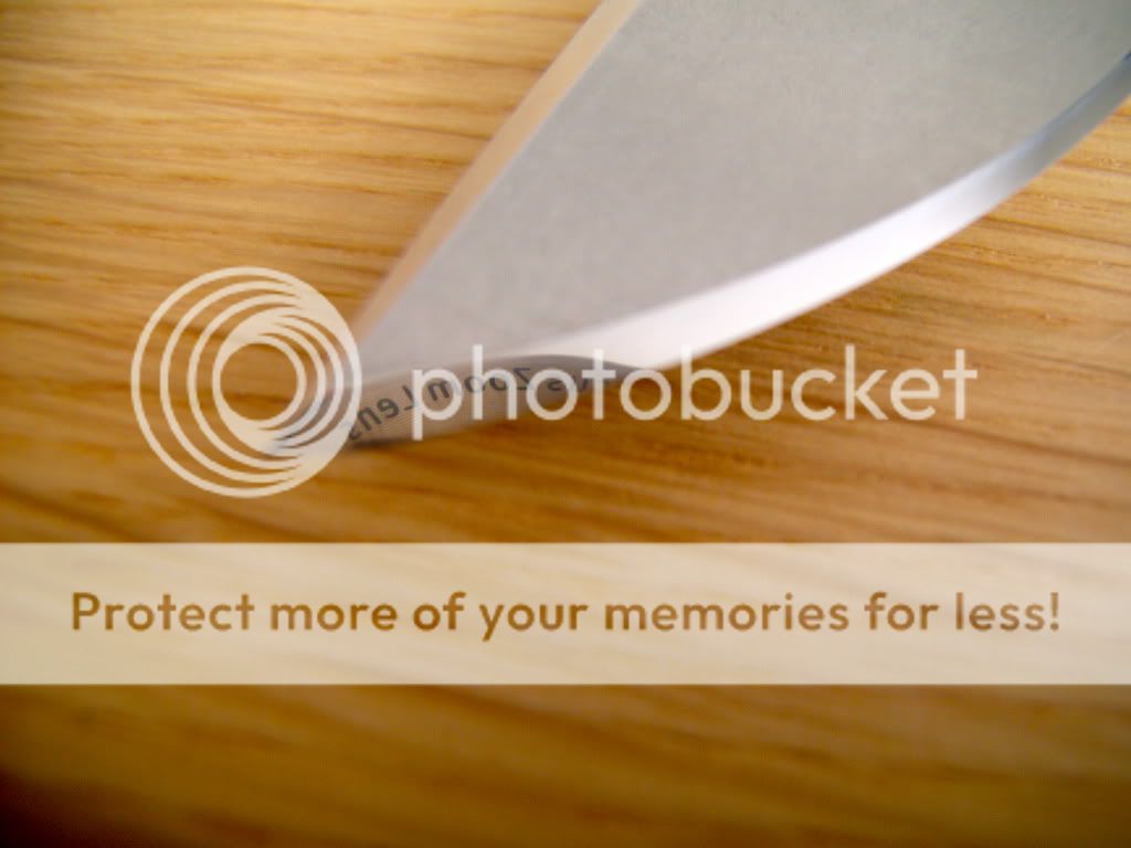

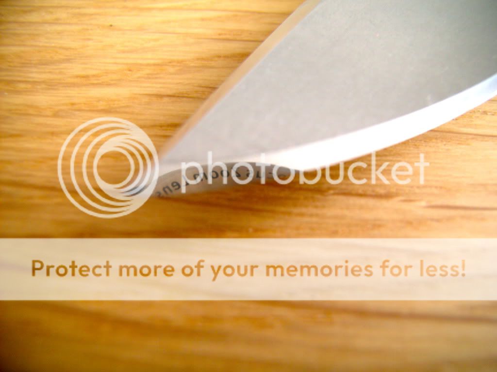

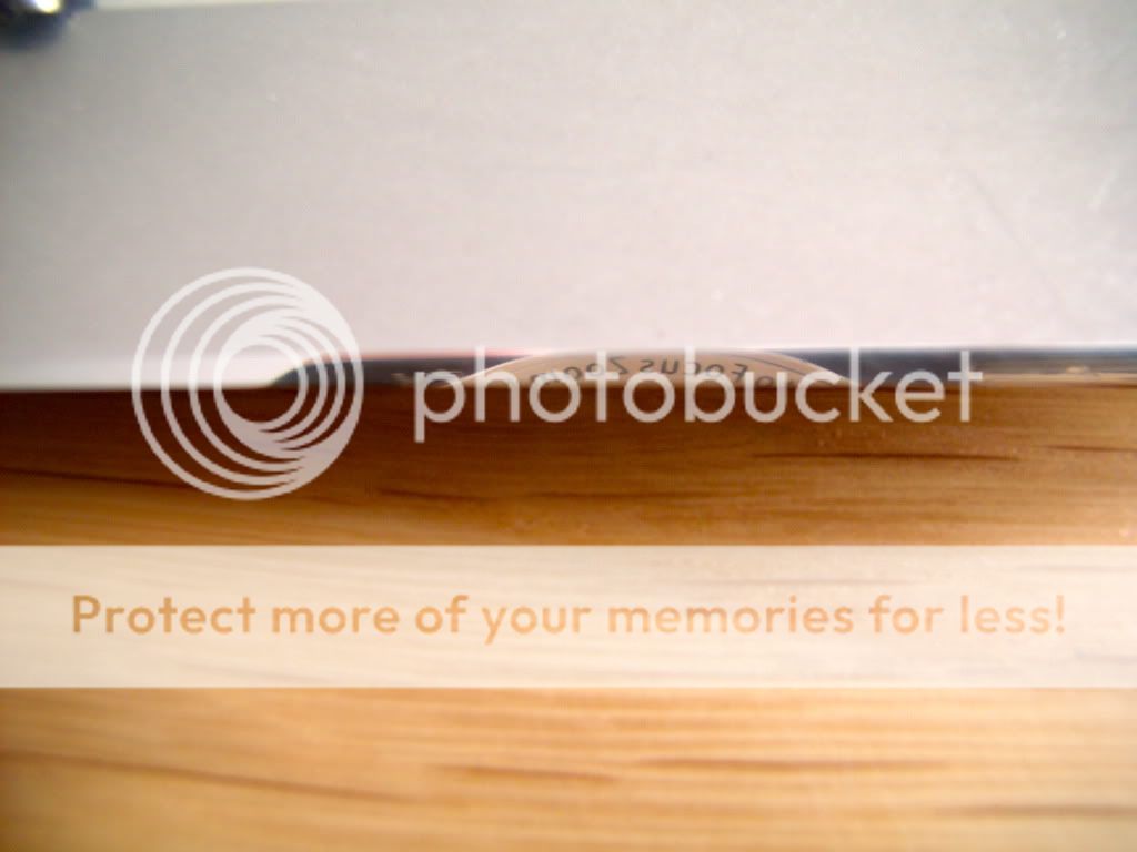

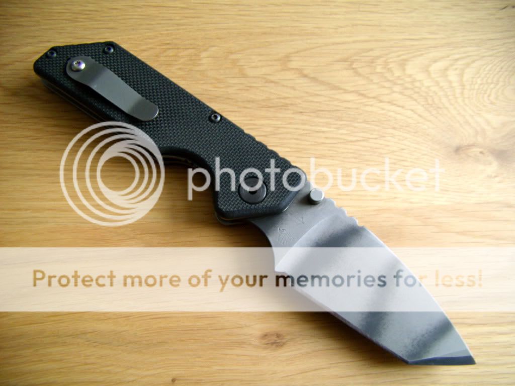

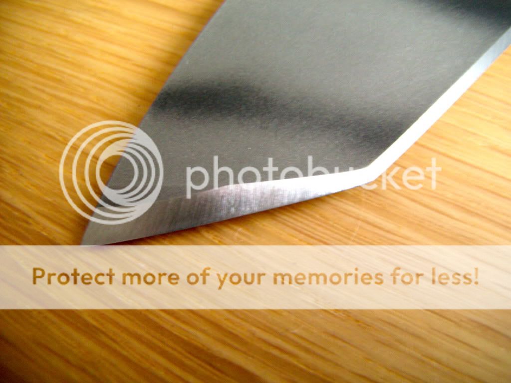

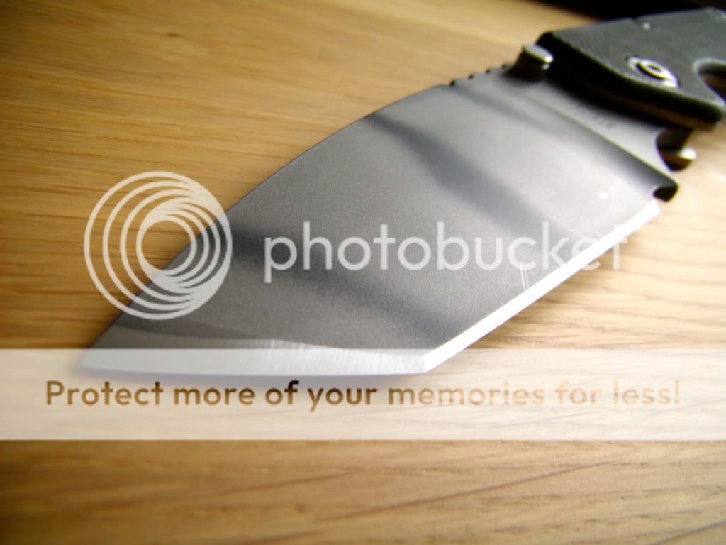

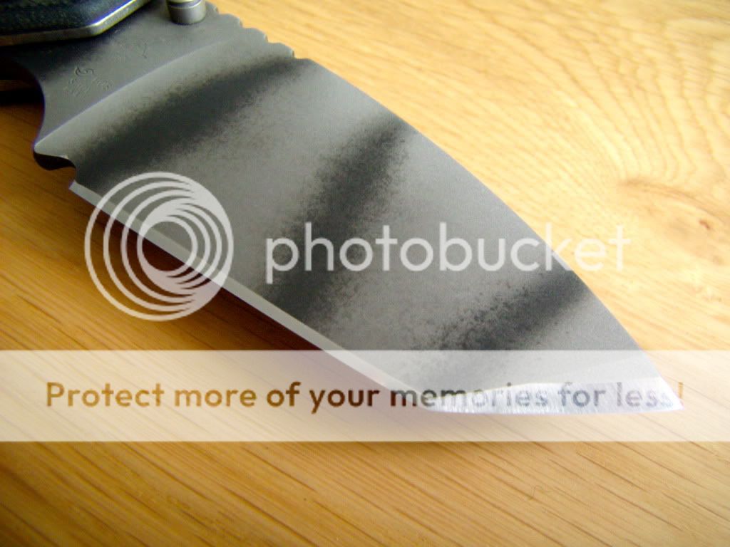

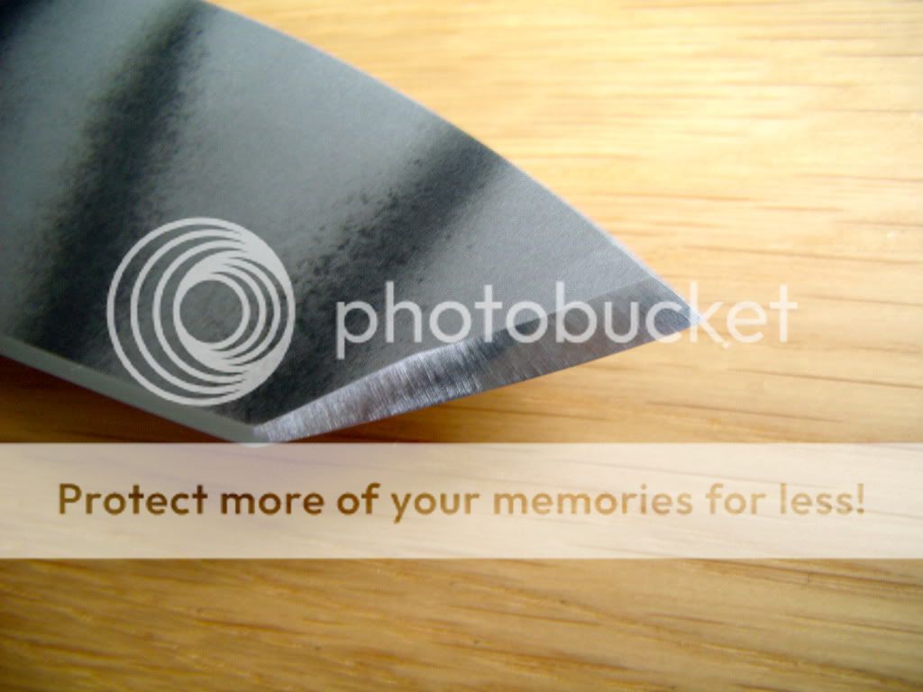

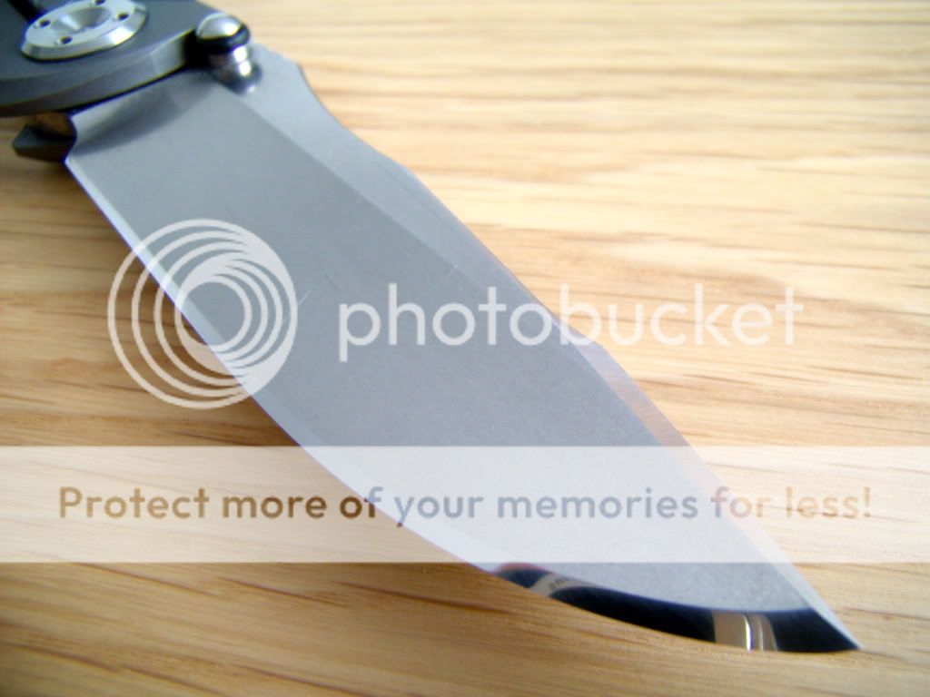

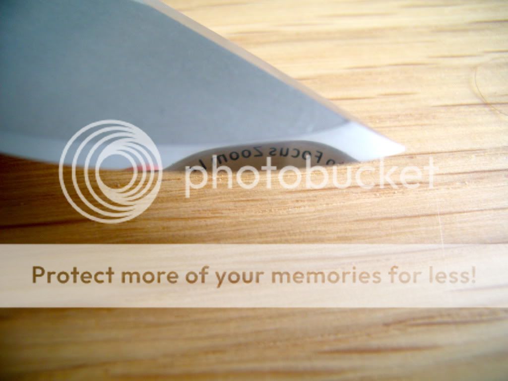

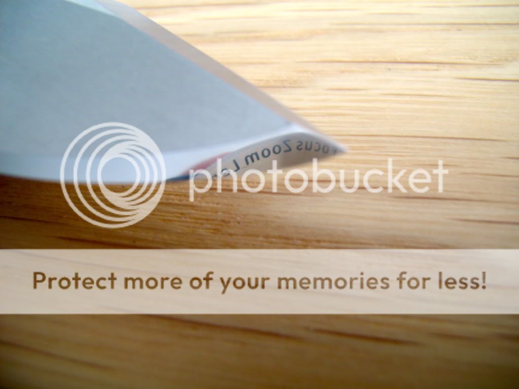

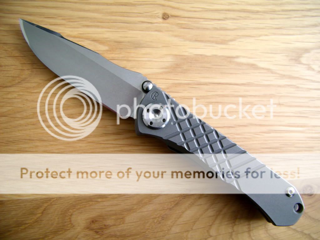

This is the user Umnumzaan of a fellow member on the Dutch knife forums.
It didn't cut well since the belly of the blade was much too obtuse to get as sharp as the straight portion of the blade.
I reprofiled the edge to an even 34 degrees inclusive using the 100, 200, 400, and 600 grit diamond stones, and then refined it with SiC wet & dry paper (taped to the 600 grit stones) up to 2000 grit, after which some no-name polishing compound on the back of the used wet & dry paper.
While the resulting edge looks to be mirror polished, up close you can still see a certain haze; S30V is filled with hard & wear resistant vanadium carbides so diamond compound would have given better results but i didn't have that at the time.
Sharpness is easily hairwhittling though, and it also slices the single sheet toilet paper.
