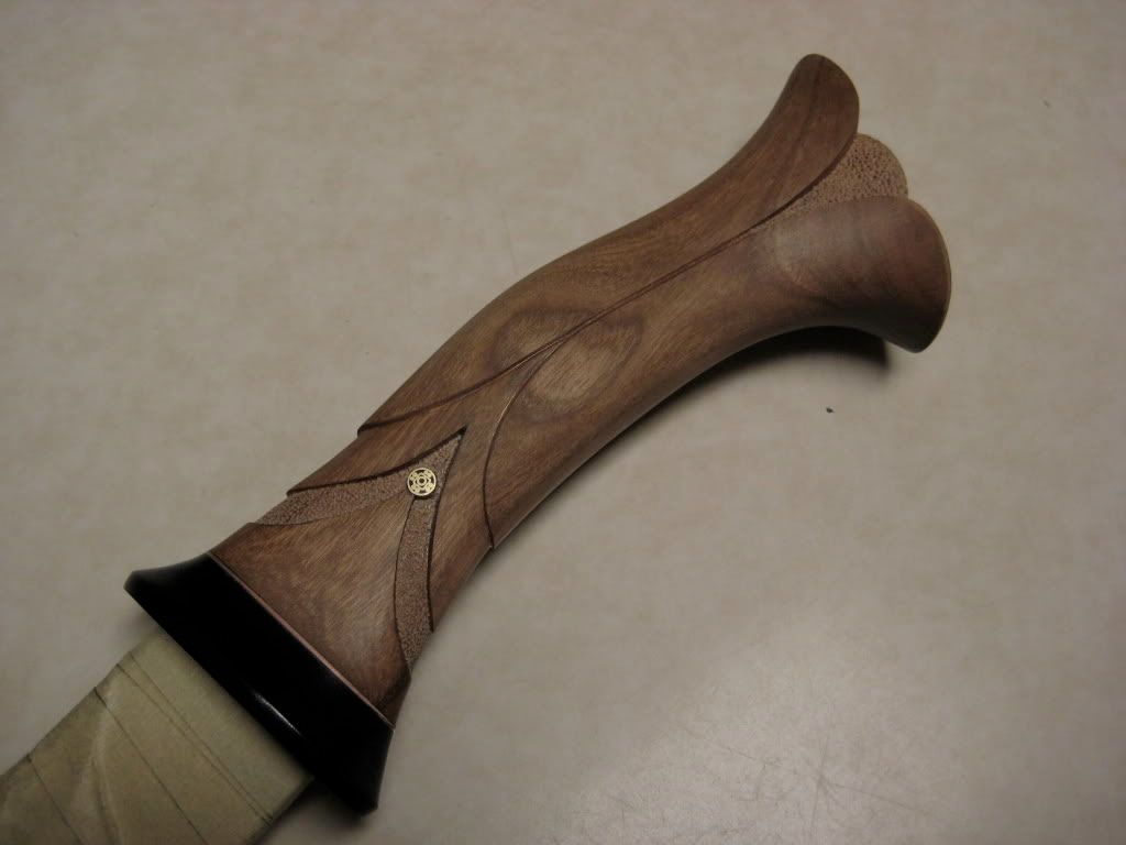

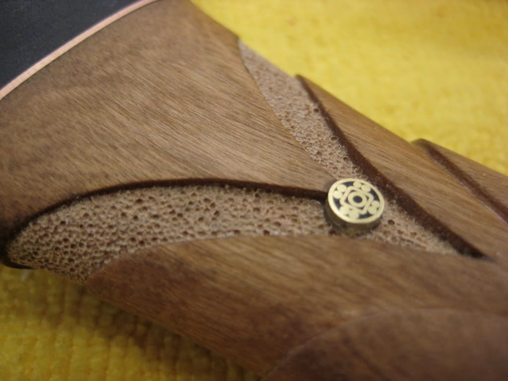

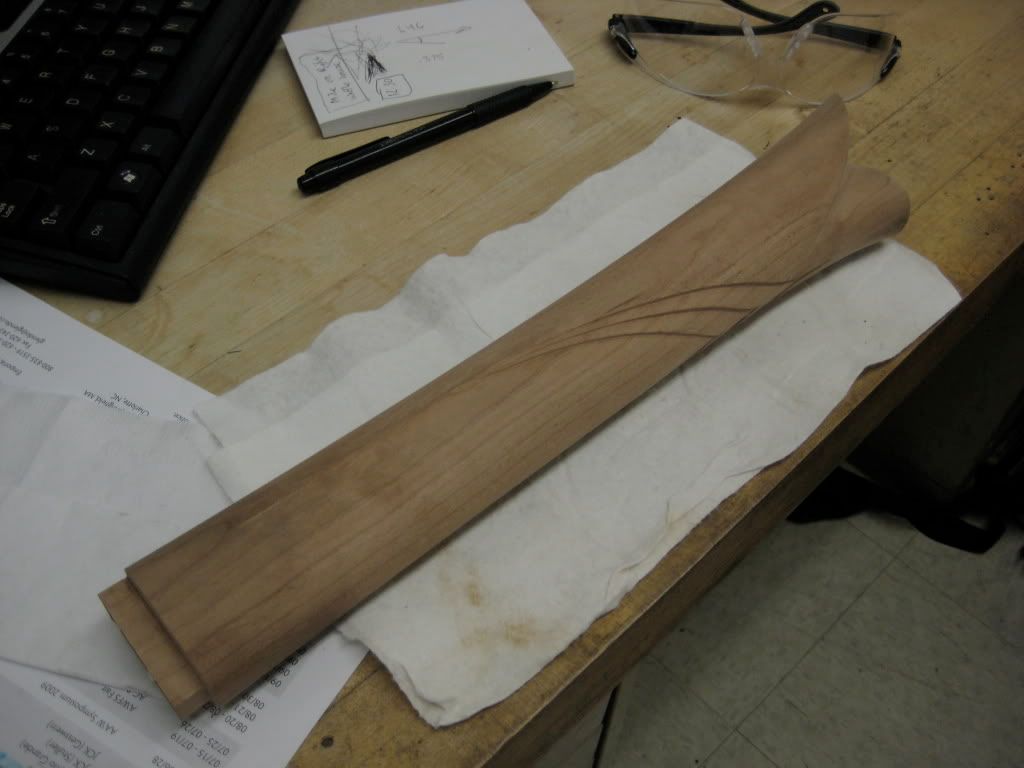

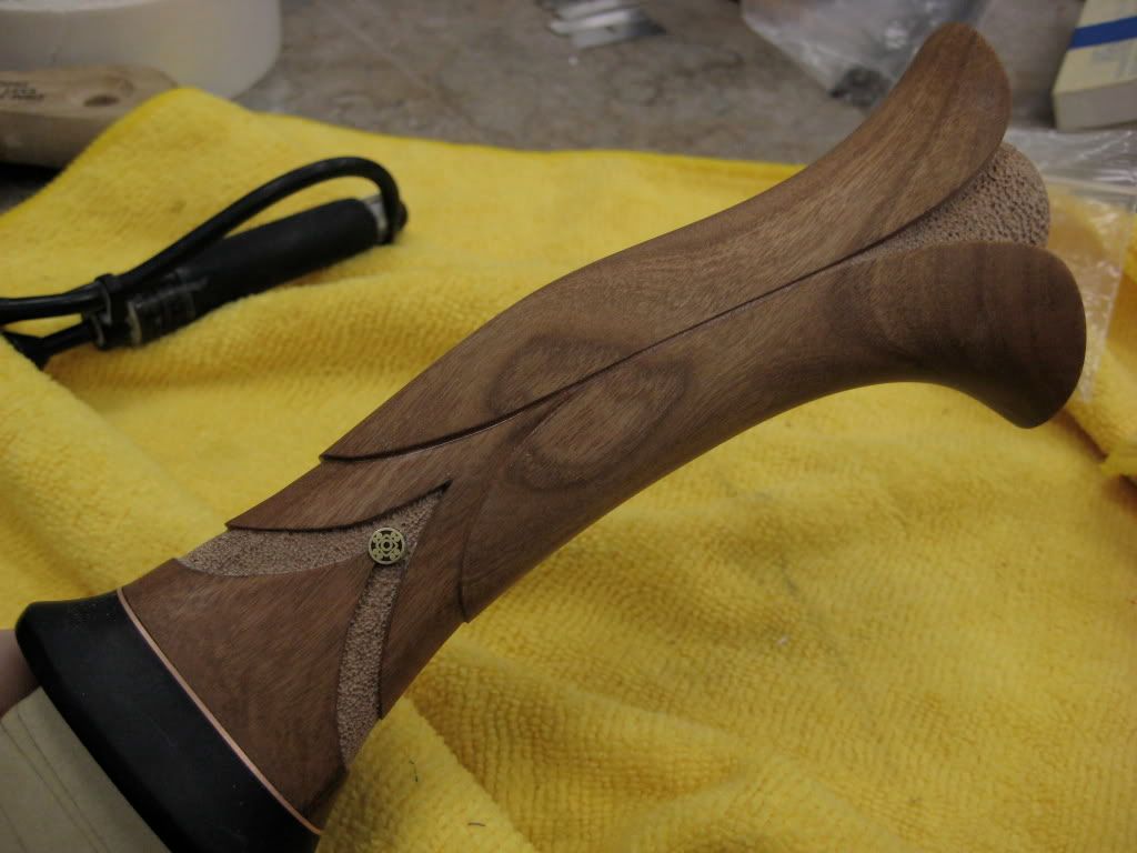

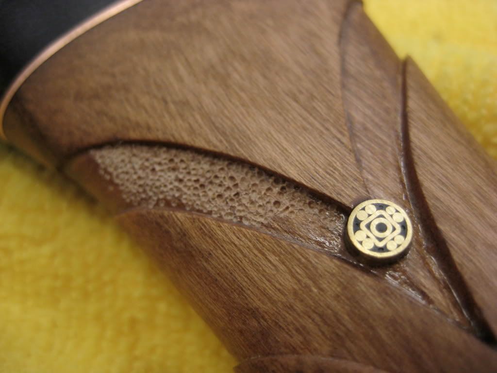

Hey guys! you wanted texture... so here you go! *grins* i kinda wanted more of a color change... any recomendations?

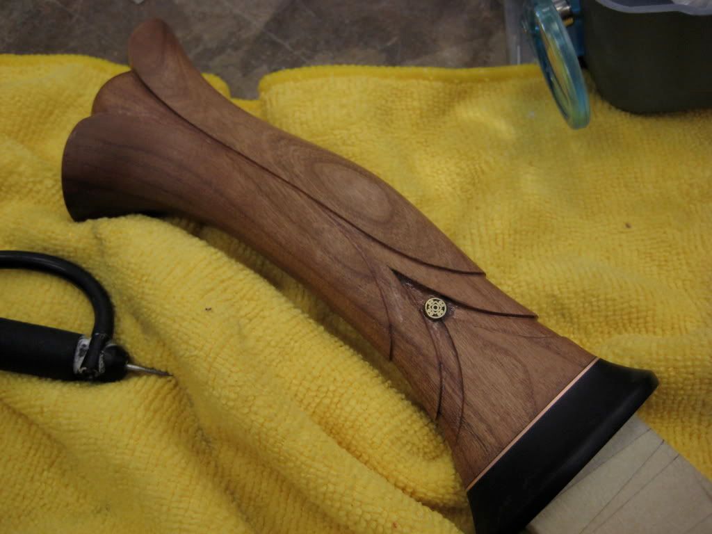

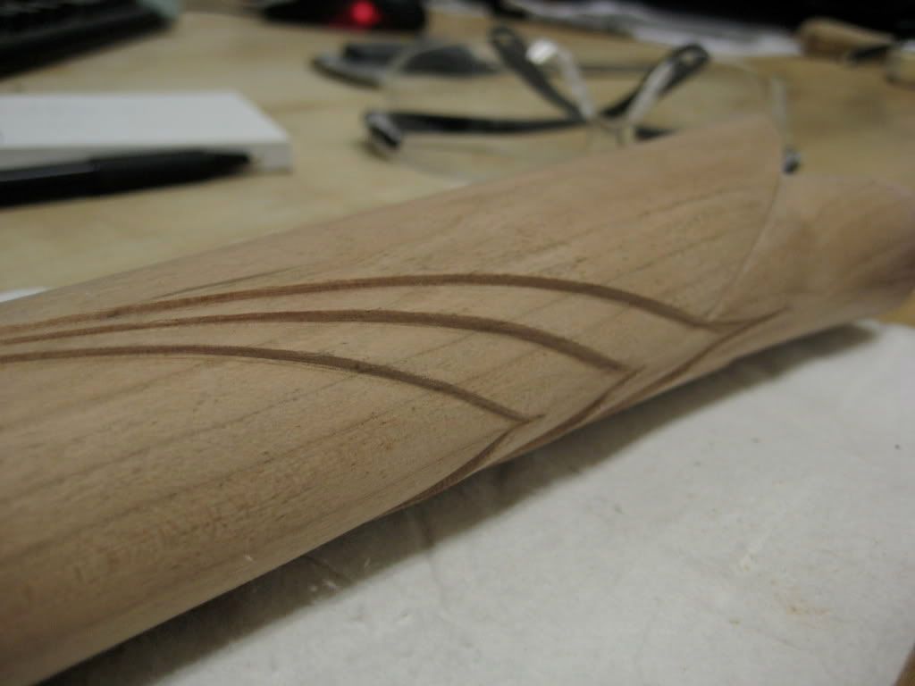

okay... i put on a coat of really slow West Systems resin, letting it soak into the wood, then wiping it off before it set up, so i have a satin-ish finish.

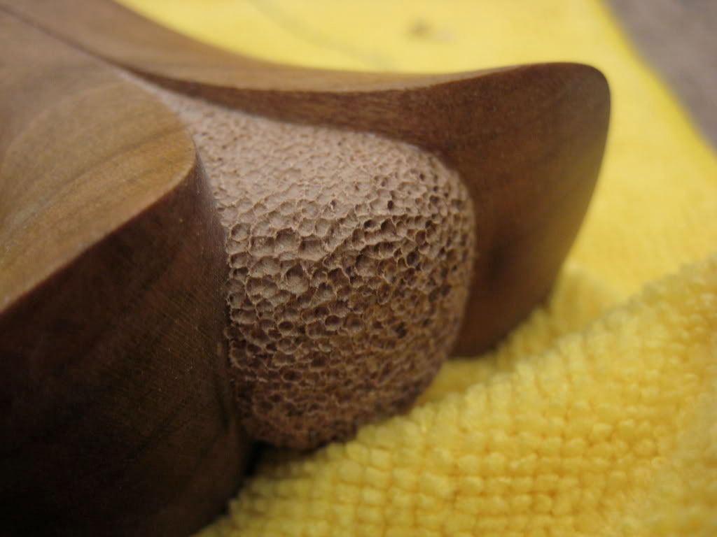

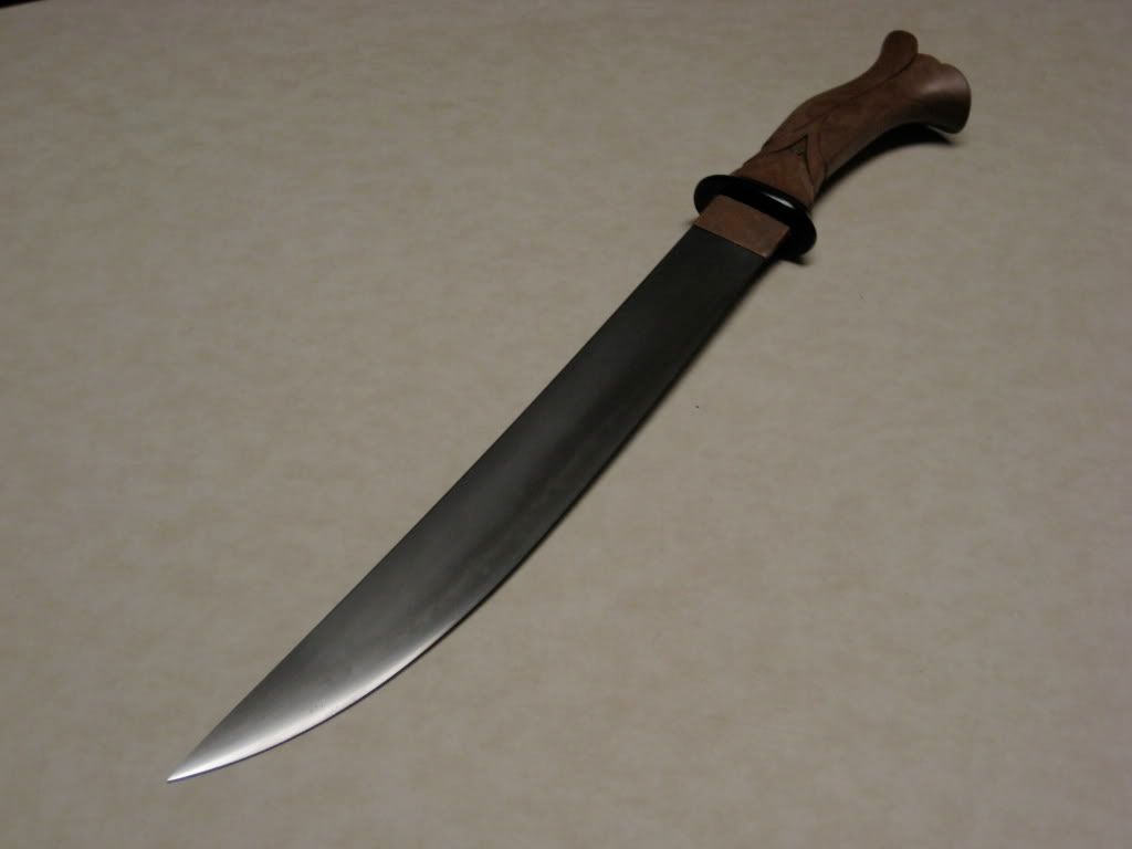

went over it with 500 grit paper and 000 steel wool. then i used a high speed rotary tool to texture the wood. then went over it witha coat of tung oil. and then i took off the blade covering. you can see the hamon very well in the right light.

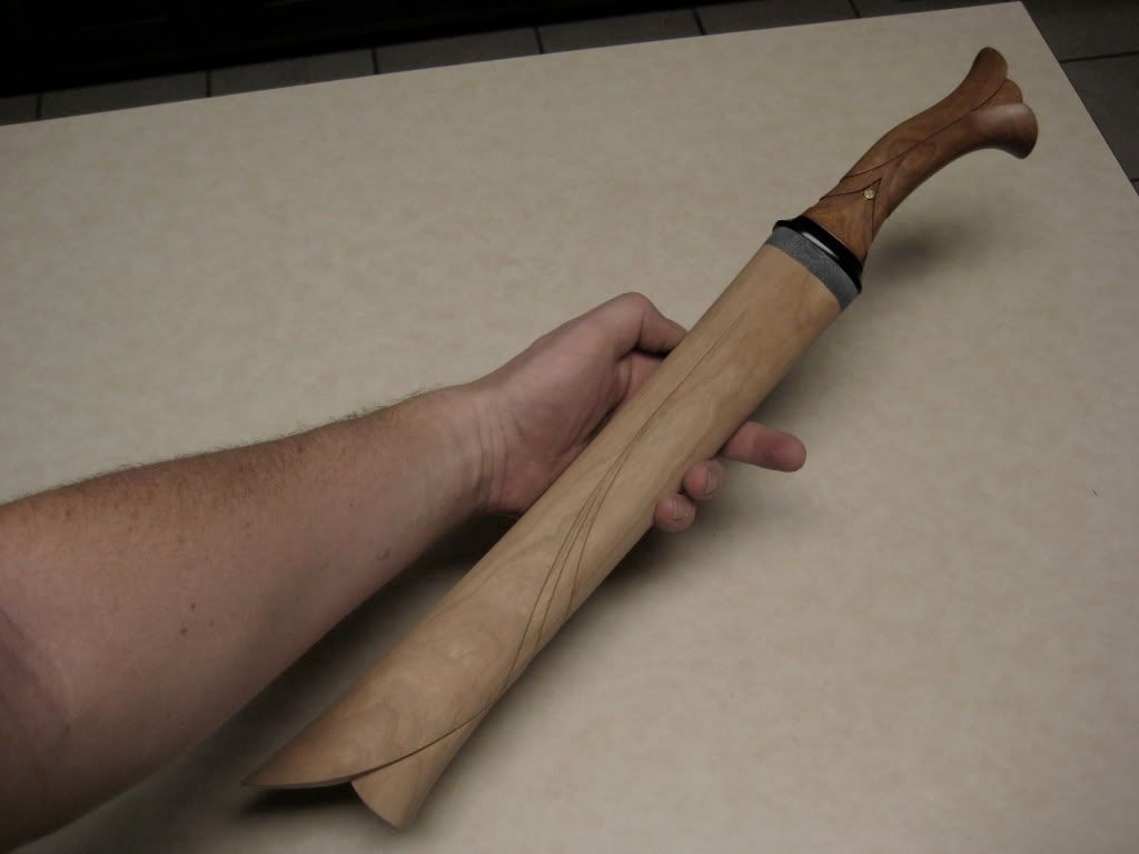

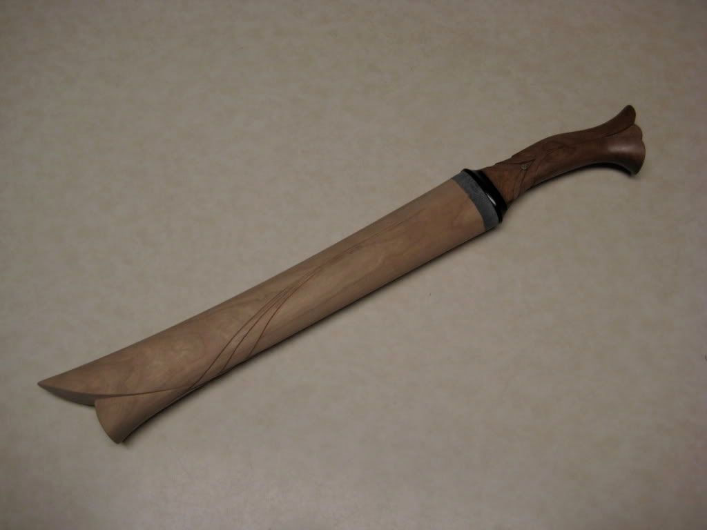

the sheath is still a work in progress. more pictures to follow.
please let me know what you think!

organic.. thats kinda what i was going for.. very organic, and i think the texture helps that.. as you said.. fungus.. or marrow... you know what i mean?
