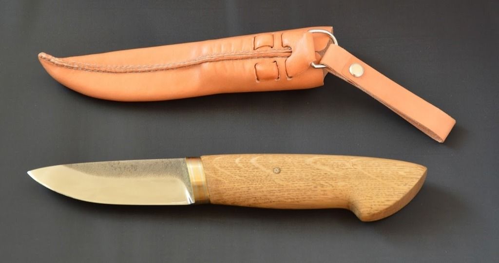

This is Dutch oak, a slightly different kind as American oak.
Try and get a piece with good rays (tiger stripe). On this one I filled the pores with wood dust and an oil/varnish blend.
You can leave them open as well.
It was a gift for my niece who emigrated to Sweden, Dutch oak handle and a Scandinavian design knife.
