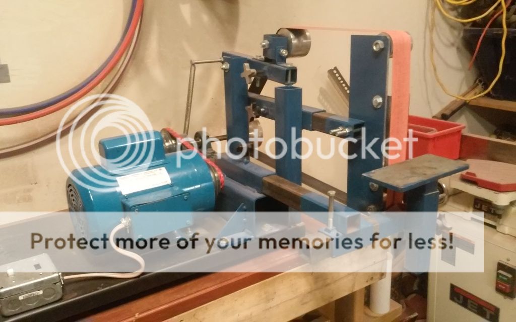

This past summer, my grandfather and I started a 2 week long project at his house up in Michigan and I wanted to share it, and my workshop with you guys.
The project was a 2x72 belt grinder. It took us over 2 months to round up all the parts and steel for the project and we had a little help from my Grandfathers friends for which I am very grateful. The motor is a 1.5 hp motor we bought new from the local electric store. It runs at 1750 rpm. A good half of the parts we bought, along with the plans were from USA Knife maker. What was out of stock or too expensive there was bought elsewhere which ended up saving me a few dollars :) Total, the grinder cost me about $300 in parts and my uncle got us the steel from shipyard were he works. My grandfather covered the motor and some other little things. All said and done, you could probably make one like this at around $500 if you have the steel on hand!
This was my larges project to date and I had a BLAST making it. Now I just need to get a 8" contact wheel and some cubitron belts o_O

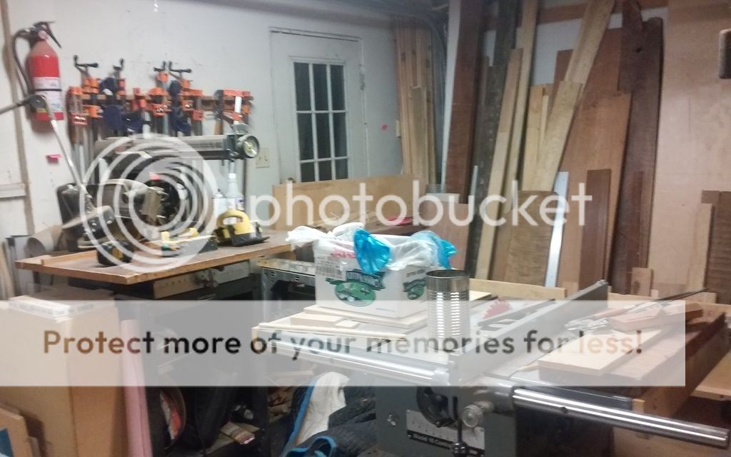

My fathers table saw, radial arm saw, and our collection of wood too big to fit under the grinder bench. There is some walnut, Ipe, cedar, maple, oak, and plywood over there. most of it won't make it onto a knife but it is nice to have for woodworking projects.

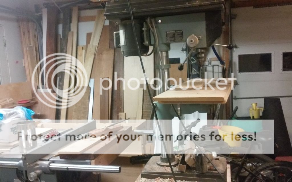

Our Drill press- it is an old Delta and it works great for wood and steel.

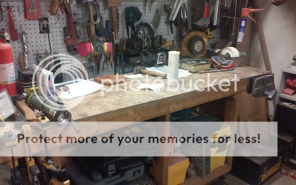

This is my finishing table. I do most of my hand sanding and finicky work here. It is rarely this clean ;)

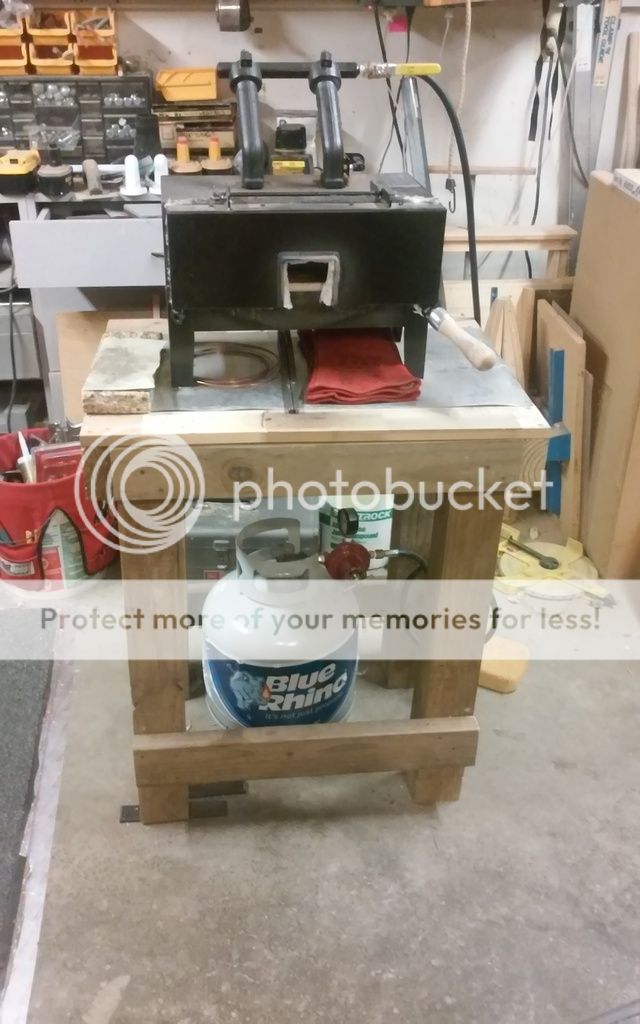

Here is my forge. I bought it for around $500 at NC Tool co. It's called the "Whisper Mama" and it has served me well. Comes with all the fittings so all it needs out of the box is some propane. Highly recommended for heat treating 1080 and small forging jobs.

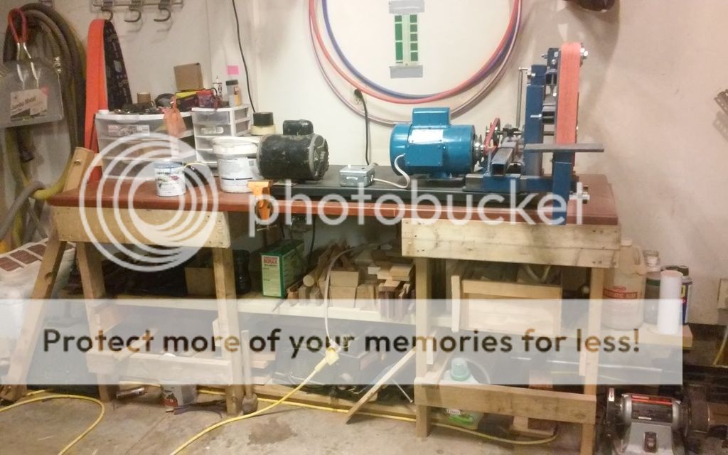

And at last, here is My Pride And Joy! I put a really Beautiful Royal Blue Rustoleum enamel coating on it and I like it; it matches the motor almost perfectly! Under the table is my collection of exotic woods- I also store my various metals on that shelf, along with my acids, oils, and WD-40. When I get my contact wheels, I'm going to put the different fixtures down there as well so I think this turned out to be a really nice setup.
You may realize the work rest is a bit crooked. This is okay for me because I plan on just freehand grinding with this (when I get the hang of it). It works well for my purposes :)

Do yourself and all that nice shop equipment a big favor and get that bottle of muriatic acid out of the open shop. It will cause rusting. Either store it in an outside shed, or place in a tightly sealed 5 gallon tub ( paint/drywall type bucket).

Will Do Stacy- probably a good idea :)

You might also want to have a chat with the local fire marshal and see how they feel about a propane bottle stored in a structure, especially if the garage is attached to the house.
I like that idea. I believe my mother has a few really nice Tupperware containers laying around that would be the perfect size; I'm sure she wouldn't mind them disappearing for a few years ;) I'm not sure getting the fire Marshall involved is necessary but I'll start storing the propane in the shed out back if you think it is necessary.
I think the main thing keeping me from moving the propane and forge outside when in use is getting inexpensive castors and my neighbor across the street. The guy can talk to hours and if you open that garage door an start working in the drive way, might as well say goodbye to your afternoon o_O I'll work on fireproofing the shop tomorrow...I'm predicting yet another massive workshop layout change is coming...
It will depend on your local Fire Marshal and fire codes, but where I am the Fire Marshal prefers to see propane cylinders outside the building locked in a cage. I've got 4 tanks of acetylene in the shop, along with lots of Oxygen and other high pressure gas, but I got an earful about the 20 lb propane tank for the forge...YMMV
