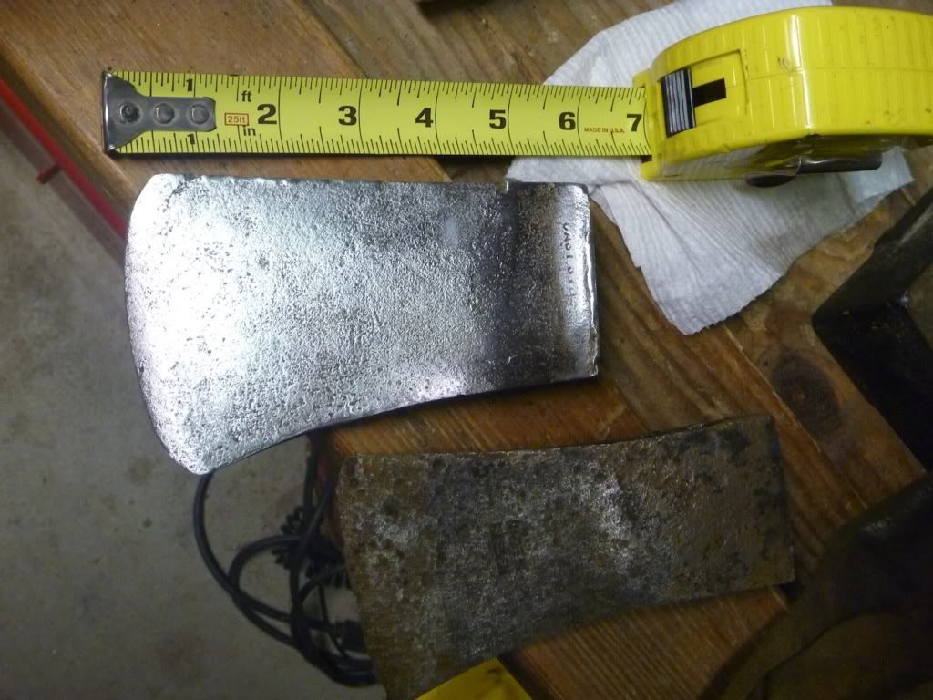

I found two small hatchet heads at the flea market. One was rusted up pretty bad, the other not quite so bad.

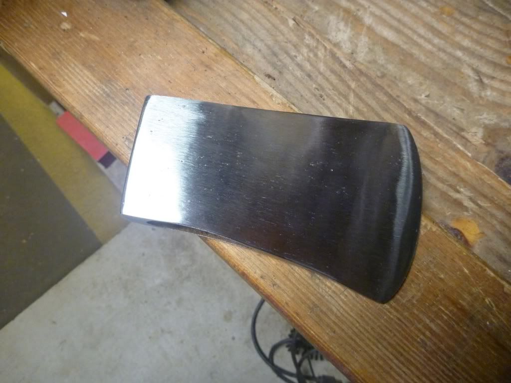

Each went into a vinegar bath for about 60 hours.
Ended up with a nice Dayton/Delaware type pattern on one. Feels about 1-1/2 lbs. Only says "Cast SteeL' on the head.
The one that was real rusted up ended saying "Made in Sweden". I think there is less pitting on the surface of the moon. There is what looks to be a 1-4 on the other side. Maybe 1-1/4 lbs?
Either way, I figure I'd start with the Dayton and post pics as I restore it. I picked up a nice piece of pistaccio wood for the handle. So far I only ran them over a wire brush and then a 3M belt. More to come...

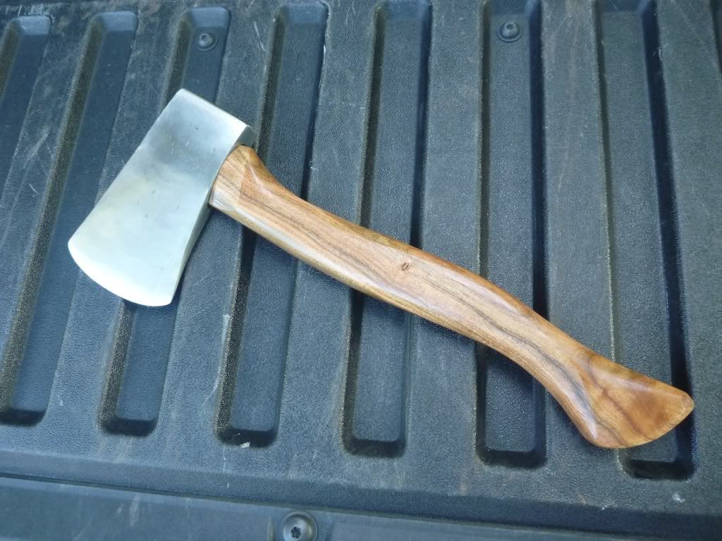

Just finished the first hatchet.
Picked out a piece of Pistaccio wood, made a sketch to follow and carved out a rough handle.
Then I sanded out the details and fit the head to it. Very secure fit. Took down a 5 inch beech tree in about 2 minutes.
Head stayed nice & tight. Now I need to make a sheath for it. 5 Pics posted below.
