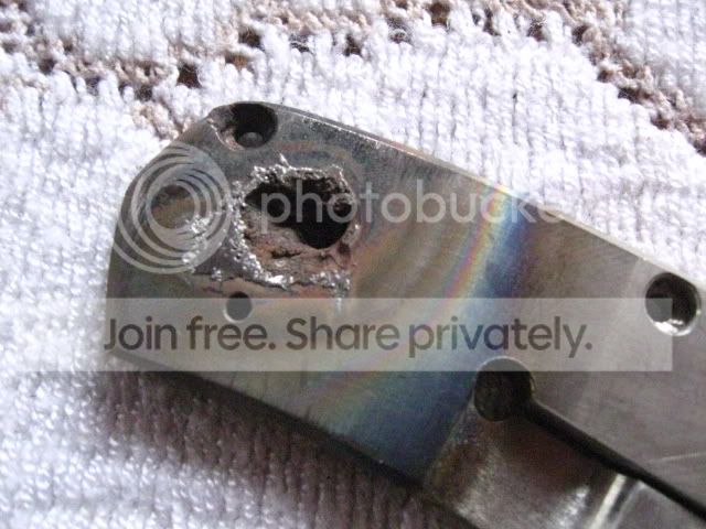

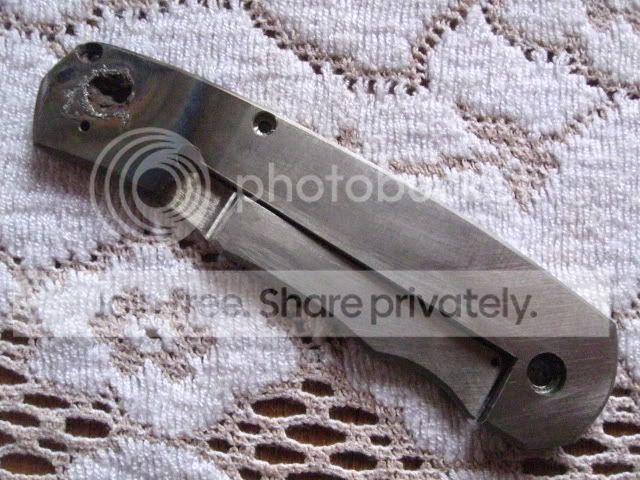

Have you ever had that feeling when you numbly recoil from the mess you have just made from what was very recently a nearly finished knife?
Check this out. I'm building this TI, S30V framelock. I nearly have it done. It's a working knife, locks up solid, a nice piece, only the pocket clip left to install and some sanding on the frame.
I drill the pocket clip holes. #51 bit for 2-56 screw. I start tapping. Although I'm very careful, the tap snaps in the hole. (.162 TI, next time I'll use a #52 for TI this thick.) I try to get the tap out, to no avail. My only option: to dissolve the tap in ferric chloride. It goes into the bath. FFW four days.
The full strength Ferric bath has still not dissolved the tap fully. I am, however, able to knock the tap remnant out with a small punch. I clean the hole up, and get some threads into it. I now have one clip hole left to tap.
VERY carefully, I get the tap almost completely through the TI. Then, I break the $#% tap off in the hole.
With a sense of unreality, I realize that despite KNOWING it would easily break, and TRYING not to do it, I am back to square one.
I kind of lose it. I'm not waiting another four days to get this one out. So I decide to try something I have previously only heard about: heat the tap up with a torch and use the oxygen to burn the steel tap fragment out of the TI.
All I can say is, I wouldn't recommend trying it on something you already have several hours invested into. At least not in that frame of mind.
A minute later, I'm backing away in abject fury and shock, faced with the disgusting spectacle of the lock side of the frame irreparably marred by a large foamy crater in the TI.
Two hours later, I'm able to say this: at least I can still use that ruined piece as a pattern for the re-build. More TI is on the way. And don't work angry on a knife for which you have taken a deposit.
You guys ever feel this way? :eek:

Okay Phil, here's a couple pics.
I mean, look at this. Are you kidding me?
I'm gonna try a #52 and tap in some scrap TI of the same thickness. If that don't work, or maybe even if it does, I'll maybe drill the clip holes through the new frame piece with a #51, then counter bore halfway into the same holes from the back with a clearance bit. Then tap. That way I'd only be actually tapping about .080 thickness. Plenty of thread to hold a pocket clip with three screws.

I'll point out that using an oversize drill or very short thread engagement may leave adequate thread strength in the titanium - but you have to remember that the fastener you're using gets the same amount of thread engagement... So you still need at least three full threads, preferably five, and no less than 60% thread depth or the screw can strip.
A sharp high quality HSS tap, in a correctly sized hole that is properly aligned and lubricated with a high pressure tap lube will work every-single-freakin-time.
The yield strength of most titanium is probably 180,000 PSI. What is the film strength of the lube you're using? I have found that can make a big difference.
Been there and done things like that. I would recommend however that you not go with a #52 (.0635") bit as it is actually smaller than a #51(.067"). You might want to use either a 1.75mm (.0689") or a #50 (.07"). By my charts the #50 is what is recommended for a 2-56 or 2-64 tap. Also buy good taps as ti is a real pain to tap as you found out. Use the moly d as Nathan recommended or a lube that is designed specifically for ti.
Dammit, Carl, OUCH!!!
By god, you are right Chuck. I probably will go to a #50, then.
Nathan, good food for thought. I confess that I was merely using WD40 for lube. I did use a brand new tap; it was a taper HSS straight flute tap. Maybe I'll go with a spiral tap and at least some Tap Magic.
I think that is likely your problem.
WD-40 is almost useless as a lubricant and is only useful as a cutting fluid in very low pressure applications such as light cuts in aluminum or in applications where you want a low film strength like when sanding or stoning. It has no EP qualities to speak of and low lubricity as well. It does work well as a water displacer though.
The ability to feel so you can back off becomes less important when you no longer need to back off, which is what a good tap and good lube and good alignment can frequently achieve for you.
