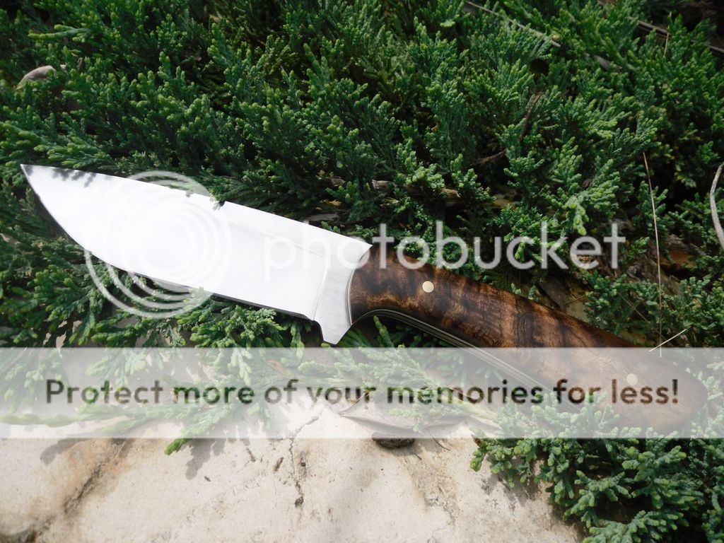

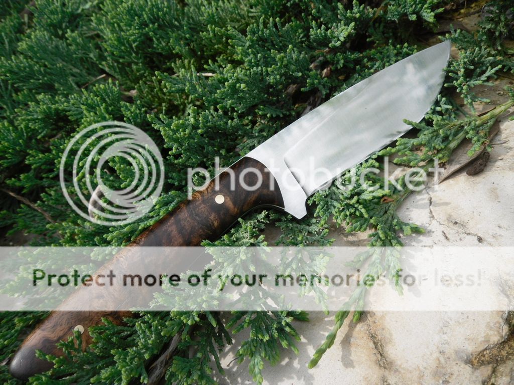

Now that is a knife that interests me! I view a hunting knife as being utilitarian in nature, and if fancy frou-frou stuff is going to increase the cost but not increase performance, then I don't need it. As for maximizing profit: you capitalist pig! We all know that you knife makers are secretly rolling in the dough and just living a pauper's life in public while quietly stuffing the hundreds of thousands of dollars under your mattress and in off-shore accounts! You should feel guilty for making a single penny off of me! How dare you! Seriously, though, if you don't maximize your profit, how are you going to afford to make your "gold" line? And, what price point are you hoping to hit with your carbon steel knives?As mentioned I am hoping this will turn into two lines of knives. A basic one (a simple carbon or tool steel, hence the thread), and a higher end knife (prob CPM M4) hopefully down the line. This lower end line will not have anything fancy on it. We're talking steel, wood, pins. Thats it. No mosaics, no bolsters, none of that. It will be kept minimalist to maximize profit. Profit....yeah right.
