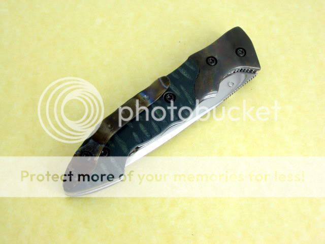

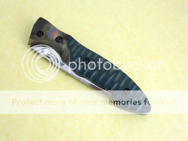

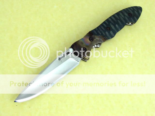

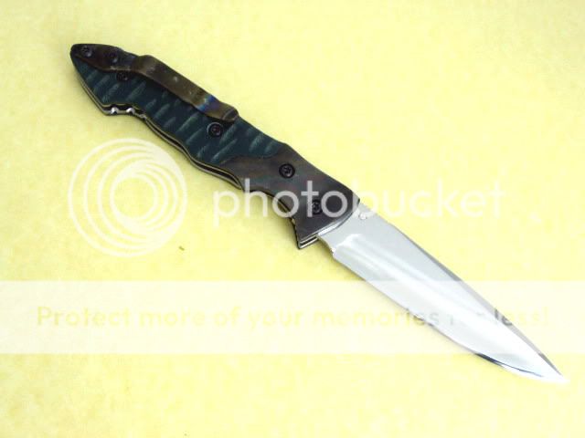

Hi all,
This knife is just finished. It's call " Smart ", The spec is :
Blade length 4 " ( Mirror&Satin finished ) and 1/8" thickness.
Opened length 9 "
Blade steel ATS-34, 60.4 Rc.
Bloster - 6AL 4V titanium
Handle mat. - Textured Green G10
Locking system - Liner and very solid ( 100% opposite the blade )
Liner&Spacer - 6Al 4V titanium
Pivot - Hardened SKD11(D2) dia. 1/4" with torx screws detant.
Washer - Teflon ( Smooth opened )
Thumbstud - SS and ivory inlay
Clip - 6AL 4V titanium.
Thanks for looking and comments.
