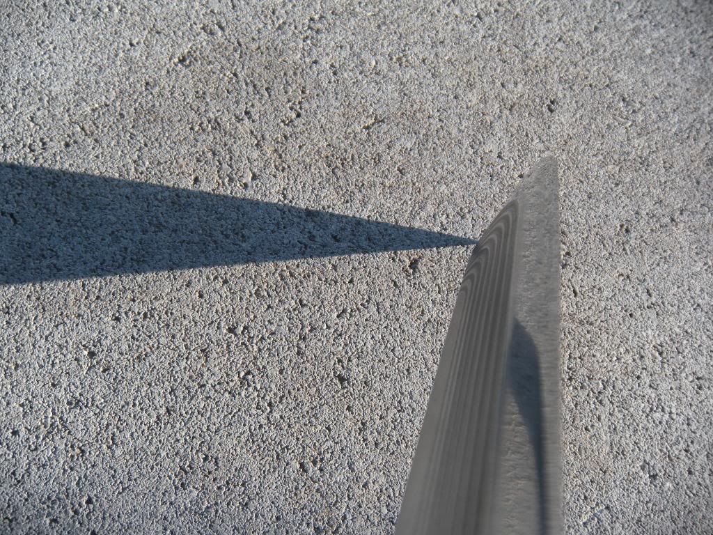

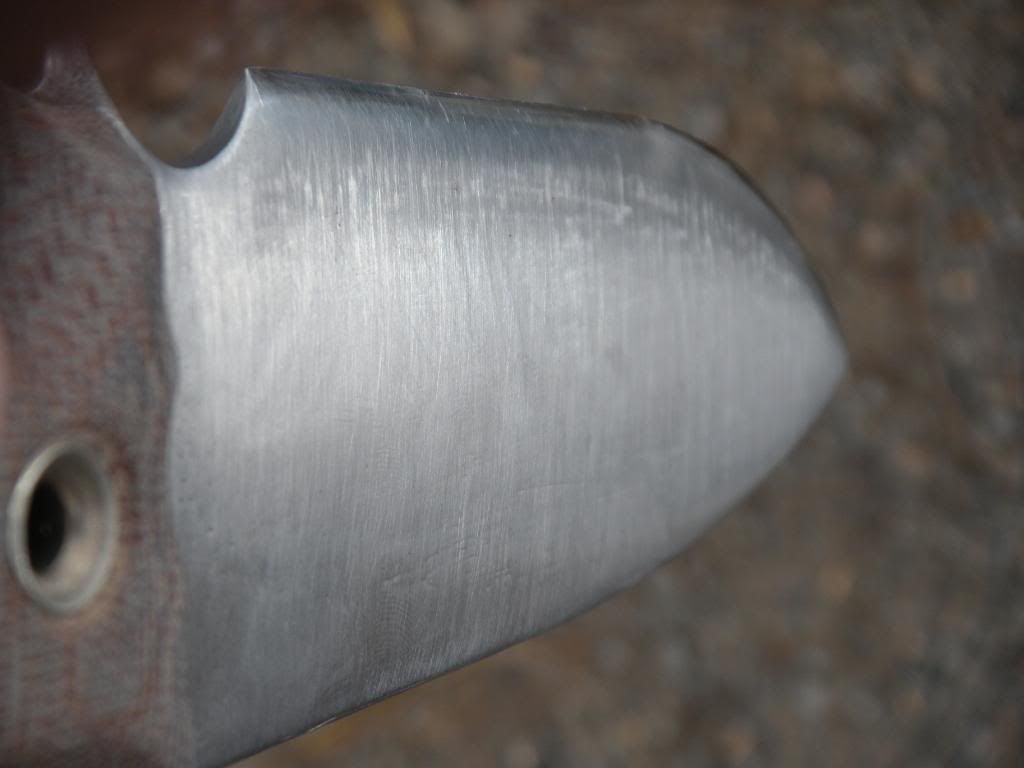

I put a full convex on an SASH1 by hand and it does take forever! The INFI on certain knives seems to vary in dimpling. When I stripped the ASH it had over half the blade covered in dimples like these.
I didnt take any photos of the blade before I set out sanding the blade.
To get to the finished product by hand took about 15 really solid hours of sanding.
This shot is about 10 hours in.....
Final product..........
