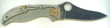

I've had my Kershaw/ZT0301 for a little over a week now, and it appears that the larger bronze washer is eroding from the blade's motion when closing. Where the framelock and the blade meet when open, that piece of the blade is scraping by the washer when closing and slowly carving a 'scoop' out of it.
It's hard to explain, I need to take better pics of it:
10 o'clock on the large washer. Do all bronze washer/framelocks have this problem? Should I worry about it?

You should be able to see the washer thinning right here:

You should call Kershaw customer service. They are great! And you may discuss your option - the new washers or new knife. For this price you may ask for perfection and I am sure they will deliver it to you.

That doesn't look normal. Vassili is right, call up Kershaw and they'll take care of you, their customer service is top notch.
Yeah I linked to this thread in the main Kershaw Knives thread. I've seen Thomas go above and beyond and I'm not worried about it if it is a warranty issue. What I am worried about is if it's a design flaw with the knife or model itself. You can see bronze scrapings and dust on the washer side of the blade lock above. The glinty bits next to the worn washer = bronze filings.

Well, I tell ya. I'v switched to teflon washers in all my knives due to similar observations. I used to use nothing but PB washers in all my custom folders and rebuilds. Here in the last year I've had a few come back to me for other work. One was a custom I did about two years ago. The customer decided he wanted a low rider pocket clip on it now and it didn't have a clip at all before. I got it took the clip side scale off and got inside the folder as I normally would to do a clip for tip up right hand carry and the pivot looked horrible. I didn't document that one, just cleaned it up and did the work sending it home. Then it happened again with other knives.
Recently I got a Stretch in that I redid in titanium liners, PB washers, and of course reused the original blade. He wanted new handle scales on it to replace the old Micarta ones I did. Here is what I saw when I got inside it in these two pictures. This knife was used for food prep, rinsed under the sink, and treated as it had always been treated. It didn't show this the last time I took it apart when it was still the factory set up and had no washers.
Alls I can figure is that its some kind of beginning stages of galvanic corrosion taking place. The other thing I now know is that by replacing the washers with Teflon the problem goes away. I have four knives I know of now that I've replaced the washers in and kept up with over time. None have had this reoccur after replacing the PB washers with Teflon washers.
So, what does this mean? Well, sometimes you have to go where the facts lead you I guess. I'm not saying I know for sure but for me the path of least resistance and the easiest cure was swapping the washers. It seems to me PB washers are no good on kitchen use, food prep use, tactical or outdoors folders or survival folding knives. I'd measure the washers thickness using a good digital caliper and find some the same thickness from Texas Knifemaker supply, Jantz supply, Knife and Gun finishing supply, or Sheffield supply that will fit your pivot diameter and swap them if you are seeing this in your folders. Its cheap and easy to do.

Oh yeah. Here is some info I found when researching it. Just a quick paste.
"What causes galvanic corrosion?
For galvanic or dissimilar or electrolytic corrosion to occur, three conditions must be met:
the metal join must be wet with a conductive liquid
there must be metal to metal contact
the metals must have sufficiently different potentials
So, look at your particular situation. Does the product have the above going on? If so make the necessary changes to insulate the metal to metal contact or reduce the risk of wet conditions or both."

If you note the Stretch picture above of the full knife you can also see very small signs of rusting taking place on other areas away from the pivot. This indicates there may be issues going on between stainless and titanium that have nothing to do with the washers. So it is possible that some minor effects could be seen if there are metal to metal, with water contact between any dissimilar metals I guess. Live and learn. I've heard some say that anodizing the titanium helps but I have my doubts about that. Its just best to replace the spacer/spring holder with a same metal material and do the best you can to keep the other areas dry where two different metals meet.

Anodize for things like aluminum and titanium are electrically built up layers of oxide. Many metals are corrosion resistant due more to the oxide layer than the metal itself.This is true of stainless steel and there is a 'passivation ' treatment to build up an oxide layer on stainless but I don't know how often it's used on knives..The will be a difference in the electric potential between a bare metal and one with an oxide layer and a good galvanic series table will show this ....With the very short life of the knife shown by diversionmary I would conclude it's just wear not a galvanic corrosion problem .I would look for dimension problems and/or rough surfaces.

Looking at your photograph and hearing about the "chips" and such, it seems the prime culprit would be the edge of the blade that bears on the cut out portion. As this is the "high side" of the lock, I would lightly chamfer the edge where it bears on the washer to avoid any further cutting of the washer . . . I'd also ask Kershaw for a new washer.
Just lightly break the edge with a stone or some 1000 grit paper then polish it a bit so it no longer cuts at the washer.
Of course, it could be a design flaw in which case I would recommend purchasing a couple dozen washers and simply replacing one when it shows wear.
