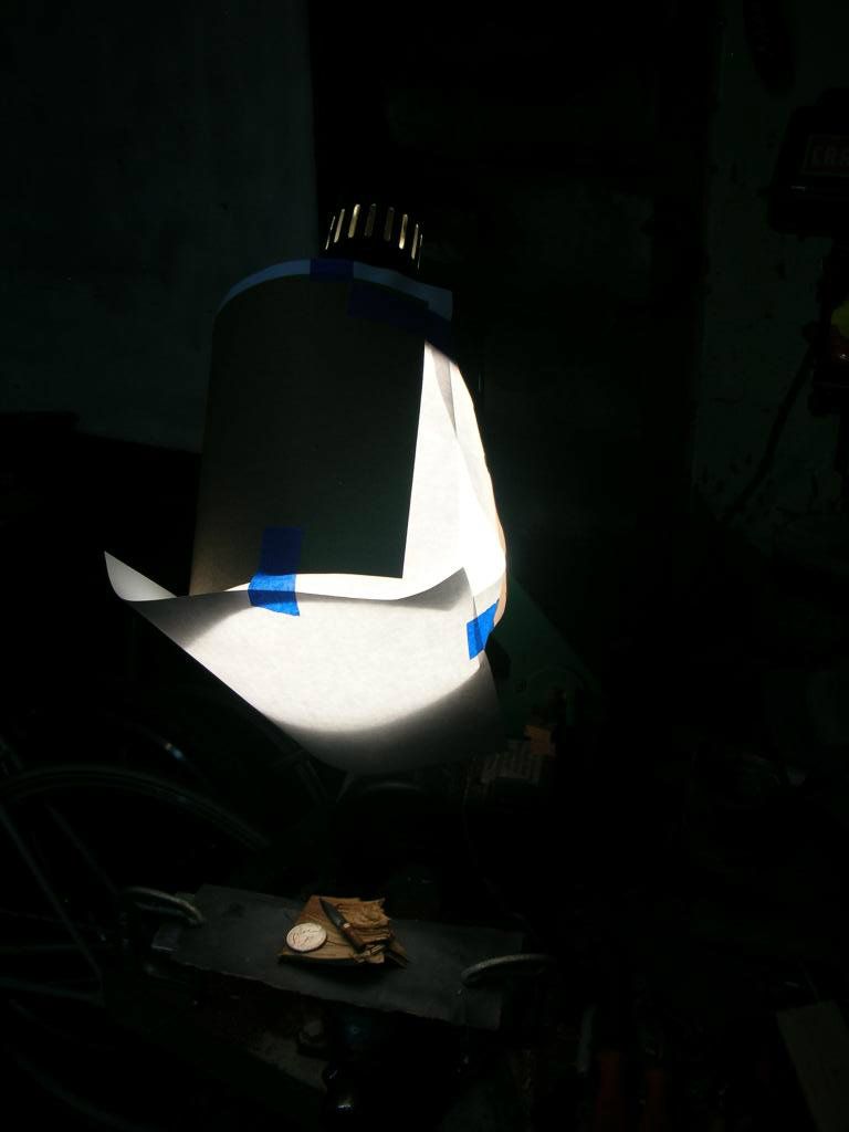

Here is a shot of my work using mixed light, artificial and natural. This is basically how I would take my pics before.
The softbox was two pieces of cardboard taped together with white paper inside and a sheet of paper over the front. 100w incandesant bulb in a white lined metal housing.
So here are the results. Sorry for the dusty dirty knife, the shop isnt the cleanest place to take pics!
On the second image of the hawk and knife I know I got a slight vignette and too much light falloff in the left hand side, and I could use a reflector to light the front a bit more, but overall I think there is a huge improvement in my image quality.
-Xander
Your original photo, although clear, is flat as a pancake. No depth.
You have already seen what I see: Not enough light into the set. Use a reflector of any form to push more light back.
The little mini is as clear as can be.
The larger the object, the harder it is to get even lighting.
Prop those tips up. Leave a shadow around the entire blade and don't let the blade angle off reflecting the darkness.
Good stuff. Keep at it!
Jim
Thanx Coop! Excellent advice about propping the tip up. I never noticed it in your pics, but it makes the difference between your work and ametures like me. This set above was shot hand held with my Nikon S1 point and shoot. I metered and preset my white balance for the lighting. I will try a couple more shots tonight and post here to see what I can do.
Thanx!
-Xander
