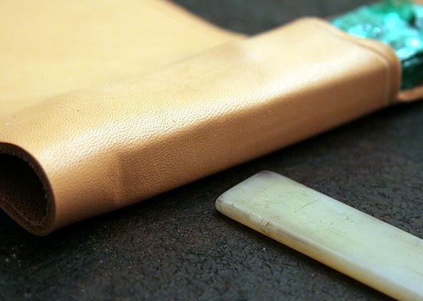

Patterns, I recommend using the small bubble wrap plastic to figure out how you
want the sheath to wrap around your knife, not all knives work well in all sheaths
so the knife is key, I've turned down some work because of the knife, but that's
just my style of sheath making, very tight to the contours of the knife.
I wrap the knife up with saran wrap to prevent moisture from weeping onto the knife

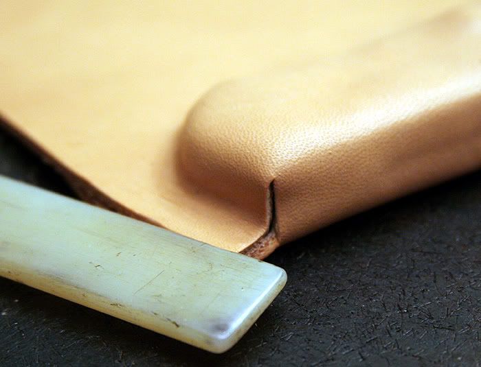

I wet my leather under HOT water until it's pliable, wrap the leather around the
knife and then using the bone folder, start shaping along the spine until you
get to the end of the knife, where it will make an indent;

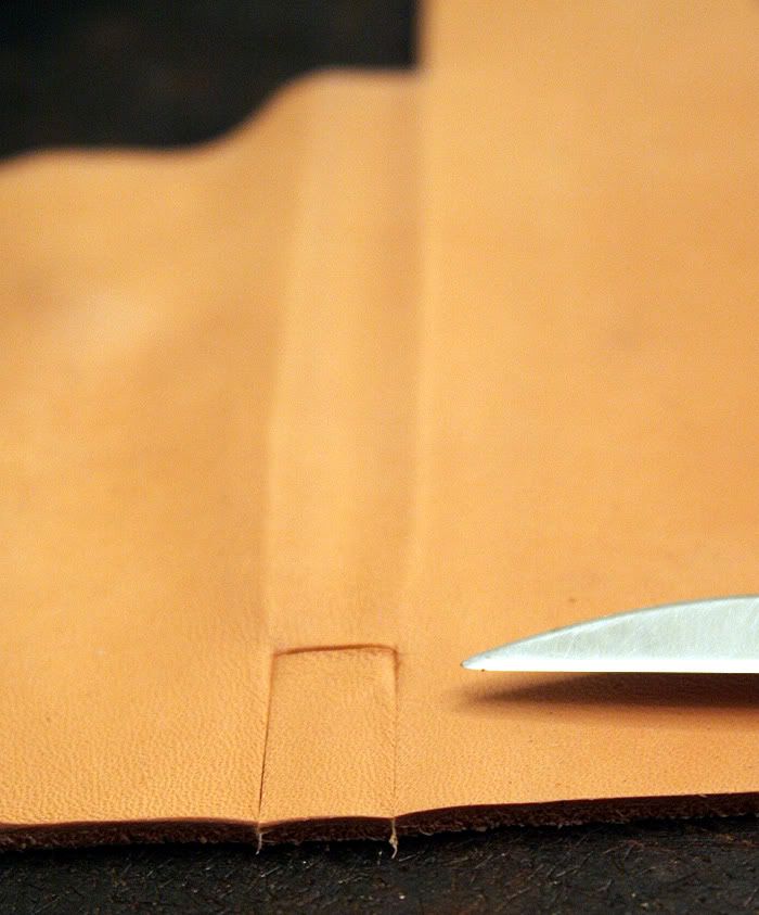

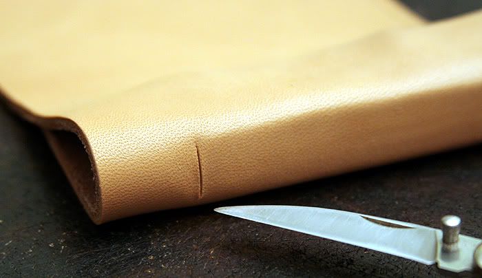

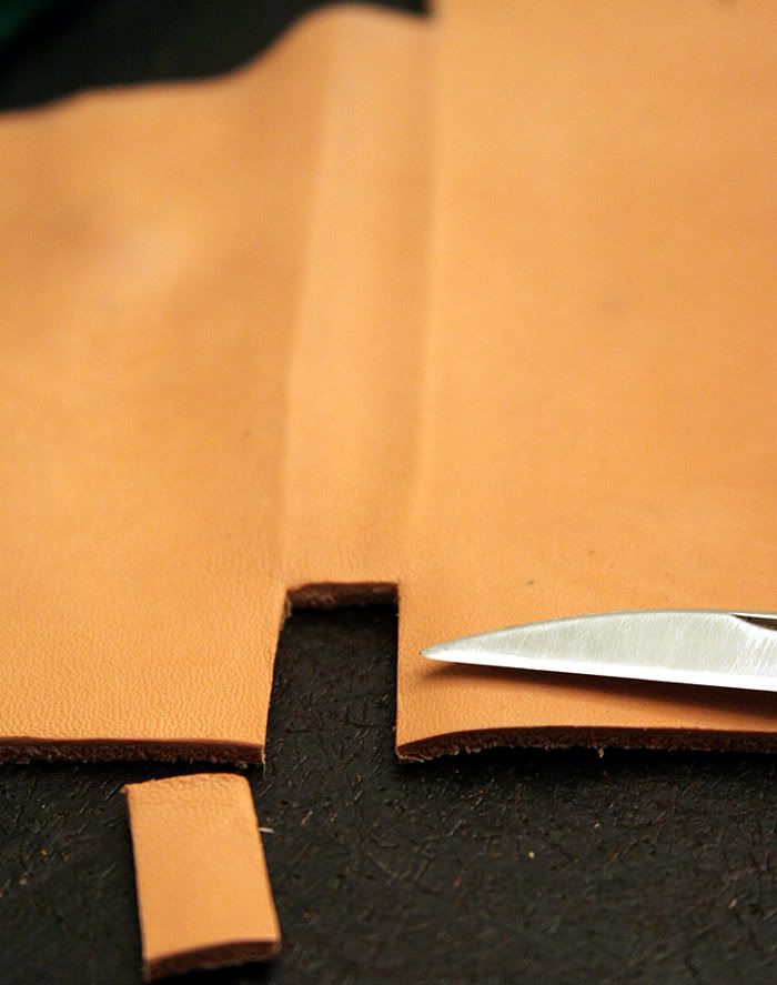

Where the leather dimples in, I cut down there, as you need to remove a
small piece of leather so it will fold down tightly without puckering
Then tightly form around the end of the knife

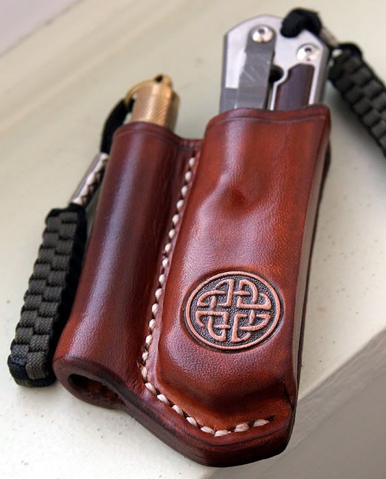

Didn't have any other in process shots of this, but here is the finished sheath
it's one that I do not take orders for, the old combo deal, sorry guys, but it may give you
something to try your hand at doing; All one piece of leather with one exception
inside the bottom area of the light side, I glued in a small strip of leather, this prevents
the light from passing all the way through, easier and much cleaner than trying to squish
it closed.

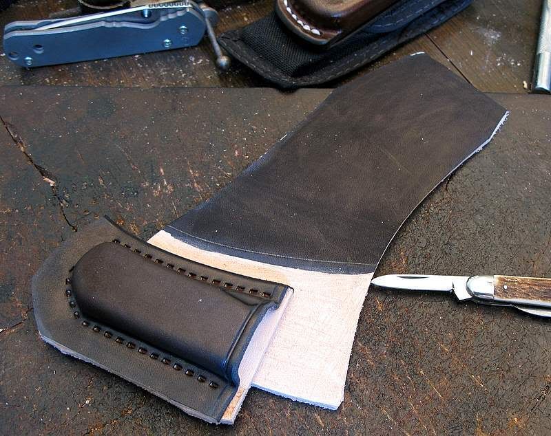

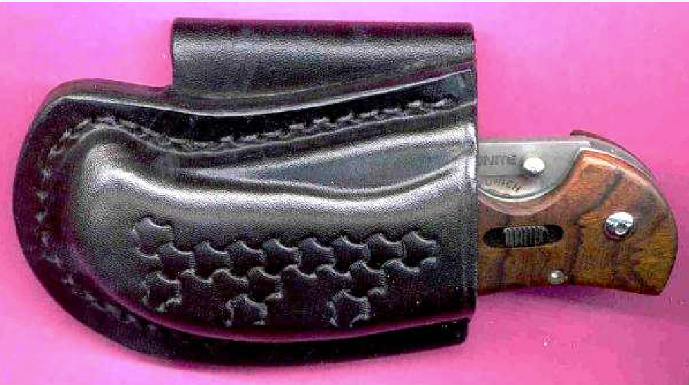

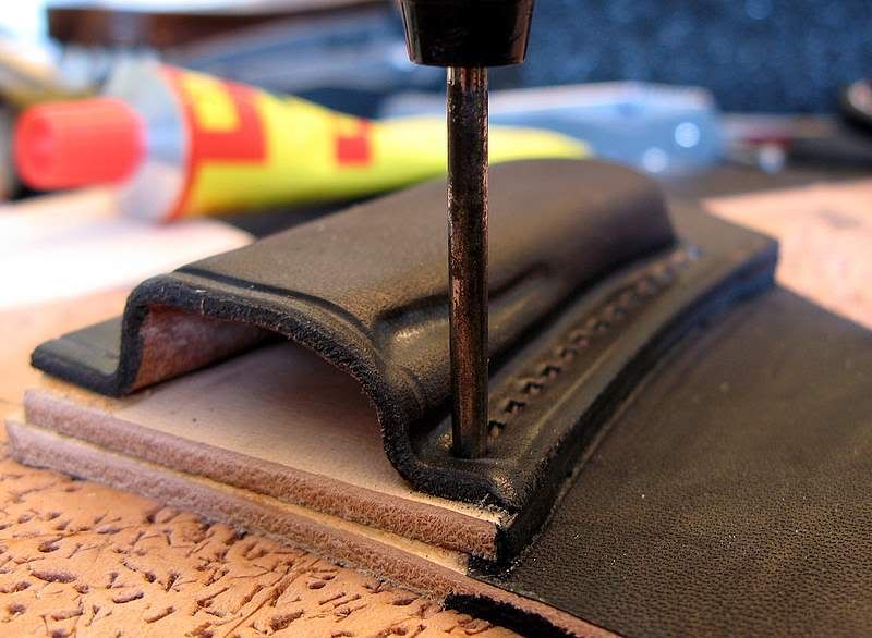

Horizontal sheaths and embossing stuff;
These sheaths take a bit more time and material to do, as they are
not made from one piece of leather;
Form the top section using the bone folder and then glue it down to
another piece of piece of leather, then I put holes around the sheath
and then trim to the final width along the top.
those two will be glued onto a third piece of leather that will be a backing
and belt loop.
The leather needs to be ROUGHED up in order for the glue to adhere properly
I use a small knife to rough up close to the line;
EDITED to say that I've since changed from Barge to Weldwood contact cement, you can get
it at Wally world pretty cheaply and it works VERY well too, wish I had tried it years ago!!!
I use Barge Cement to glue things together, apply on both sides and let
dry for 20 minutes or so, not TOO heavy, no big globs!
both sides

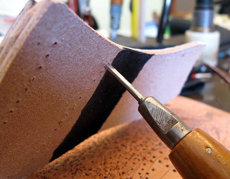

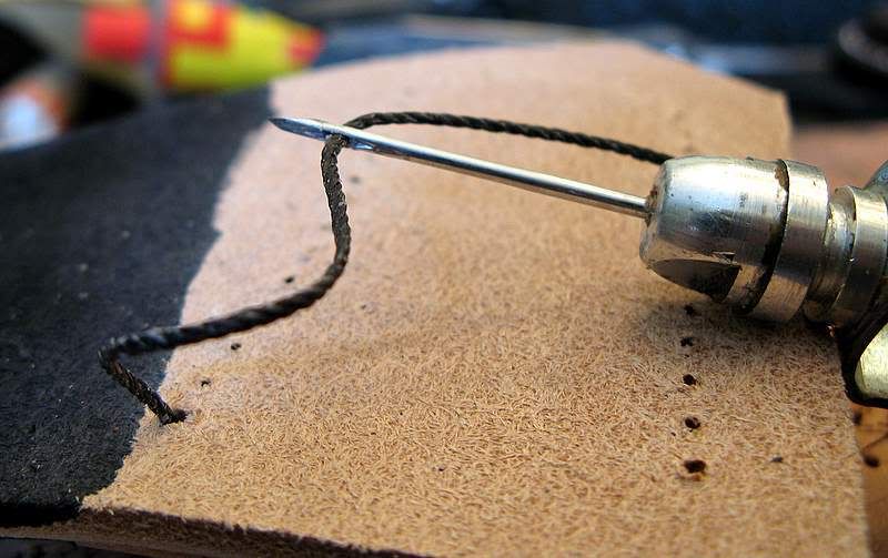

I then punch the rest of the way through the third layer of leather
use the one awl to enlarge the first hole to start the thread

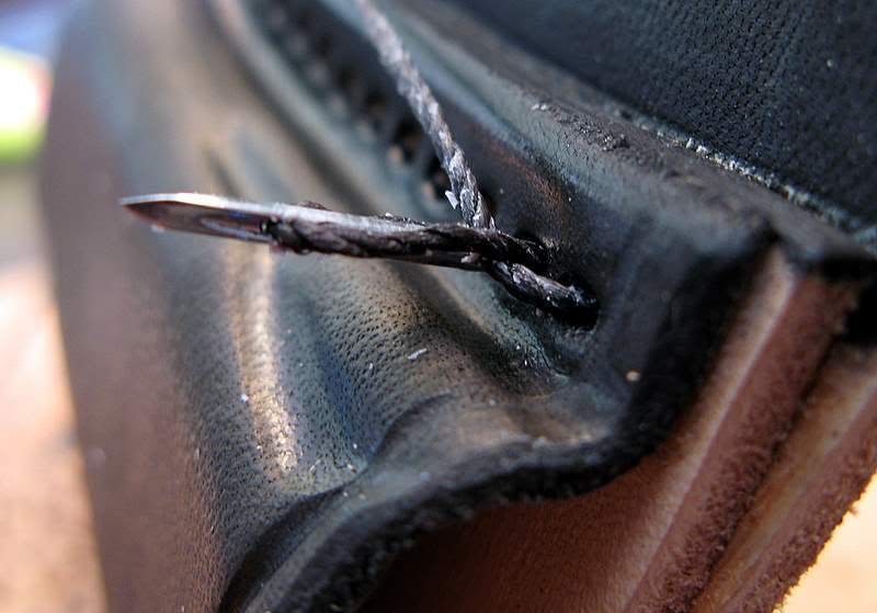

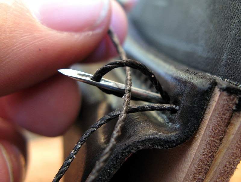

Sew n Awl threaded
I use a little more than double the length of the path around the sheath for thread
and pull one side through the sheath so you have one half of the thread on
each side of the sheath.
Push the needle through and pull back to form a loop and insert the one thread
through that loop
Then pull tightly
it'll come through on the other side, I then pull the knot back into the middle of
the leather

One thing that always puzzled me about these sheaths: Isn't the "bottom" layer (between the top and loop layers) expendable? Couldn't we just have the top layer and have the bottom also be the loop layer? It would mean we'd need less leather and less layers to punch through (less bulky sheath in the end).
Does this makes sense to anyone else? Any reason for the 3 layers?...

First off, welcome to BladeForums !
and as to that extra layer of leather, it is something that I decided a very long time ago to add rigidity to the overall fit of the knife in the sheath.
Imagine, the top section is formed very tightly over the knife, it holds the knife securely. Now, below the knife is a layer of leather, remember it is just leather and can also move, or expand, so in time that great retention can loosen up and your knife might not be held as secure as it once was.
With the addition of that middle layer, it reinforces the backing for the knife, so the sheath doesn't expand as it might have without it. It offers some structural integrity at the expense of a little bit more leather and a little harder stitching, but I feel that it is worth the effort and for that small layer, it really doesn't make the sheath more bulky. Without it, I would fear that the knife may come loose in time and during carry, it might come free of the sheath, something no one would want to have happen.
So yes, more work but overall it is a stronger better retention acting sheath.

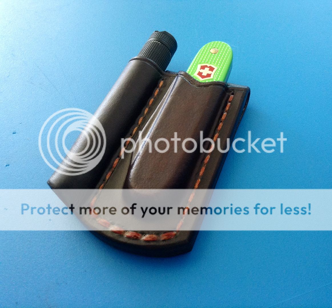

Gary, Love that knife/light combo, but no matter how many times I look at that picture, I just can't visualize the contruction. Could you show us another angle? Or does someone else have a different way of describing the construction? Not really good with written directions, very visual in my learning. I would love to tackle something like that. By the way, what type of light did you use?
Every time in view this thread I'm reminded about how this is one of the best threads here :thumbup:
Combo sheaths are really cool and I've made a few now , but none get even close to Gary's workmanship and style .
They are a challenge , but totally doable with thought and patience .
The type of Flashlight is important and I've found that straight sided ones with no taper or flare to the lense end are the best .

As to the how on that combo, I don't have one at hand to take a photo of for you, but let me try to explain it maybe a little better.
It was made from one piece of leather, I recommend using some bubble wrap to work out the form and how much leather you will need. The smaller diameter type bubble wrap works best.
Picture that you have some leather the knife is laid down on and the leather extends out to the right side of the knife, also straight north of the knife is a section that is as wide as the knife is that will fold down behind the knife to form the belt loop, like seen here;
That section folds down tightly to the back of the knife and is sewn along the bottom

NOW, that leather that goes off to the right hand side, you will wet the leather under hot running water so it is supple, and you will bring that over top of the knife and form it tightly around the knife, removing that little block of leather at the bottom so it will fold down tight to the knife.
Once that is formed, THEN I'll wrap the leather around the light, as to what that light was, I haven't the foggiest as it was a customer's knife and light and made a long time ago. but basically you do your forming on the knife first and I usually will stitch that down so it's held in place as I form the light's portion. I will remove that stitching once the light's portion is formed.
The piece that goes around the light will wrap around and go about to the middle of the knife on the back, it will be glued to the leather on the back of the knife sheath and then you will punch the holes down the middle again to get through the leather from the light's portion. and stitch down that..
Now, the part that extended up from the knife will be folded down tightly and glued and sewn at the bottom of the sheath.
I don't recall who owns that sheath or I'd ask them to get a photo of it for us, it's been a long time ;)
And, I don't make sheaths like this, so time consuming it's hard to price something like this, but it takes time and patience.
