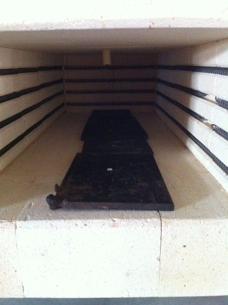

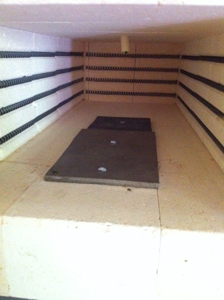

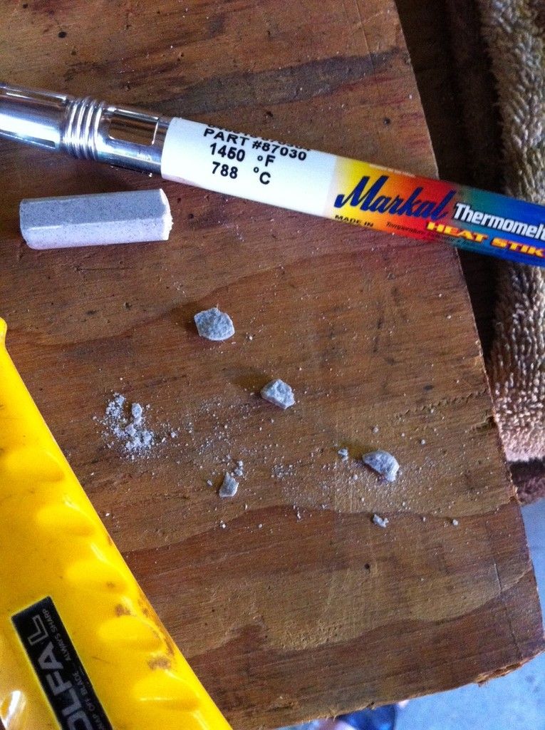

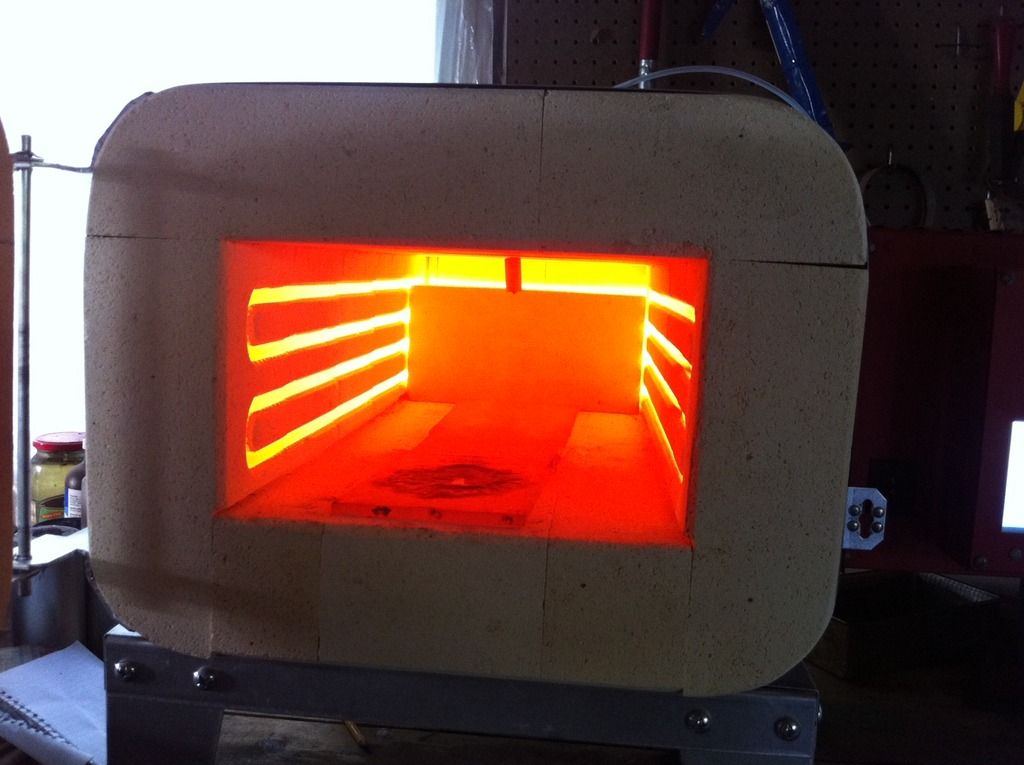

I got my 1450°F tempil stick yesterday and today did some experiments. From my hardness tests using W-2 I thought the oven was reading high so I started my test at the temperature of the stick or 1450°F thinking it would really be cooler than that in the oven. But what I didn’t realize was that I thought this because I was heating my pieces in the front of the oven.
I placed three pieces out of curiosity in different places. I have a 22 ½ inch Evenheat tap control oven and I placed one midway in the oven directly under the sensor and another 4 inches from the door and a third between those two. I expected that at 1450°F none would melt yet but in fact the one farthest in directly under the sensor melted at that temperature.
I cut off small pieces of the stick to place in the oven.
I then raised the temperature by 10°F and found out that the front one 4 inches from the door melted at 1470°F. So all I could say at that point was there was a minimum of 20°F difference between 4 inches from the front of the oven and midway because I don’t know where the midway one began to melt.
Realizing position varies in temperature more than I expected I then did a test placing five pieces with one in the center one at each end 4 inches from either end and then two others between those so basically I covered the whole length of the oven about every 4 inches with five pieces.
This time I lower the temperature to 1430°F which was 20° below melting point of my temp stick. To my surprise the back three including the center one again melted so obviously if I want to know the real difference from front to back I have to do another test but that tells me that from the center to the front is at least 40°F difference so from the front to the back I would not be surprised if it’s 100°F.
I think it’s kind of ironic that this company calls itself Evenheat because their ovens are anything but. I always thought it might be a problem that they have three sides with heating elements being the two sides and the back with the front door side not being heated. So the farther you go in the more heat you get.
It seems to me a solution would be to cover up the back wall so that way I would have two parallel sides heating and I would think the center of the oven would be the sweet spot and if I place the middle of my blade there it would fall off evenly in both directions. I have some one inch thick high temperature wool insulation good to 2300°F and I was thinking of putting a layer of that with a ceramic tile against that and then another layer of insulation and that way the back element wouldn’t be heating which I would think would make a much more even oven temperature.
My only fear though is that blocking off part of the element may cause it to overheat and burnout so at this point I am not really sure what to do. I find it frustrating that they sell a furnace with such a poor design; all they would’ve had to do was instead of having one big element that wraps around is to have two that just heat the sides.
Because if it is around 100° hotter from front to back as I suspect that means that the temperature varies about 4 ½° every inch so just a 10 inch knife would have a 45°F variance over its length. Pretty hard to get a proper heat treat especially when people agree that 10°F makes a difference with W-2.

Thank you Natlek for your assurance that I should be able to cover up my element without having it burn out. I know I am taking my chances and only have myself to blame if it goes wrong but I appreciate your opinion and the fact you know someone who has done it. I was looking online and I can get fire bricks about an inch and a half thick so I think I will make a wall out of them in the back of my oven to cover up the element on the back wall.

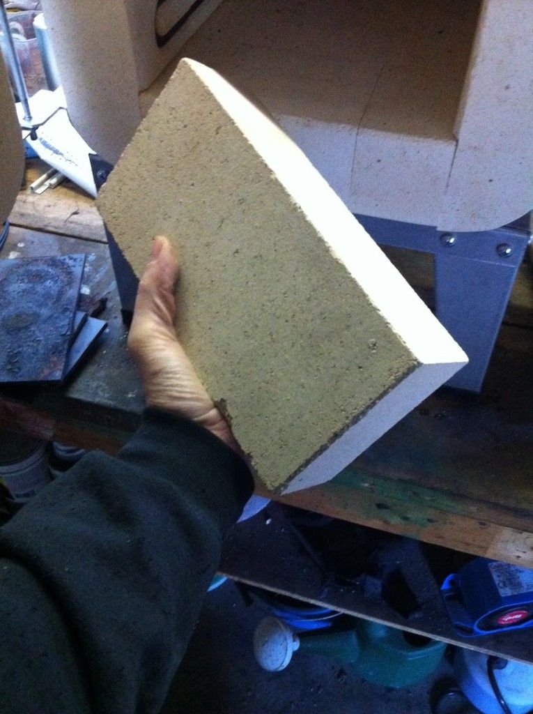

I’m thinking if I leave an inch or two of space between the wall I build and the back wall the elements won’t heat up too much and I was thinking of leaving a little gap at the top so the convection currents could disperse the heat somewhat but I wouldn’t have the radiant heat directly from the element. Maybe not a perfect solution but it should help. I might also attach some high temperature wool to the side of the wall facing inside the furnace for extra insulation.

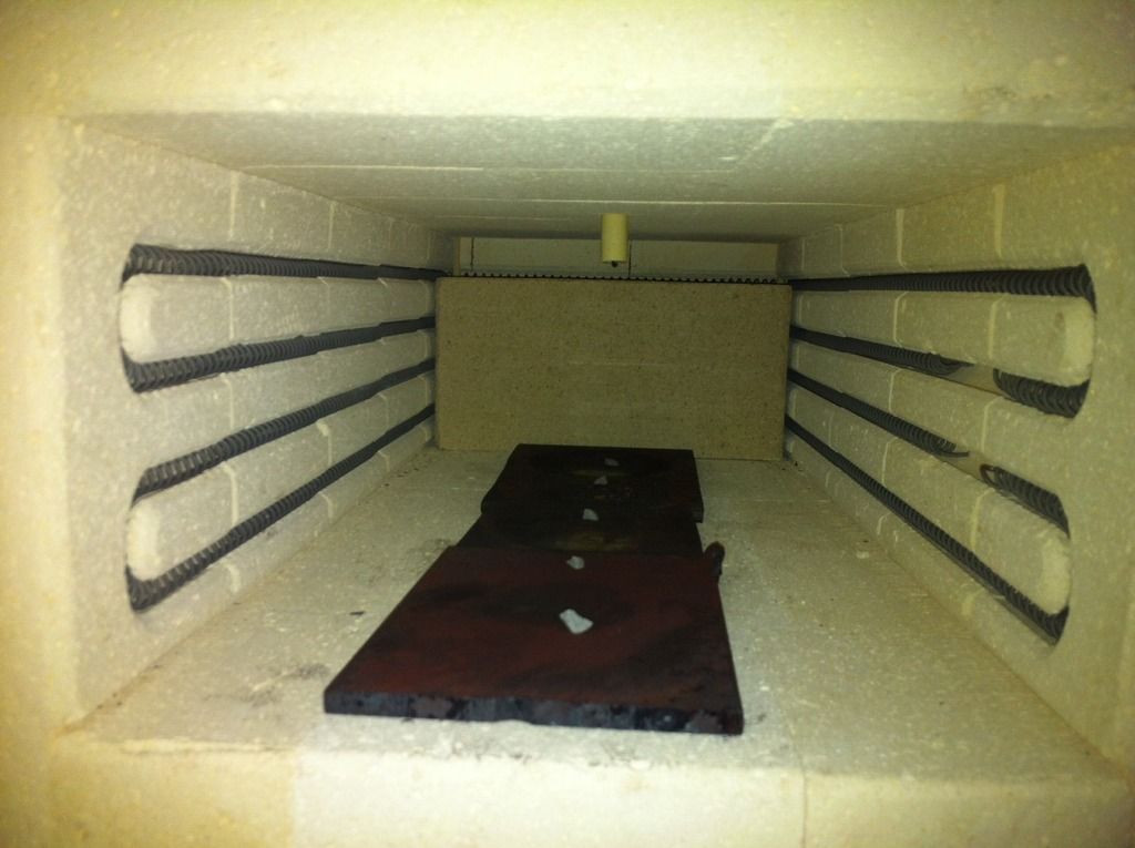

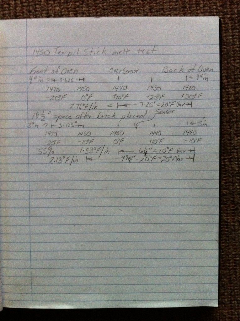

I retested my furnace with the temp stick doing the full-length this time and found there was a 50°F variance along its full-length with the worst section being the front section where it fell off 20° in 3 5/8 of an inch four inches from the front. The best spot only fell off 20°F over a 7 ¼ inch section coming to 2.76°F per inch.
I placed a fire brick in the back of the oven to block the rear element hoping that would even out the temperature. The brick is 2 inches thick and I left a 2 inch gap to try to avoid overheating the element so I lost 4 inches leaving me and 18 ½ inch space of usable oven as opposed to the 22 ½ for the first test.
This time the overall difference from front to back was only 30°F. The best spot which was 6 ¼ inches long had only a 10°F variation which equals 1.53°F per inch which is a 45% improvement over the temperature variance without the brick. This should be large enough to do most of my blades and a 10°F difference I think is acceptable.
For longer blades in a 9 3/8 inch section there is a 20°F variance which comes out to 2.13°F per inch. Not ideal but probably will produce an acceptable blade. If anybody is using and Evenheat oven I would recommend blocking off the rear element unless of course mine burns up rather quickly at which time I will modify my recommendation, LOL.
It’s not ideal but at least I know where I stand and what my parameters are so tomorrow I am going to test a few pieces of W-2 along the length of my oven to see how much the hardness varies. I have coated some samples with a skim coat of furnace cement to see if that will lessen my scaling and even out my hardness readings.
This test does answer why my sweet spot for hardening W-2 seem to be 20° hotter than most people and that is because I was testing my samples in the first 6 inches of the front of the furnace which is significantly cooler.

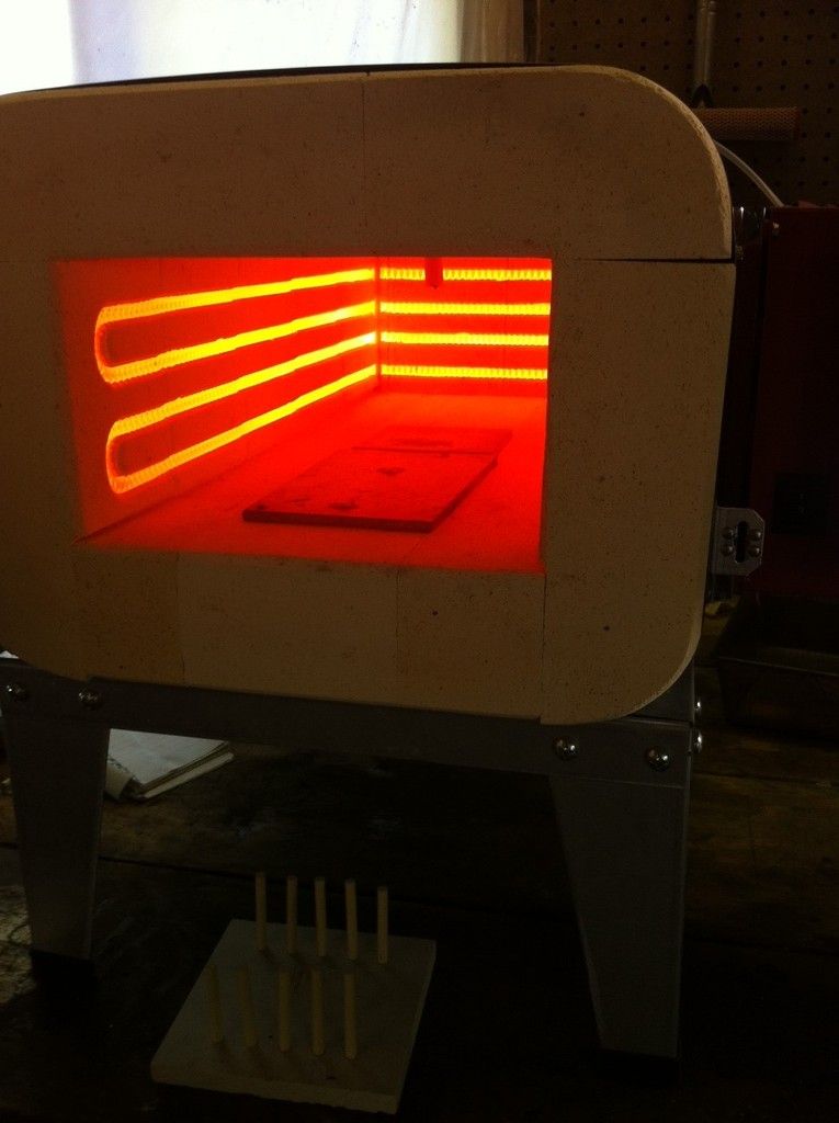

I actually started these latest tests at 1370°F and held the temperature for five minutes at each 10°F interval for five minutes after the temperature rebounded from opening the door to inspect whether my pieces had melted are not so by the time I got up to the range where they started to melt the oven was already up to temperature for half an hour so these tests are probably pretty close to what they would be if I let the oven soak for half an hour but I was opening the door to inspect so it wasn’t a true soak so I may test that better.
I am really tempted to do something I don’t want to do and that is to drill a small hole in the door of my oven because I have a pyrometer with a digital readout from when I was heat treating with my homemade natural gas oven. The probe has a very rigid wire and I know I could push it in and out the length of my furnace so I could find out the temperature variation throughout the whole oven without opening the door.
My fear is because I would have to use a hammer drill with a concrete bit I could possibly crack the bricks in my door but I think it is worth it because if I go slow and gentle it probably won’t crack and then I would definitively know what the variation is as soon as it gets up to temp and with a good long soak. I think I’m going to have to do this despite my reservations.
From these last experiments I do know that my pyrometer on my oven is actually quite accurate probably within 5 to 10°F because the pieces melted near the pyrometer very close to the melt temperature of the temp stick but I really am curious exactly how much variation I have so I think I’m going to do this today.

Interesting test with the tempilstiks. However, these are accurate within +/- 1%. At 1450F that's still 14.5 degrees in either way. Can we really trust these when shooting for such specific temperatures?
I think that's partly why Stacy recommends using 3 sticks. I have a 1450, 1475, and 1500. When I did my testing I found the point in my furnace where all sticks melted at the indicated temperature, and they were all within 10F. That was close enough for me because it resolved all of the issues I had with heat treating 1095 and getting variable results.
So it may not tell you the exact temperature you're at +-1F, but if your results are as expected and repeatable, that's really the point.
