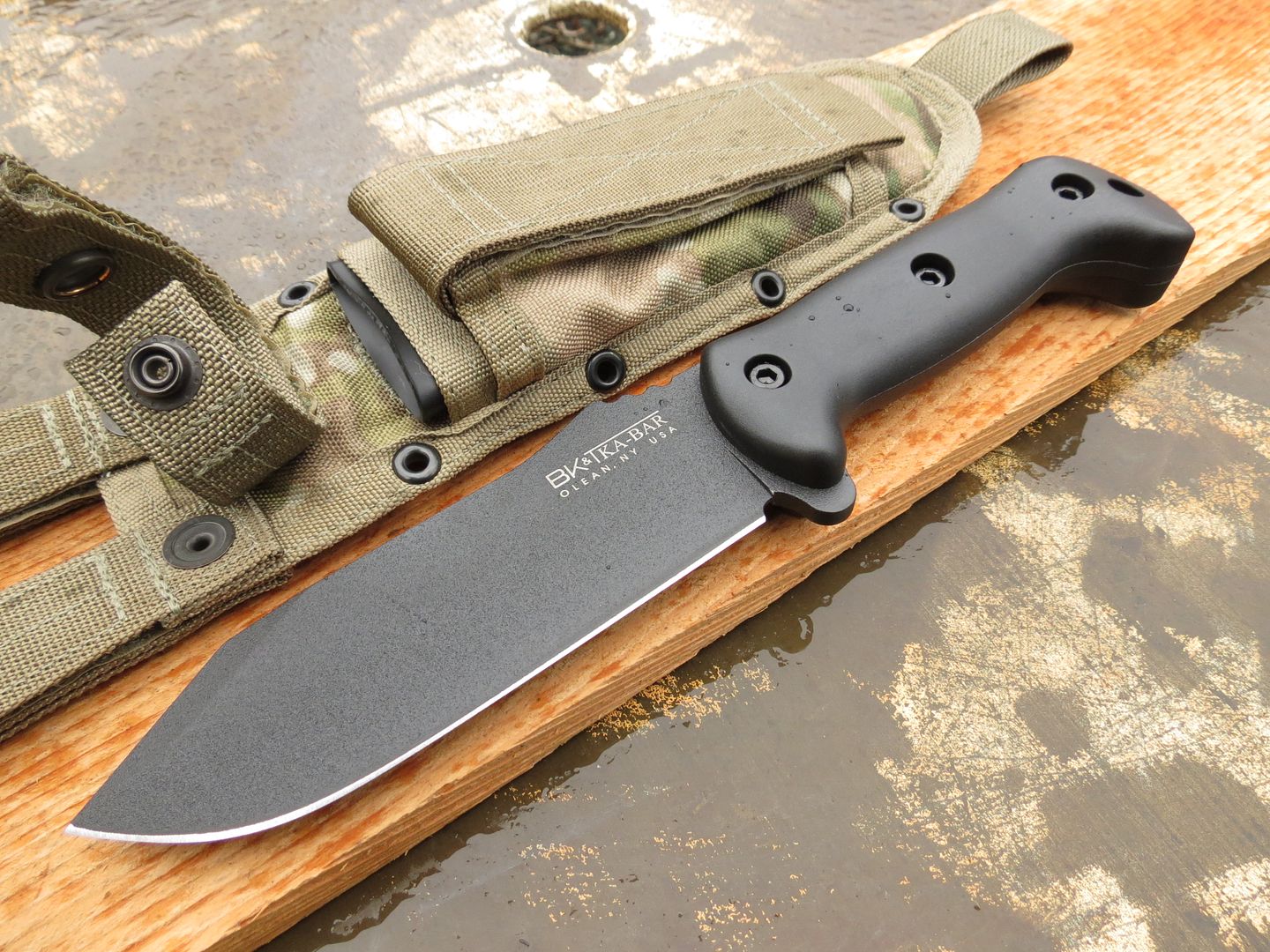

And on a very different topic, I'm also thinking about removing the coating on my new knife. :D

Though this is a topic that can be rather subjective, I, personally, do not care for blade coatings. Though it does provide protection for rust prone steels, it otherwise reduces the usability of your knife in other respects and use tends to make it look like hell eventually anyway.
That all being said, when I get a new Becker in the mail, I pause (albeit briefly) and experience the beauty of a new knife, coating or no. However, I have opted to remove the coating from all of mine.

Is that the sheath it came with? I usually do not care for the nylon sheaths but I am a bit of a sucker for "multicam".
I own about 8 Beckers at the moment, if my memory serves me, and all but this new 10 are stripped.
I'm almost certainly going to strip it, but like you, I do like to take a moment and enjoy a pristine, new blade.
This is actually my second 10. I still have my first, but I dislike some of the mods I did to it 5 years back. I removed the ramp, the guard, polished the flats and convexed the edge. This one is going to remain practically stock, save for the coating.
The sheath didn't come with it. It's a multicam Spec Ops Combat Master short. Just took the liner out and formed it to fit the ramp with a heatgun on low. Worked perfectly.

I used a heat gun on the low setting, and was very, very careful with it. I completely destroyed a 6" liner a couple years ago by over heating it. Damn thing shrunk down to nothing! Pro tip, don't use an oven!
All I did was carefully applied heat to the spine side of the liner, and (with my edge taped up to prevent it from accidentally cutting the soft, hot plastic), inserted the blade while applying pressure to the spine. As it cooled (only a couple seconds), I just moved it in and out for the length of the ramp, to open up a channel for it. I had to carefully reheat a couple times to get it perfect, but right now, it slots in easily and there's a few of millimeters of clearance on the edge side.
I'm very happy with how it turned out.

Love how the knife came around! That looks all business now, wow! Nice work Sir! What method did you use to strip it?

Much obliged. I used some Dominion Canada industrial grade paint stripper. Sprayed it before I went to bed and let it sit overnight at 3 degrees C. Ten hours later, and it barely touched it.
Sprayed it again and used a heatgun to speed the process up. Was done in 10 min.
