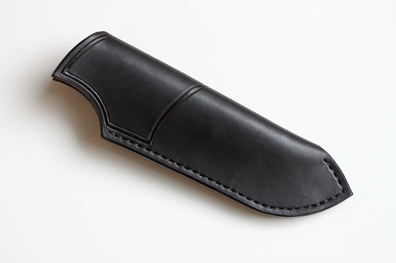

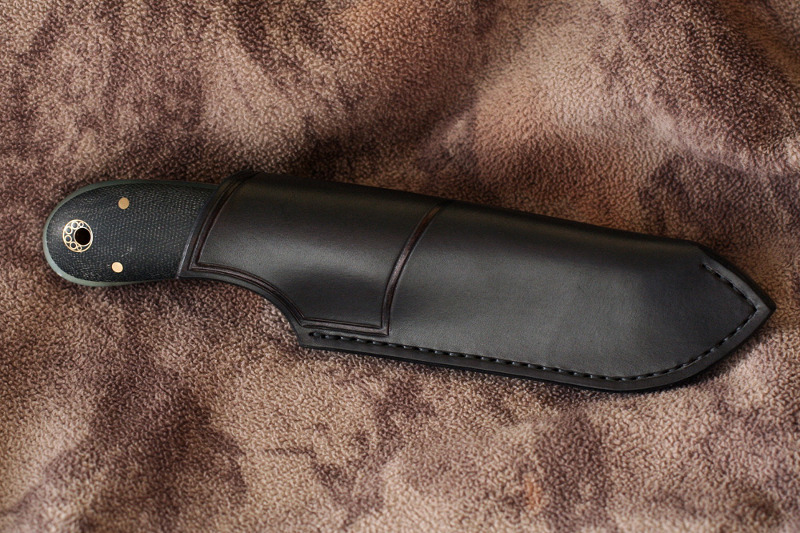

I have used it on few sheaths just to see how it works. Gave me colors from blue-grey to deep black. And yes it penetrates all the way through. It's the chemical reaction rather than dyeing. Smell was gone after few days. I have friends who used it for long time. As mentioned before, just add the wool and vinegar as time passes.
Here is an example
Mat
Thanks Matt, nice work. :)
Brings up a question though. I notice that you have brown on the sheath along with the black. Last night I was testing a scrap that I had dyed half of brown. I wanted to know if the chem reaction would change the dyed area, or if the dye might resist the 'groon. The test stamp was small, so it may be worth trying again (depending on yours and others experiences), but the 'groon completely took over the dye and blackened the entire piece.
How can I use this stuff with dyes on the same piece?
