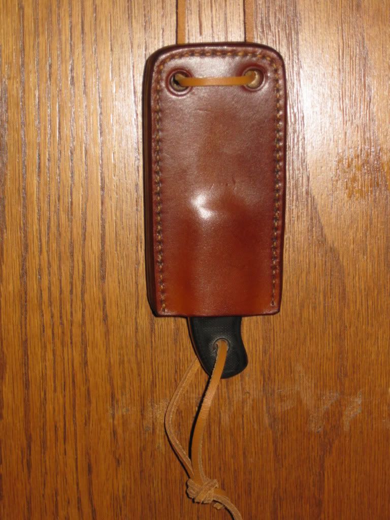

I don't mean to Bogart in here, just wanted to show you one I did using a magnet. Inside a discarded hard drive there's a magnet that usually about 3/4" x 1", about 1/16" thick and it is STRONG!! That is all the retention you see here with this Fiddlback Runt. It is sandwiched in tween two layers of leather, glued in place. This blade can never fall out, and it takes about as much pull force as a sheath having good retention built into the welt.

EDIT: Nice leather sheath...but I prefer kydex. HD magnets are way too strong unless you somehow, cut it into a smaller piece. At least with neodymium, you can get different sizes.
