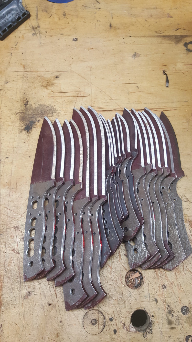

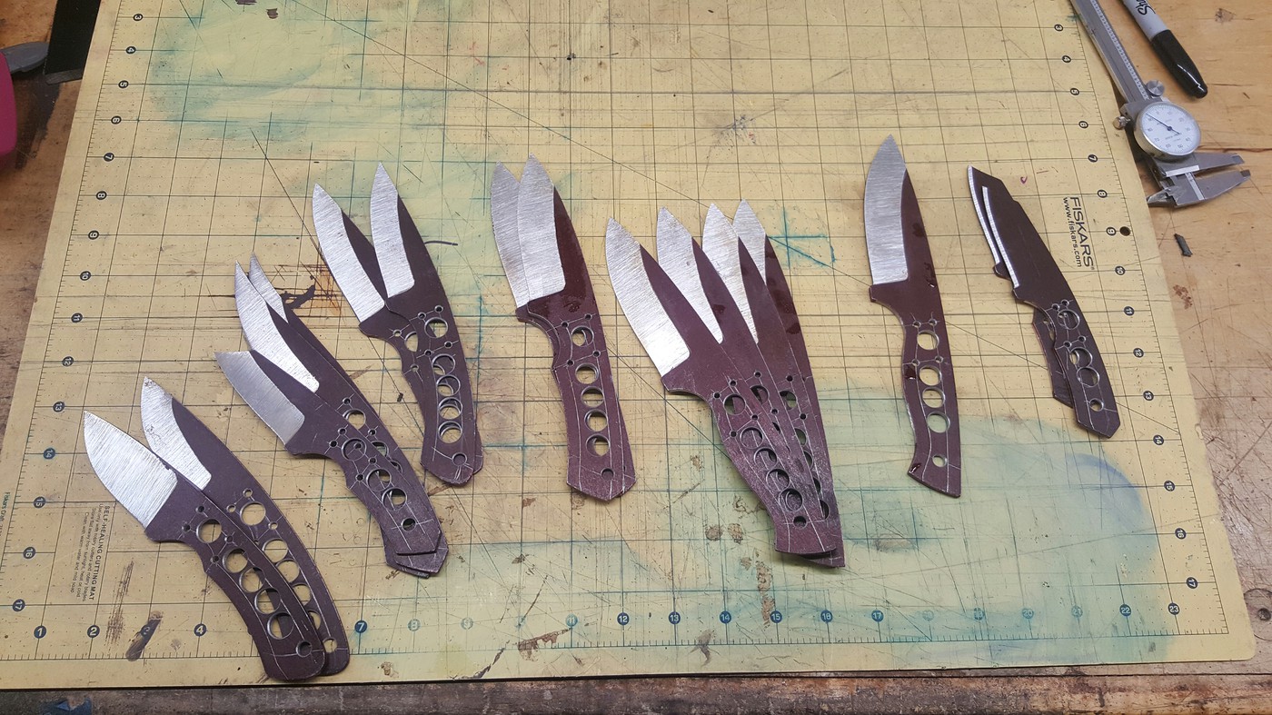

Here I have a Batch of 27 +/- a few scribed and ready for drilling. I start them in larger batches then break them down into smaller groups as I progress further in the process.
Hosted on Fotki

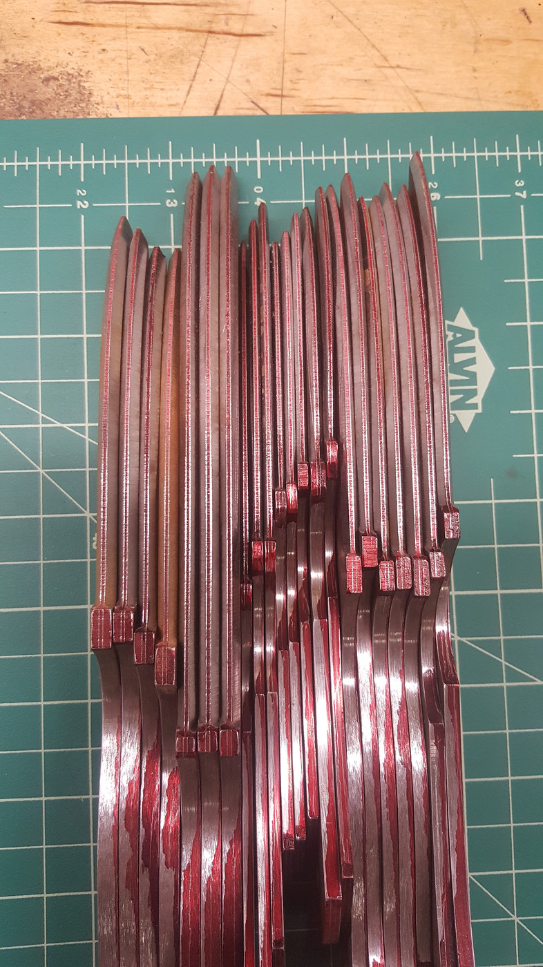

Here I am laying them out according to thickness to mark the grind lines for the bevels and tapered tangs.

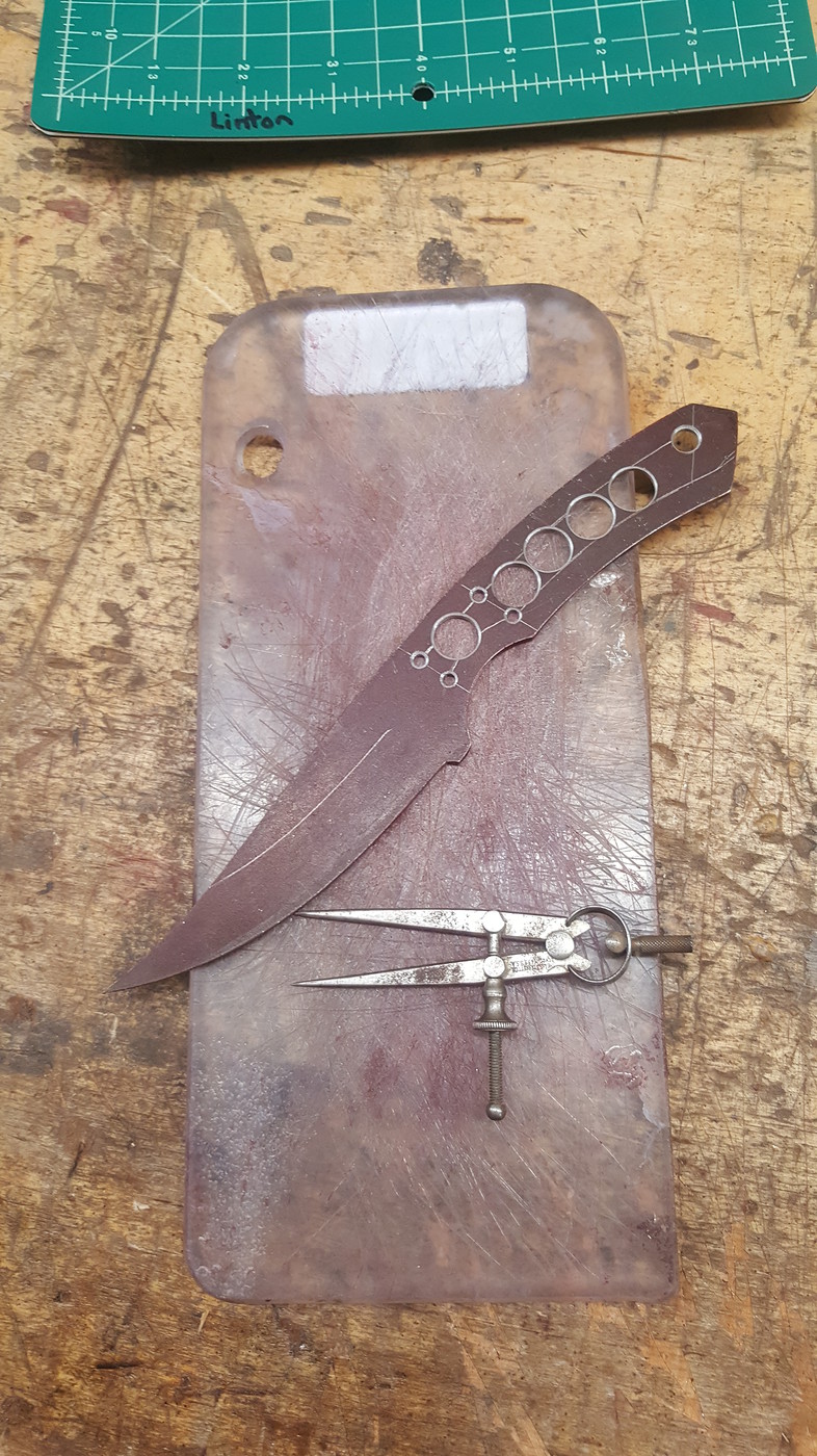

Measuring the thickness of the blade so I can caculate how thick of an edge I want to leave for heat treat. I vary according to the thickness of the steel and the blade type.
Hosted on Fotki
Hosted on Fotki

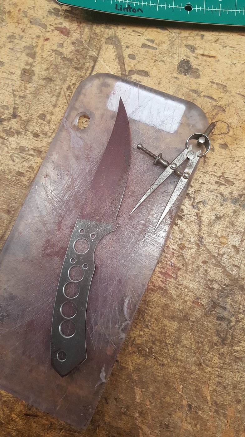

This one measured out at 0.188. I want an edge thickness before heat treat of .025 so I subtract that and divide the number I get by by two
Hosted on Fotki
Hosted on Fotki
Hosted on Fotki

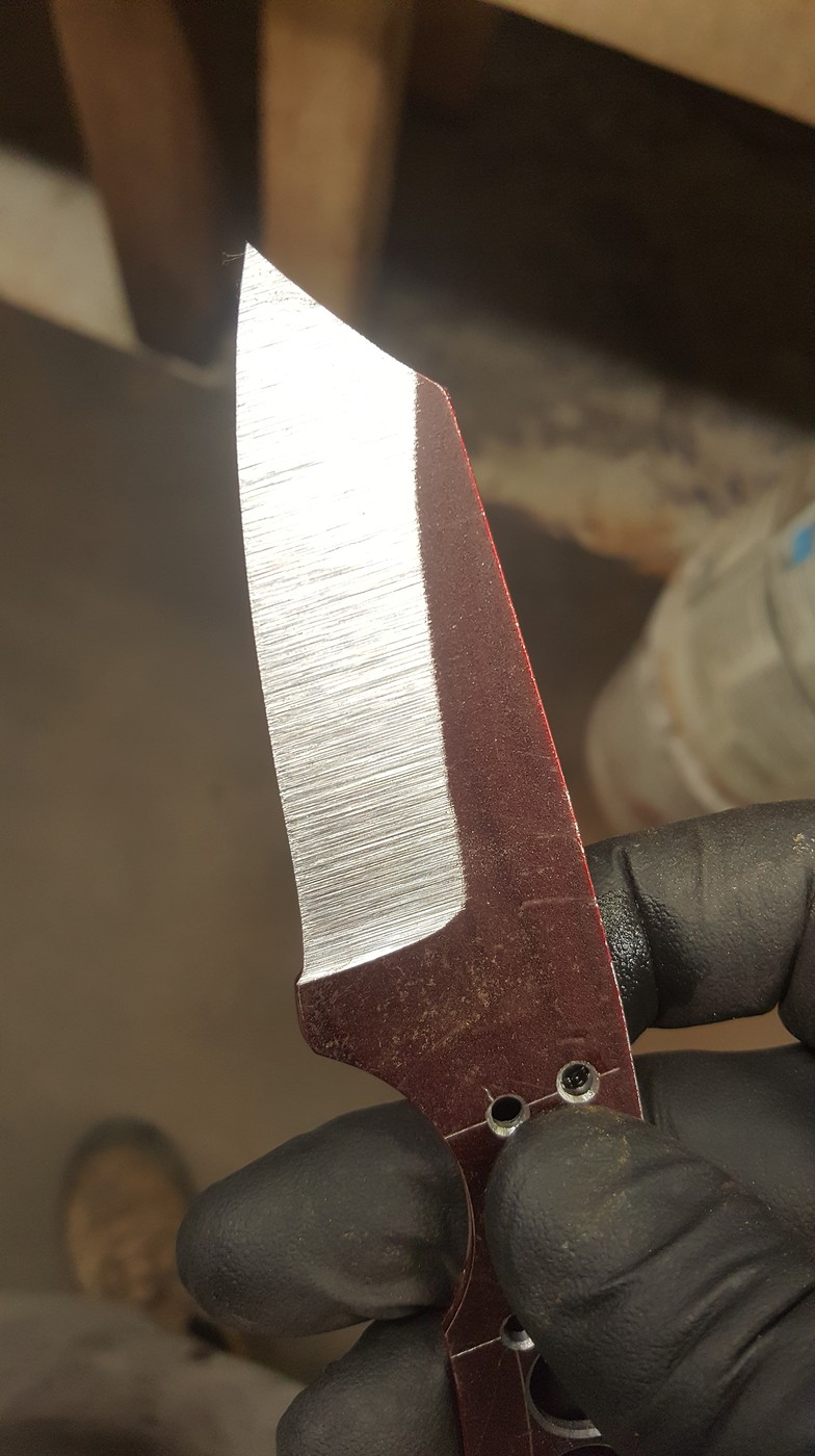

After I caculate my desired thickness I mark a test mark on the spine to see if it looks right.
Hosted on Fotki
Here is what is looks like when I am done. I will grind all the way up to these lines before heat treating.

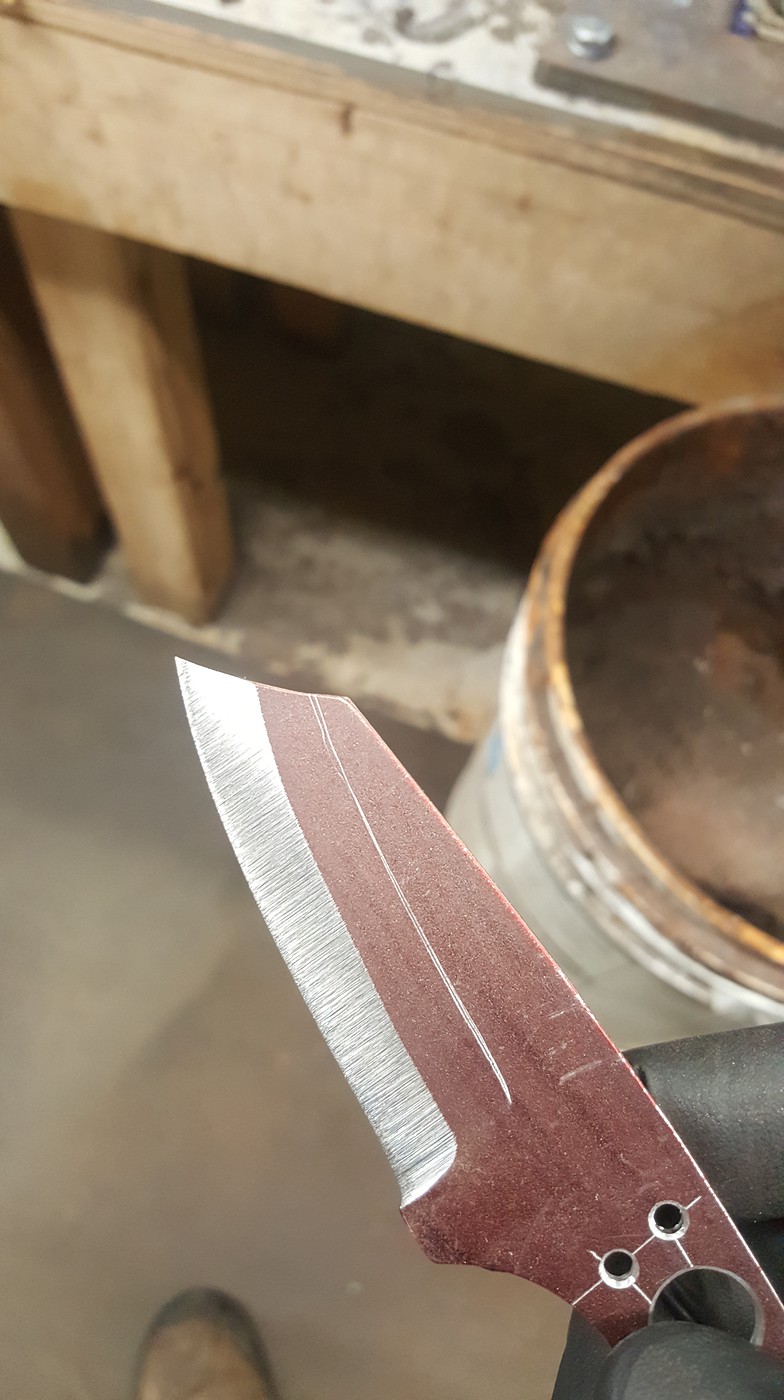

Update to the current work in progress.
I am going to try and pick up where I left off.
So yesterday I had the blades ready for grinding, the last step before grinding is to mark where I want my bevel to end on the knife before heat treat. Here is what I use just plain compass.
Hosted on Fotki
This is what is looks like. This helps me with uniformity
Hosted on Fotki

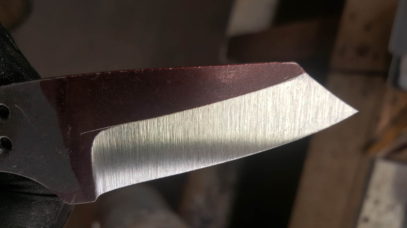

Next I use a dull 80 grit belt to what we call 45ing the bevels. This is just starting the plunge and making a short grind bevel on both sides. There are a couple of reasons I do this. First, the sharp corners on the blank takes alot of grit off and dull a sharp belt fast, and where there is no need for a sharp belt, I use a dull used one. Here is what it looks like when I am done 45ing the blades.
Hosted on Fotki
Another view, notice I didnt go past the scribe lines

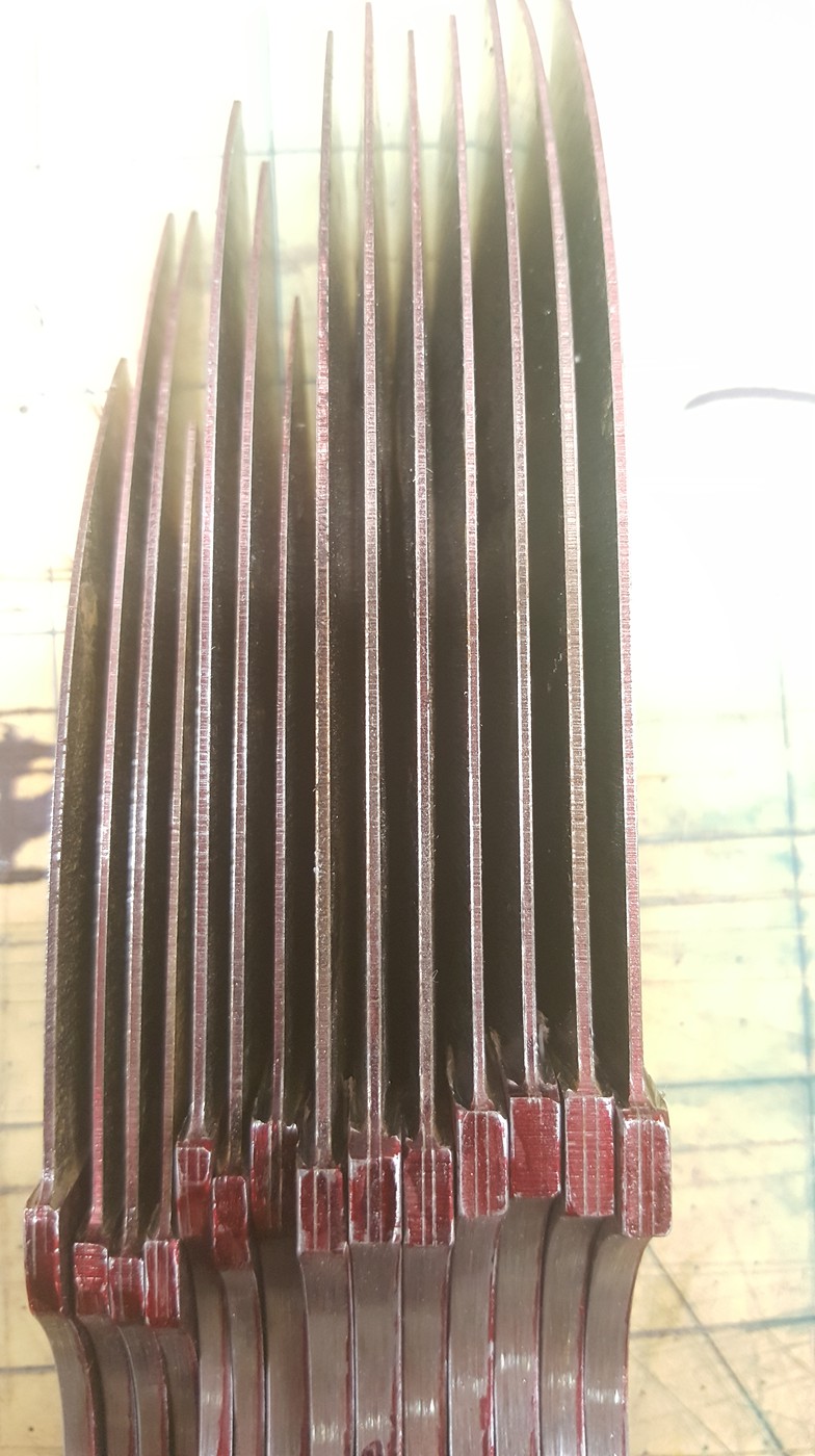

After I have completed 45ing all of the blades. I separate them according to thickness and shape. This helps me with consistency and uniformity. This part of the process is one that takes alot of focus. I free hand grind everthing. I like to compare it to driving down the free way dodging in and out of traffic at 100mph. It doesnt look like I am doing that much while grinding, but the speed at which I have to process the information in front of me and make fine adjustments in pressure and speed at the same time takes a similar amount of focus for me. It is mentally and physically taxing, but I enjoy it! I put my head phones on listen to some music and just focus on that and nothing else.
Below is what it looks like.
Hosted on Fotki
Hosted on Fotki
This is the what they look like after that step. The one on the far left told me it wanted to be full height.
Hosted on Fotki
Here if you can see it I was trying to show that I stopped at the scribe line. Sometimes I go past it but this gives me a guideline.
Hosted on Fotki
Here is another view on the pile I did today, I am showing that I still maintain the same edge thickness prior to heat treat and did not go over the scribe line.

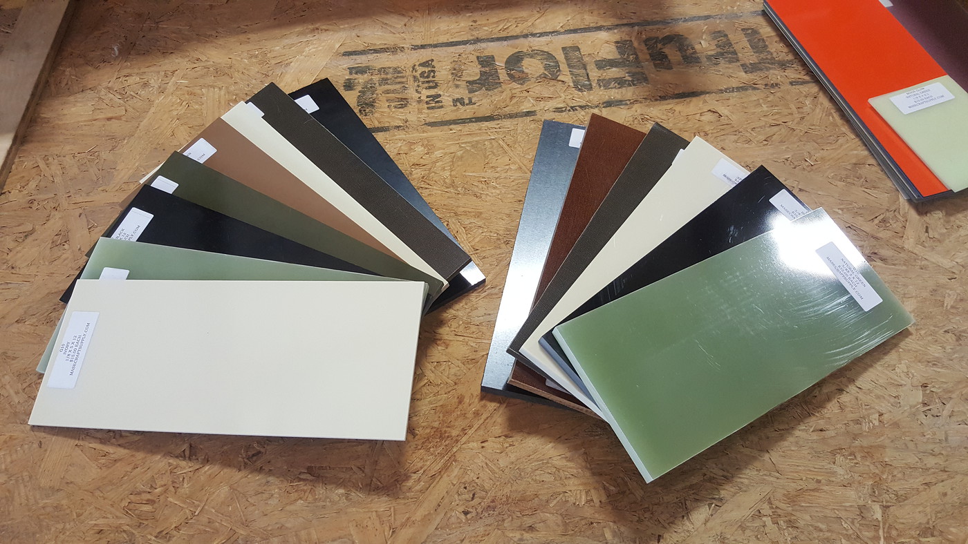

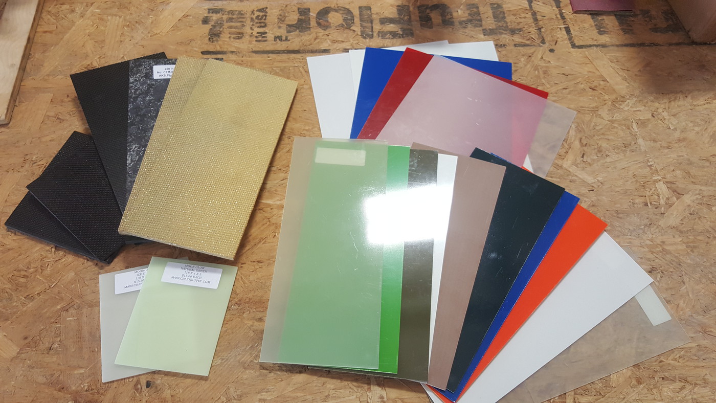

Here are some more material I ordered and recieved in the mail this week.
I already mentioned the material in the left hand corner in a previous post so I will skip over those. Top right corner we have assorted thickness of G10 liner from .014 -.030. Lower right hand corner is blue and green moon glow G10. I figured I would give it a try. Not sure yet how I will use it. Bottom right hand corner is assorted thickness of G10 base from .060 to.125
Hosted on Fotki
Here on the left we have assorted colors of G10 and Micarta in 1/4"
on the right assorted colors of G10 and Micarta in 3/8'

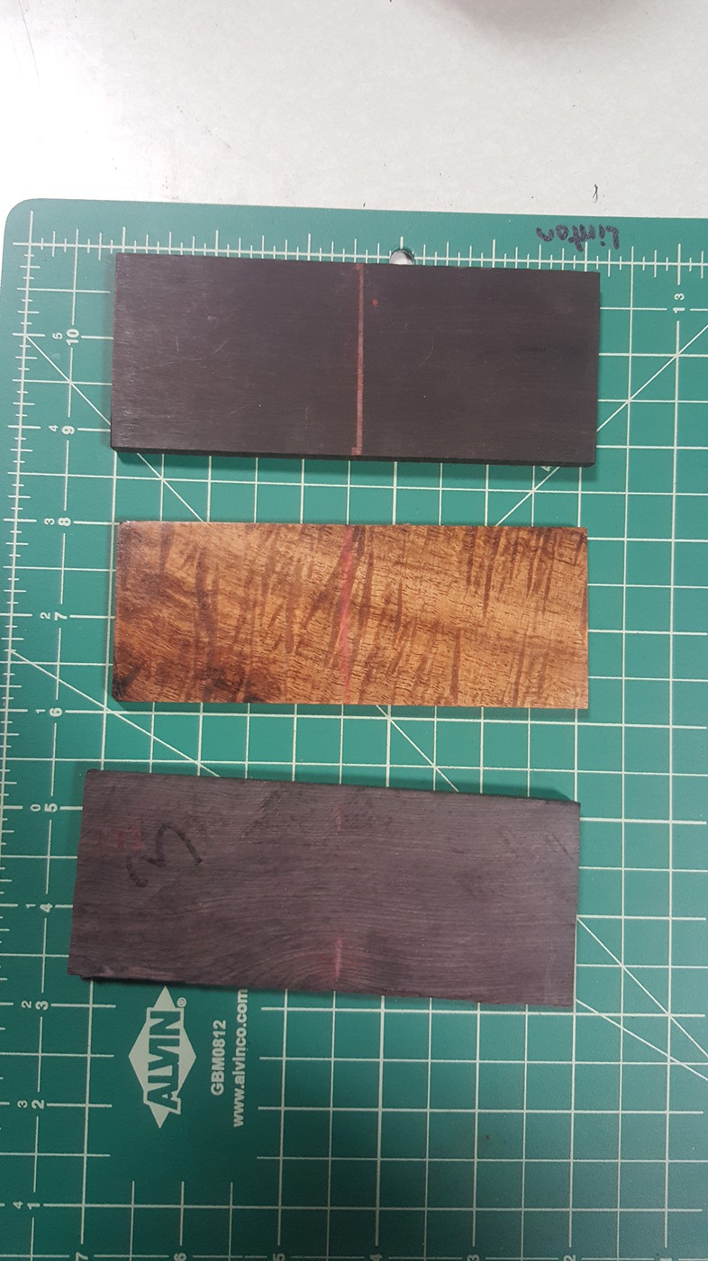

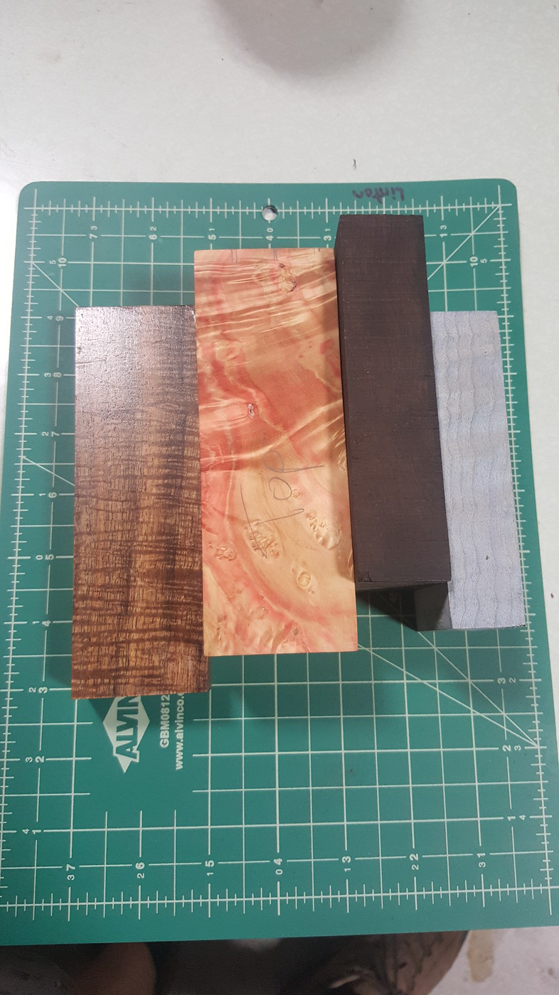

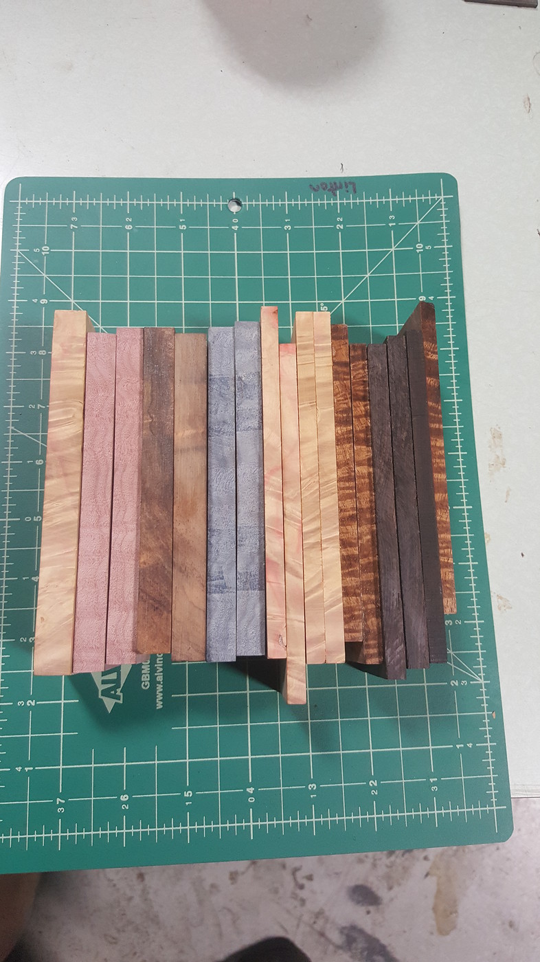

I am starting another part of the process here. This is where the handles begin. This description applies to wood, only in how I obtain it in the raw form. The steps are the same after I cut them to size for scales.
I start with a block of wood.
Hosted on Fotki
Next I have them cut to the desired thickness, this varies according to the knife and handle design.
Hosted on Fotki

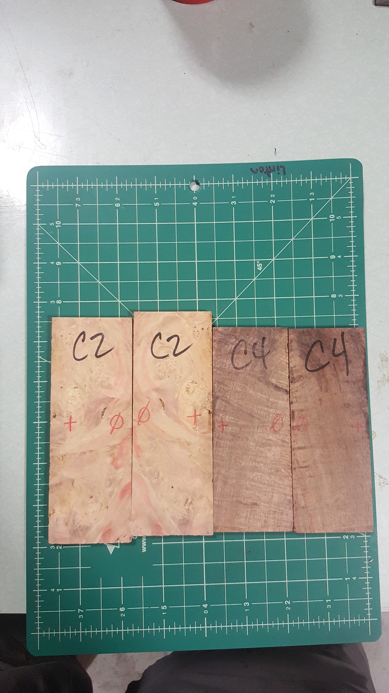

Then I take the match book set and I make corresponding marks on the sides. This helps me keep track of which side pairs up. I have noticed that it can be hard to tell on some woods in there rough state.
Hosted on Fotki
I end up with an odd piece sometimes and I can't match book it so I cut it in half and use it for bolster material the back half of a smaller bolstered knife. If I make a bolstered handle for a larger knife or the matchbook is necessary, I will use a full matchbook set.

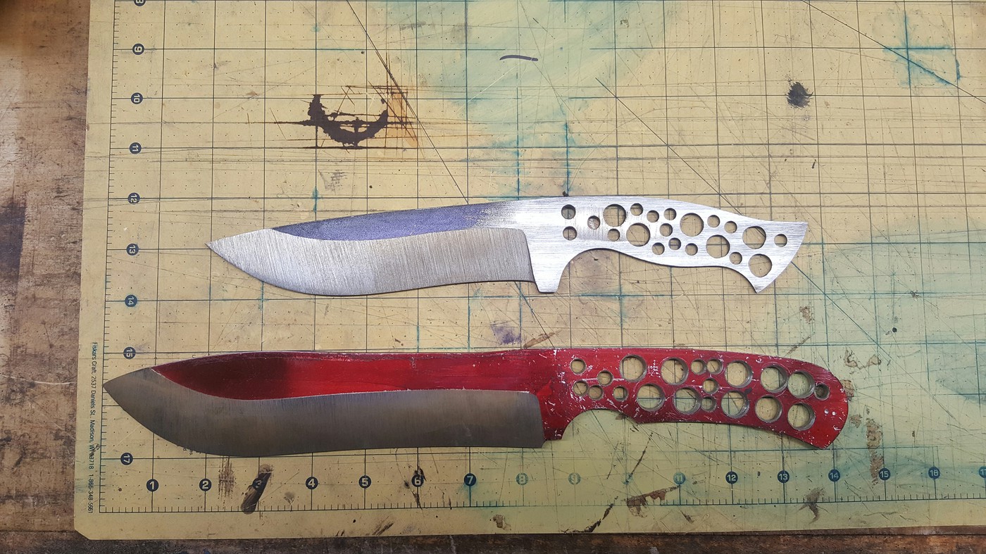

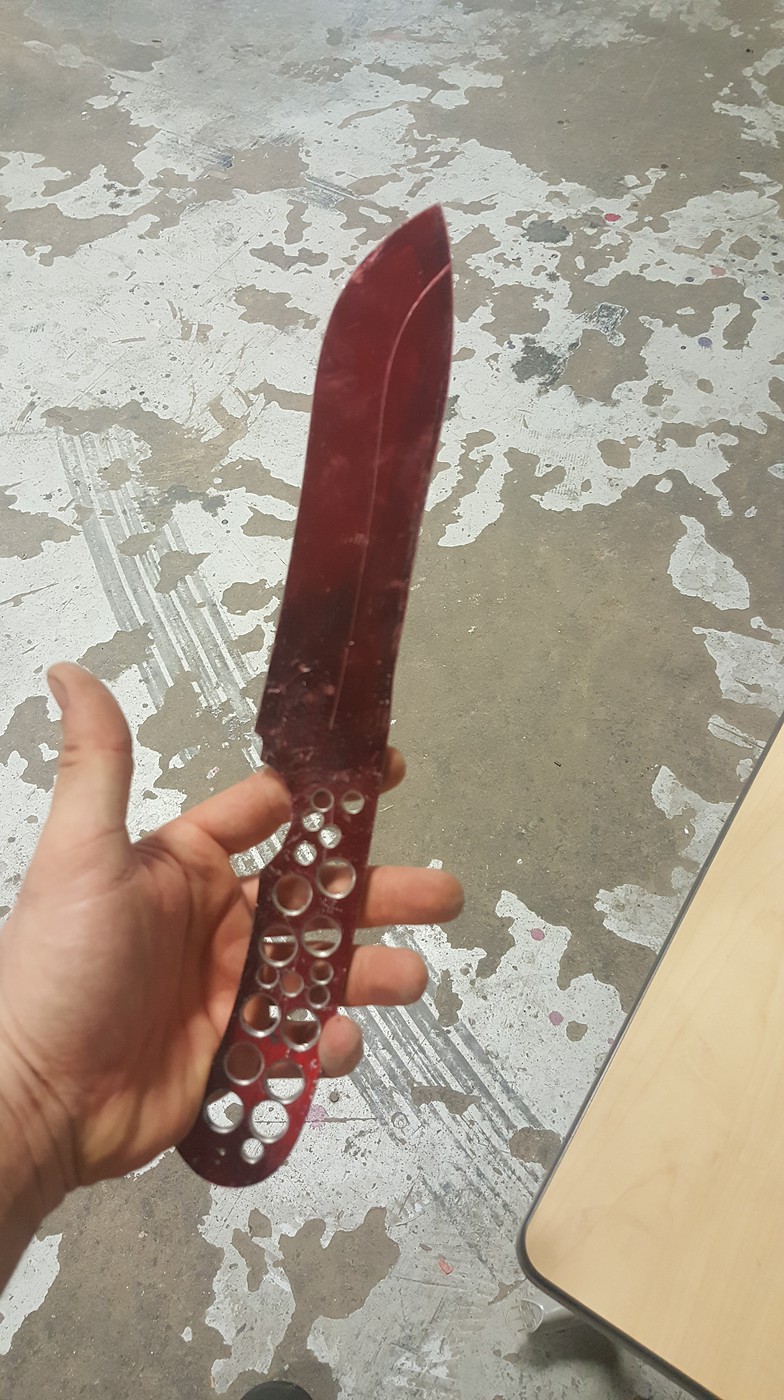

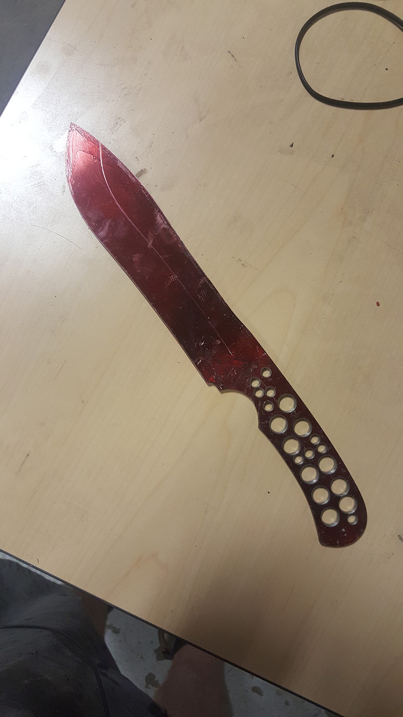

Last but not least. All work and no play makes Jack a dull boy! Sometimes I get an itch, I took a bar of steel I had laying around and drew a rough design on it. I then profile it out. It gives me the freedom to make ajdustments as I go. I dont feel like I need to stay whithin a scribed line. Later on, when I establish a design and I want to repeat it I will scribe it out and obey the lines. I prefer to design this way because personally, I have a hard time drawing a design on paper as it never looks right to me.
Below is the product of that today. I havent decided if it will be a one off or a prototype. But I am happy with it and plan on completing it. Tomorrow, I will taper the tang along with the rest of the batch I worked on today.
My inspiration for this one was a BOLO type blade.
Hosted on Fotki
Hosted on Fotki
Comparison photo with the Recon, the largest blade I currently make.
Hosted on Fotki
Thanks for looking. Questions and comments are welcome.
