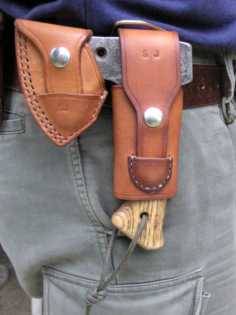

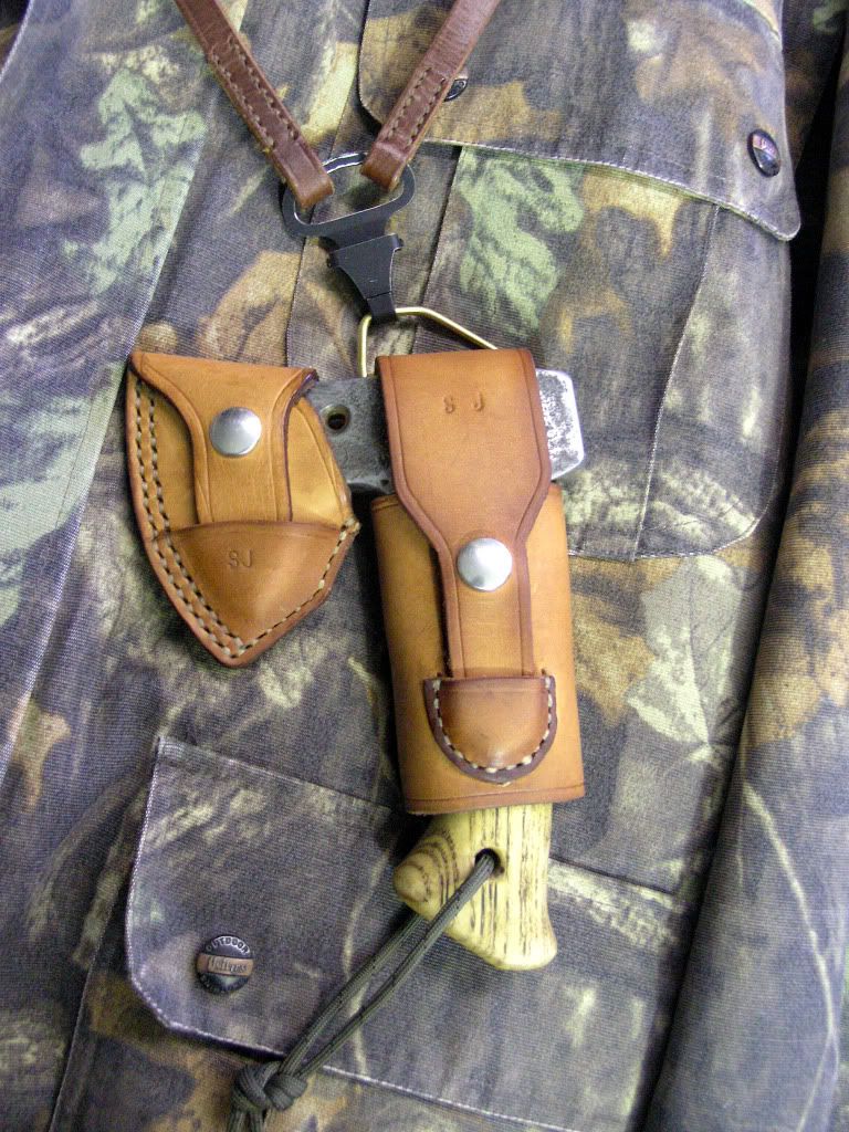

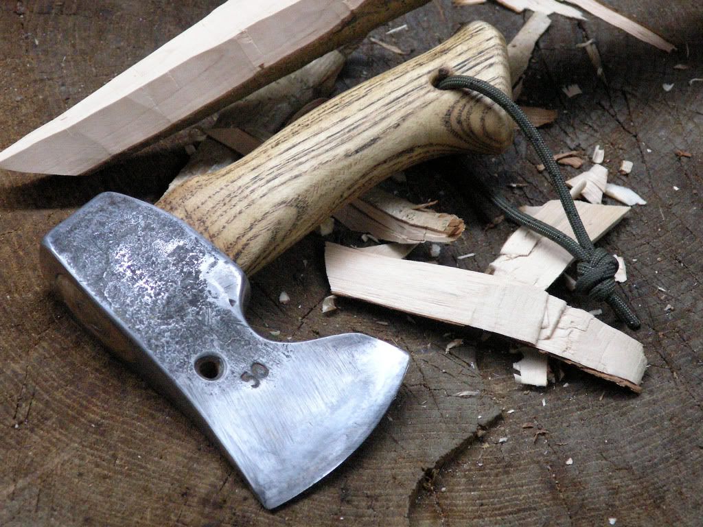

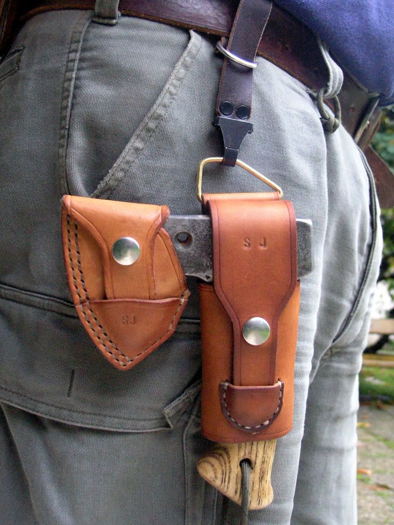

Thats why I desided to make very little pocket sized hatchet, but still big enough to be functional. I reshaped little 0,5 kilo hatchet head, make a little handle and lether sheath (secured to unintentional opening when in pocket) with different carrying options. I think I succeed. Of course I prefer a bigger axe for cutting trees, but as a little usable tool and as a device for preservation of my mental health (you know, not feeling half naked ) is extraordinary!
weight: 0,5 kg
length: 17 cm
cutting edge: 7,5 cm
handle: ash
