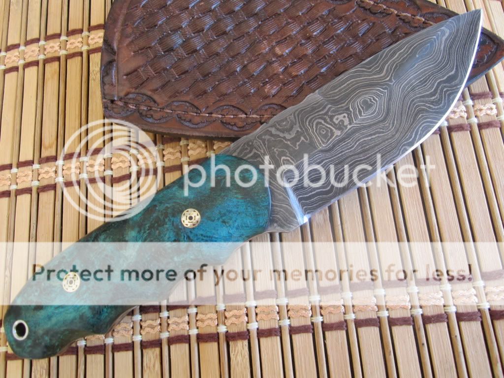

yes, as far as I know you always need to etch damascus, without etching you can just barely see the pattern if you turn it in the light. I etch in 4:1 water to ferric chloride
Steel we grind from billets need to be etched.If you buy finished blades from Brad,they dont.
I've used em several times. The blade blanks do not need to be etched. However they are ground to say only 320 or 400 grit it seems. My customers seem to have liked that as it gives the blade with their random damascus a very "organic" look. If you were wanting it to be more refined I would suggest hand sanding to a finer grit and then re etching. The heat treat is good and these blades will cut. Some damascus you can buff lightly this you can not. Knowing this I once buffed one of there blades intentionally for a customer that was looking for a more subtle damascus look. He was very pleased. Except for sharpening normally pretty much just leave the blade alone. ALSO they are great people to deal with! For your application you'll have a tough time coming up with a better blank.

Yep it can be a user. Alabama damascus is heat treated (by them) in the 58 RC range. It'll cut just fine for ya. Oil it occasionally as they are high carbon steels and will rustif not properly taken care of.
