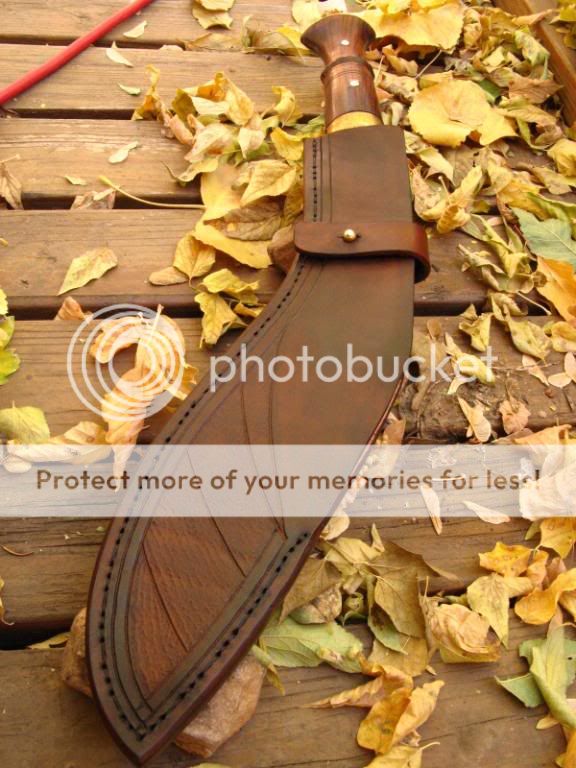

My third khuk just arrove today. I'd post a pic, but just look at the 11/20 DOTD at the M43. This thing is a mammoth. The only thing more glorious than this is the fact that my girlfriend things my newfound khuk habit cool.
