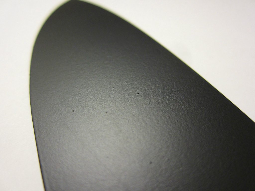

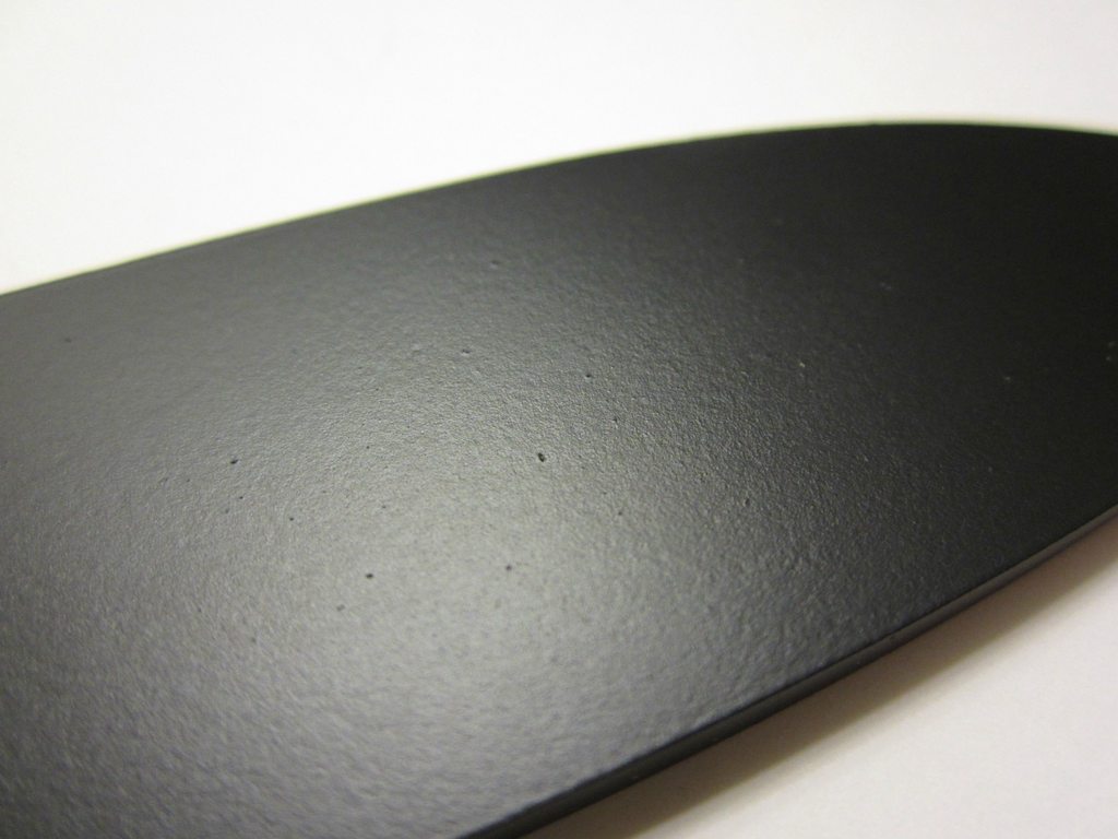

Ok, so yesterday I spent the day re-building the compressed air system at the shop. New pipes and hoses, new manifold and couplers, new regulator and 2 new filters. Everything was replaced except the compressor itself.
Also got an inline drier/filter which is setup to attach straight to my HVLP gun:
I then prepped the blades and applied a new batch of the coating. Here was the process:
  • Degrease blades in ethanol
  • Blast blades with 80-90 grit sand at 115PSI
  • Blow any excess grit off blades with compressed air
  • Brush down blades with clean (new) paintbrush to make sure all grit is gone
  • Gas-off blades at 300ºF for 60 minutes
  • Mix Cerakote (27ml of graphite black, with 1.5ml of hardener), thoroughly mix, strain through fine automotive paint strainer.
  • Spray light coats onto blades while they're still warm. Coats were lightly sprayed from 3-4" away from the parts.
  • Bake at 250ºF for 2 hours.
Unfortunately even with the extra prep steps the coating still has defects. Below are some pictures of the defects. The spots feel rough and scratchy when you run your fingers over them, like little pieces of sand or something. Very few of these defects could be seen on the blades before they were baked. The coating seemed to go on a little thicker than usual this time, normally there is a bit less texture to it.
This batch has been ready to go for over 2 weeks except for this coating issue. It's starting to be a real pain.
