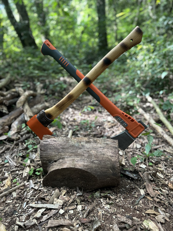

Thanks for your interest. I made the head out of a 10inch table saw blade. It is mounted into a hickory saddle axe handle. When trying to figure out “how” to mount it and retain symmetry, this is what I came up with. I drilled a hole through the handle the same size as the opening in the blade. The main wedge is a chunk of hickory hand cut into a round disk that is slightly tapered (the side with the cut) and cut half way through so a wedge could be driven into it so it would expand and lock the disk and head into place. I then seated the head, drove the disc in, hammered the wedge, ensured it was snug, and filed and sanded it all to fit. I gave it to an old friend, as he and I used that blade in a saw that we did some pretty memorable work with. I don’t really have any other pics of it. But, it won’t be the last one I make. I made this, a tomahawk, and a knife out of the one single blade.I would like to know more and see more of this.
