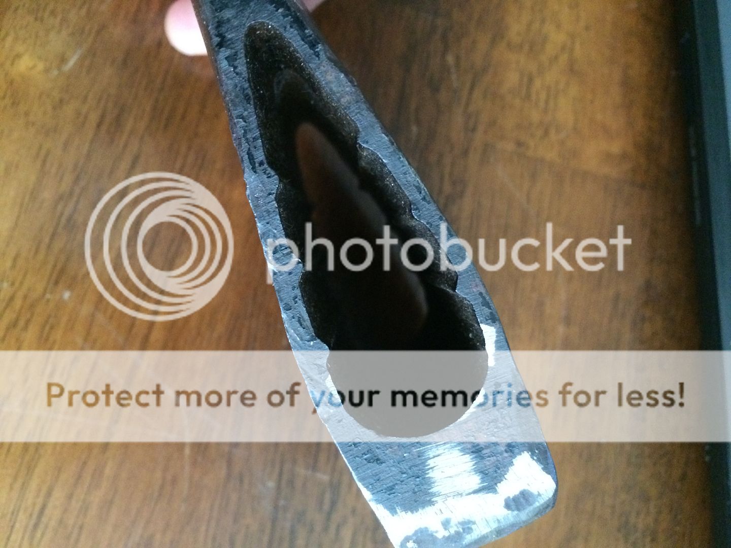

I recently rehung a no name Cruiser on a 28'' House Handle. Today I remembered something about eye ridges an found this thread so I'm guessing that its a True Temper Kelly Woodslasher. Please correct me if I'm mistaken.
I first posted these in the rehanging thread, as that is a project I plan to tackle this weekend. I don't know much about axes, so I did not realize the ridges were a defining characteristic.
Adding them here for posterity. The ax is most likely a woodslasher from some other folks opinions. Based on who owned it before me, I am guessing it was purchased anywhere from 1950-1980.
