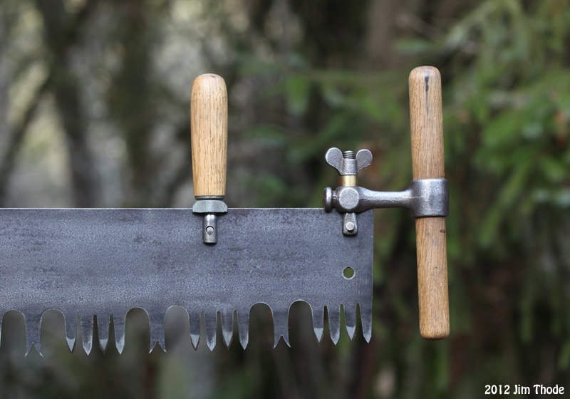

....My heavy supplementary handle was made out of a 5/8" bolt which I kerfed by putting 2 hacksaw blades side-by-side on a single frame. A cut off 20 penny nail made the pin. A large square nut locks it on the saw. A turned wood sleeve is glued over the top of the bolt. I posted a picture of it earlier in this thread.

Yes, the large square nut tightens the handle on the saw. You can do pretty well with just hand tight but you have to keep an eye on it. Wrench tight is better. Note the washer under the bolt so that the saw doesn't cut into it.
The hacksaw thing is something I discovered on accident once when I installed 2 blades that were stuck together. I made a mental note that 2 blades would fit on a hacksaw pin and have used the technique a few times prior to this.

Depending on your bolt size, you can cut the threads off a log-shanked Grade 8 machine bolt, either 3/16 or 1/4 and use it as a pin. Much less likely to deform. I usually make these about a dozen at a time, as it's much easier to run multiples once you have your tooling and depth stops set up.
Self-aligning center punch
Drill your hole
Hacksaw the sides from a square nut and chisel out a slot that lines up with your bolt hole
Run the bolt into the nut to make sure of the fit and backfill the nut slot with JB weld Quikwood epoxy putty, let cure, sand and finish.
Use a thick washer as wide as your handle and round the bottom edge of the handle to prevent splintering. Works best with hickory.

Lately I've been using the drilled/threaded/slotted 3/8" bolts from the Ebay seller below. He will give you a discount if you order a batch. I used to use the big 1/2" bolts from Flicker Forge, but they were pricey and the size was overkill for an aux handle. I get my 3/16" grade 8 pin bolts from Air Parts: http://www.airpartsinc.com/1191_AN3_BOLTS_3-16_(10-32)_DRILLED.htm
Cool, I did not know they sold those handle bolts. A less expensive, more readily available, better griping head and just as hard pin would be a #10 -24 Socket Head Cap Screw that was long enough to cut off the threads. Probably could find them at a local hardware store and they have to be hard (grade 8) or the allen wrench will not hold.

Using Trailtime's example - A new supplemental handle. The only hickory I had around was an old Model T Ford wheel spoke (about 1925 model year car). I used a cross dowel barrel nut in the handle with one side exposed and contoured to the shape of the handle.
The parts:
The competed parts:
Done with more handle parts in the background:
