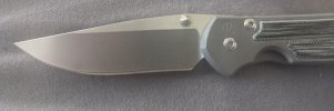

Received a new small 21 from a crk dealer and it looks a little odd to me. This is my first 21 so curious if this is normal. The blade looks like it's been overly sharpened, and when laying on a flat surface I can see a substantial amount of light where the blade looks like it should be flat.
I checked the back of the blade for lockup marks, and there seems to be a lot of machining marks there. I own a small inkosi and was impressed by the fact that I couldn't see a machining marks anywhere on the knife.
When opening the blade it perceptibly click into place right before the lock engages. This is my first post, but I have followed other threads on blade forums in the long lead up to my crk purchases, so I figured this would be the place to ask.

Your photos didn't load so hard to tell exactly what you are describing, but the double click sound is normal. As the blade opens, the lock bar slides off the detent ball, that's the first click. Then it snaps into place behind the tang to lock the blade, that's the second click.
Thanks for the heads up, new to blade forum so I'm trying to figure out my image situation. That's good to know about the double click though, thanks!

Alright so I bumped my membership. This is I'm the markings on the Tang, and the recurve. The photos are oddly shaped because I cropped them to make them small enough to share (took the lazy way)IMG_20200730_074836.jpg IMG_20200729_184957.jpg IMG_20200729_195523.jpg
That is a little hard to tell, but it does look thinner! Oh man that mammoth bark! I've seen them on the webs I'm jealous. Yeah I'm starting to feel that too I don't want to return, I guess I was just curious if it was super abnormal or not.

The little bit of recurve in the blade doesn’t bother me, but the markings on the blade where lock up occurs bothers me. That has the potential to cause unnecessary wear and less life on the lock up position IMO.
You have a couple of choices, either send it back to the dealer for a swap out or call CRK and send it in for service.
To answer your question, no it’s not normal.
Canspellnife Canspellnife
In all honesty, if it was me, I would contact the dealer for an exchange or return.
I *may* not have noticed the edge, but that tang doesn’t look right.
MANY of the sebenzas that I have bought in recent years have had absolutely horrible edge grinds. Recurves, High on one side, low on another, grossly ground at the belly and thin elsewhere, etc. The standard has indeed fallen. This is the final finishing touch and they are extremely lacking. Maybe I am being picky, but for a knife costing $500+, I deserve to be. I expect this on a Walmart special, not from a company that is regarded by many as “the standard”. Obviously the standard has fallen like I stated above. It’s quite sickening. Some were returned to dealers as unacceptable. Others were sold clearly stating uneven edge grinds.
Hey welcome to the forums! I just checked my Classic and my 21s and none of them have this recurve (nor the extremely pronounced machine marks). It's totally your call obviously, but if I were in your position I would either want the dealer to take it back or for Chris Reeve to replace the blade outright.
If you can send it back, that would be my vote. The tang looks weird, recurve is not cool, and both these things bother you. Not acceptable. CRK will make it right if you send it in, but try and exchange it through the dealer first.
