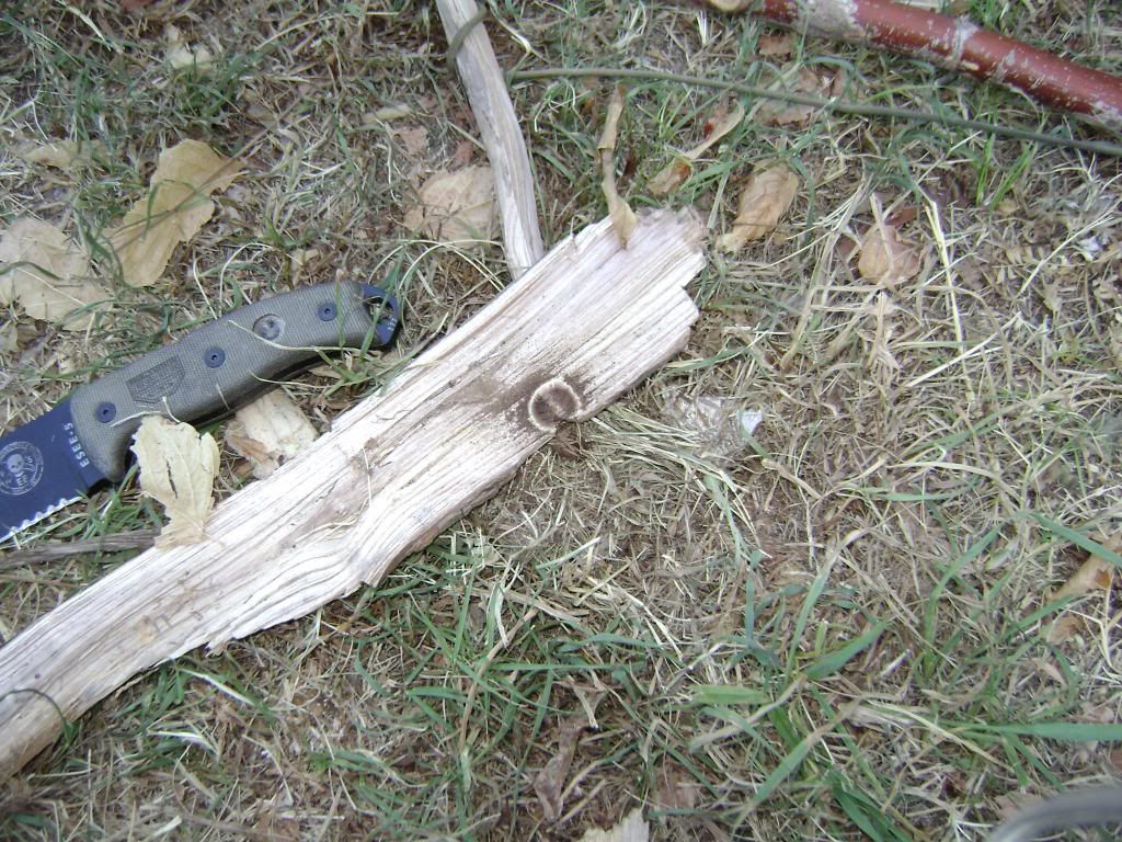

one of the first bits of "work" i put to the 5 was chopping some wood
this limb is from a peach tree
some hardass wood there
the 5 has the weight to chop well
tho i found it feeling a tad "short" for the job
to be honest, in my experience
the esee 6 was the better chopper
most likely just that longer blade made it "feel" easier

as you can see after chopping, batoning(these both seem so cliché.
but in a survival situation, which this knife was designed for,
that would be just a cupla the uses it would see)
the esee5 sliced this tomato as thin as bout any knife i own

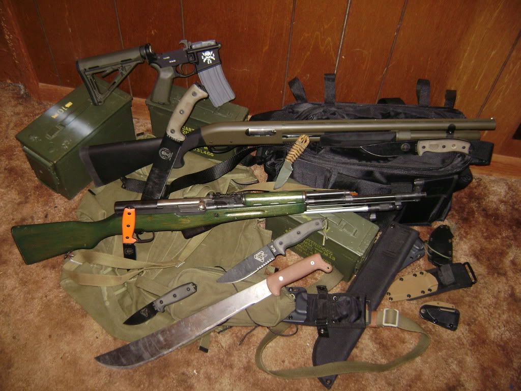

Quick lineup of the RC/ESEE-4, 5 and 6 (bottom to top)
As you can see here, with the pommels lined up, the 5 and 6 are pretty close in length.

Here's the standard “spine shot” of the 4, 5 and 6 (left to right)
The 4 in hand. Note that my fingers completely touch my palm. What I would consider a “smaller” grip. Still comfortable and great for smaller hands.
The 5 in hand. Little bit meater as you can see, but comfortable to me.
The 6 in hand. Slightly smaller than the 5 due to the thinner blade, but I wouldn't say that it is more comfortable than the 5 in the hand.

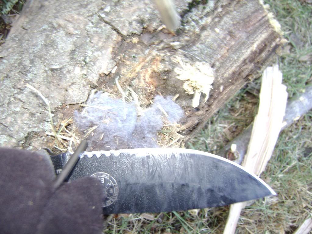

Next I dragged off some fat wood shavings. The serrations worked well for this too. (I had already begun to rethink my serration prejudice.)
P15
I found that even using the serrations I could not get a spark to start in the fatwood without a LOT of trying. Self critiquing I should have had many more shavings but to those who haven’t actually tried this with their favorite carbon survival knife….do so!! My findings were definitely contrary to my thoughts. I thought these serrations would shower sparks over everything. An uncoated square spine of a Mora seems much easier to throw sparks with than the serrations were on the 5 for me. A simple piece of hacksaw blade throws off lots of sparks and will start fatwood in 1 or 2 strikes. I was able to get a piece of char cloth to glow with 2 strikes on the ferro rod with the 5 on the serrations. You can just barely see it smoking and glowing.
P16
(FYI the ferro rods work much better with handles on them too!)

I read somewhere that catalpa makes for a good bowdrill setup... just happen to have some dried catalpa in my wood pile. This limb is about 3” thick and fairly tough.
After chopping a bit over halfway through, I switched to my RC-6s. The ESEE-5 was the better chopper. It seemed to knock chunks out every time I hit the limb! I had to stop chopping for a while, and go find some gloves. My hands haven't been working much this last 5 weeks, and they're getting tender. Got myself a couple blisters on my left hand from all this chopping.
Eventually, I stomped the limb in half, and then worked on splitting off a hearthboard and spindle.
Wow! The bowdrill divot works! There's nearly zero friction, and the spine of the blade rests on your shin or thigh, depending on how you sit. It stabilizes your hand and the spindle, so you can focus more on getting the bow moving. Lots of smoke. Much more than the one other time i've tried using a bow drill. I didn't spend enough time building a tinder bundle, and in my excitement, kept breaking the ember up.
After 30 minutes or so, I decided to try out a firesteel. Dryer lint and grass, and 3 one-handed attempts, and I had Fire!
The Izula steels from KSF are about the perfect size for ESEE serrations. I went ahead and threw a spare in the box.

We'll start with glamor/comparison shots, including one of the balance point.
The blade is definitely thick, but not too thick to be comfortable in hand.
Size falls right between my TAK & my RC6.
First impression picking up the ESEE5 was its mass, but with the balance point in hand, it did not feel too heavy or unwieldy. I spent 2 days with the knife hanging off my belt and kept forgetting it was there.
Also, either my hands are that much bigger than the other reviewers or I hold knives different, but I had no problems with hot spots or blisters.
