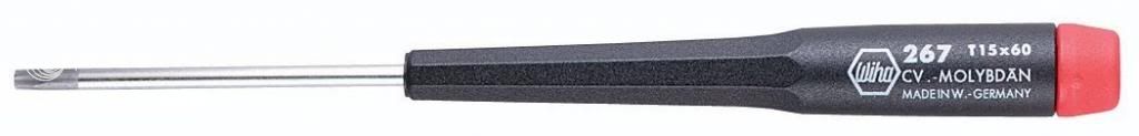

- Most people blame the screws, but this is not usually the case. The cheap multiple-bit torx tools from the hardware store are usually the problem. They are imprecise and are often under or oversized, and they are soft and deform. This leads to stripping.
3. THE SOLUTION
- Many of our customers have never known the joy of using good, high-quality, torx tools. Quality torx drivers by Wiha will help you avoid stripping screws in the future(there are other brands as well, but I can't remember them at the moment). We use Wiha brand torx drivers in the factory - they are precise and the tips are hardened. It makes a big difference. They cost $5 apiece on Amazon and will last just about forever for the average knife collector.

5. WHERE CAN I FIND THESE GLORIOUS TOOLS? - Here are some links to these tools on Amazon - they're about $5 each. They can be had with big or small handles, but you really don't need the big ones for working on knives. The little ones help keep hamfisted goons like myself out of trouble:
T6:
http://www.amazon.com/Wiha-26706-Screwdriver-Precision-Handle/dp/B00018AO34/ref=sr_1_2?s=hi&ie=UTF8&qid=1363456753&sr=1-2&keywords=wiha+torx+t6
T8:
http://www.amazon.com/Wiha-26708-Screwdriver-Precision-Handle/dp/B000O5IMCE/ref=sr_1_4?s=hi&ie=UTF8&qid=1363456806&sr=1-4&keywords=wiha+torx+t8
T-10:
http://www.amazon.com/Wiha-36274-Screwdriver-SoftFinish-Handle/dp/B00018APN8/ref=sr_1_10?ie=UTF8&qid=1363456619&sr=8-10&keywords=wiha+torx+t10
Look upon their majesty!!

The main reason screws strip is because the tool doesn't fit the screw head properly or it is too soft for the amount of torque applied. So using a torx tool in a hex screw or a hex tool in a torx screw is asking for trouble. While it can work there is risk. Use the proper tool.
Very informative. I never really thought of the cheap Torx drivers damaging the heads on the screws themselves (always just figured it was the other way around). I've been using one of the GorillaGrips plus a cheap-o electronics store set. A couple on the cheap-o set are pretty worn. Looks like I'll have to pick up a few of the Wiha Torx drivers.
I've got a lifetime warrantied set from Ace Hardware. Every time they start wearing out, I just trade them in for a new set. I am going to have to look into those Wihas though... unless Kershaw decides make a set. I'd buy them even if they weren't orange. ;)
I have a precision screwdriver set from wm with torx bits that's working great. Always make sure that bit is all the way in the screw, and don't let it slip out while turning it. A little pressure make a big difference when it comes to stripping screws!
I fully agree that Its very useful to use a precise Torx bit for your knives. Finding the right size bit is paramount and you should NEVER settle for bargain bin tools. Honestly it simply doesnt make sense to use bargain basement tools on expensive tools. But I think one thing needs mentioning. If you use the Wiha bits 1. Make sure you use the correct size. 2. Make sure your screw heads are in good enough condition to handle the tool. You see torx bits apply alot of torque (hence the name) on the screw head. And if your screw has all ready been damaged by an inferior tool the hardened tips of the Wiha bits may just mangle the head of your screw. I definitely recommend Wiha tools. But only if you know what your doing. For the beginner I usually recommend the Husky all in one torx driver. The reason is that the head are precise but they are not harder than most bolts found on a ZT. And if anyone has tried to remove a problematic screw with a Wiha might also be able to tell you that it definitely will teach that screw a lesson. So much that you WILL be calling kershaw for replacements. But in the end, in many cases I sometimes would rather strip a $5 tool than strip a not always easy to get screw. Plus removing a stripped screw from a knife is a PITA I hope most on this forum will never need to endure.
Edited to add: also if you do end up stripping a tool like the husky on a knife consider replacing the screw anways. Even though the tool is softer than the screw you still may have damaged in gripping points of that screw and this can damage tools down the road.
