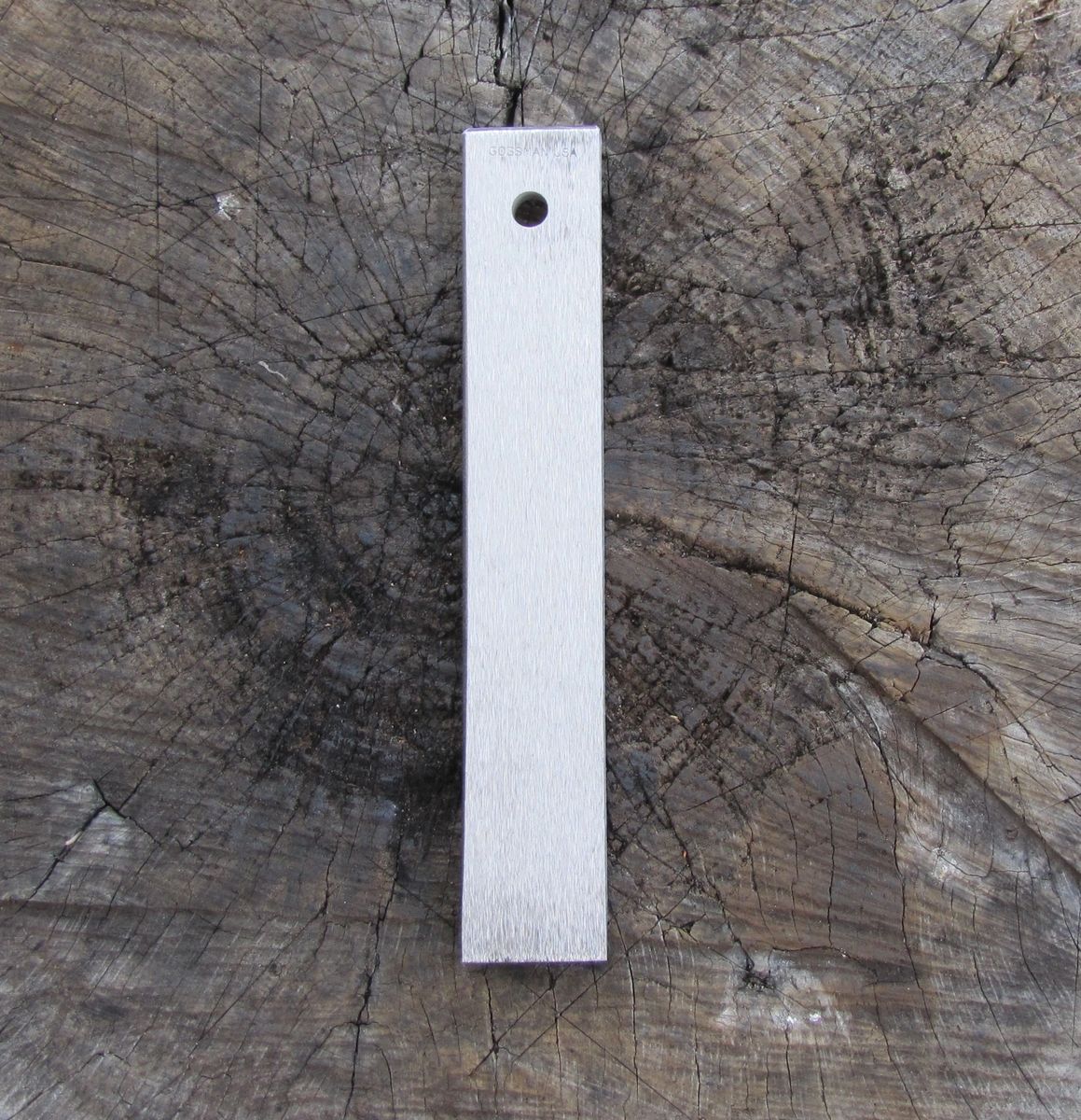

I have a Gossman Survival tool that handles multiple tasks including sharpening. Handy chunk of D2 steel.
