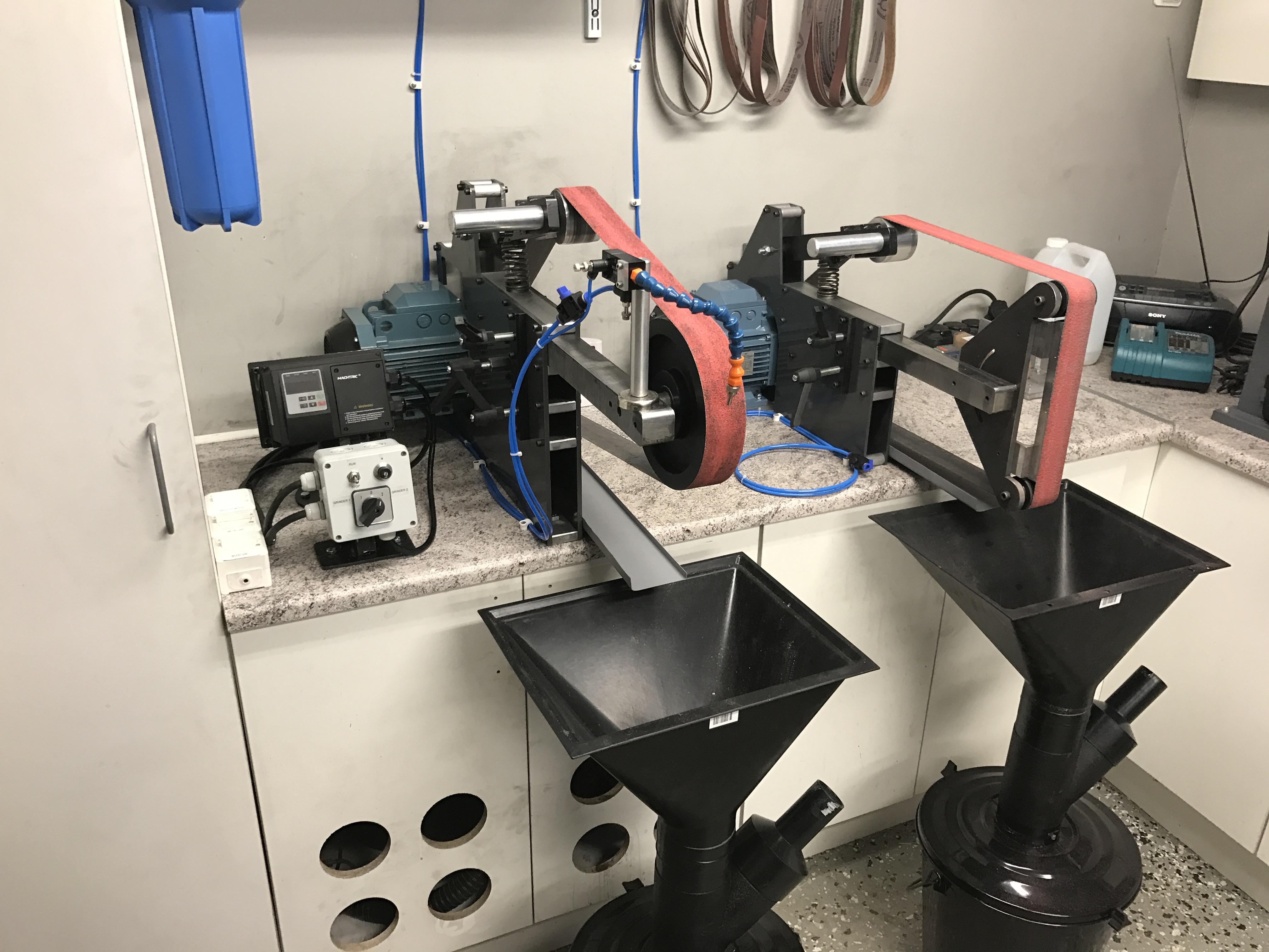

Hi guys!
I'm curious. How long does it take you to grind for example a standard sized drop point hunter in a non-extreme steel type.
I understand that type of steel, size, thickness etc comes to play. I'm just trying to get a feeling if I'm doing something completely suboptimal.
For example, when I grind a 4 inch FFG hunter in 3mm Niolox, with a fresh 36 grit Cubitron 984 - it takes forever.
Yes, I grind everything post heat treat (I get better plate quench that way). But still, one blade takes me around 3-5 hours and a couple of belts. And I'm even pushing it pretty hard since I'm running my grinders wet.
And the 3-5 hours doesn't include finishing belts either. :(
I'm thinking about oil quenching my thicker (non kitchen type) Niolox blades instead, and pre HT grind them.
Feel free to give me your thoughts on the matter!

What type of grinder do you have?
the first sentence says grinding a drop point hunter, which has a tapered tang. i was not sure if that and profiling was included in your time. it did not mention bevels only. 36 grit just doing bevels maybe 15 minutes for me.
It's a pretty standard type of grinder. Nothing spectacular, but they're very robust. It's all steel, with solid steel tool arms. They're fitted with VFD and 3 hp motors.

Hmm, I went out to the workshop doing for more hard labor. I managed to take the blade up to a A100 trizact finish (about 180-220 grit) and tried some hand sanding (haven't done that before with the Niolox).
Goddammit! It obvious that I during the heat treat managed to convert my Niolox to Adamantium.
The 240 grit Rhynowet Redline just slides over the blade without scratching it. No matter how hard I press, there is hardly a scratch.
I've solely used O1 until now, which hand sands very nicely. And I really enjoy the process, but this is just frustrating. Haha! I should add that my O1 blades are in 62-63 HRC range and my Niolox is in 60-61 HRC range.
And thank you all for sharing your thoughts on this. My lessons learnt so far:
1. Step my grind line up gradually when grinding and avoid a large flat spot.
2. Try the method with a push stick on workrest.
3. Stay the hell away from abrasive resistant (immune?) steels.
I'm very happy with O1 as my primary high carbon steel, but I'm looking for a stainless steel for my kitchen knives. I thought Niolox would be a good option, but with these results (image the belt cost in the long run!) I think I'll do some testing with other stainless steels.
